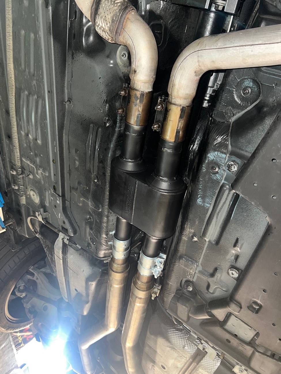

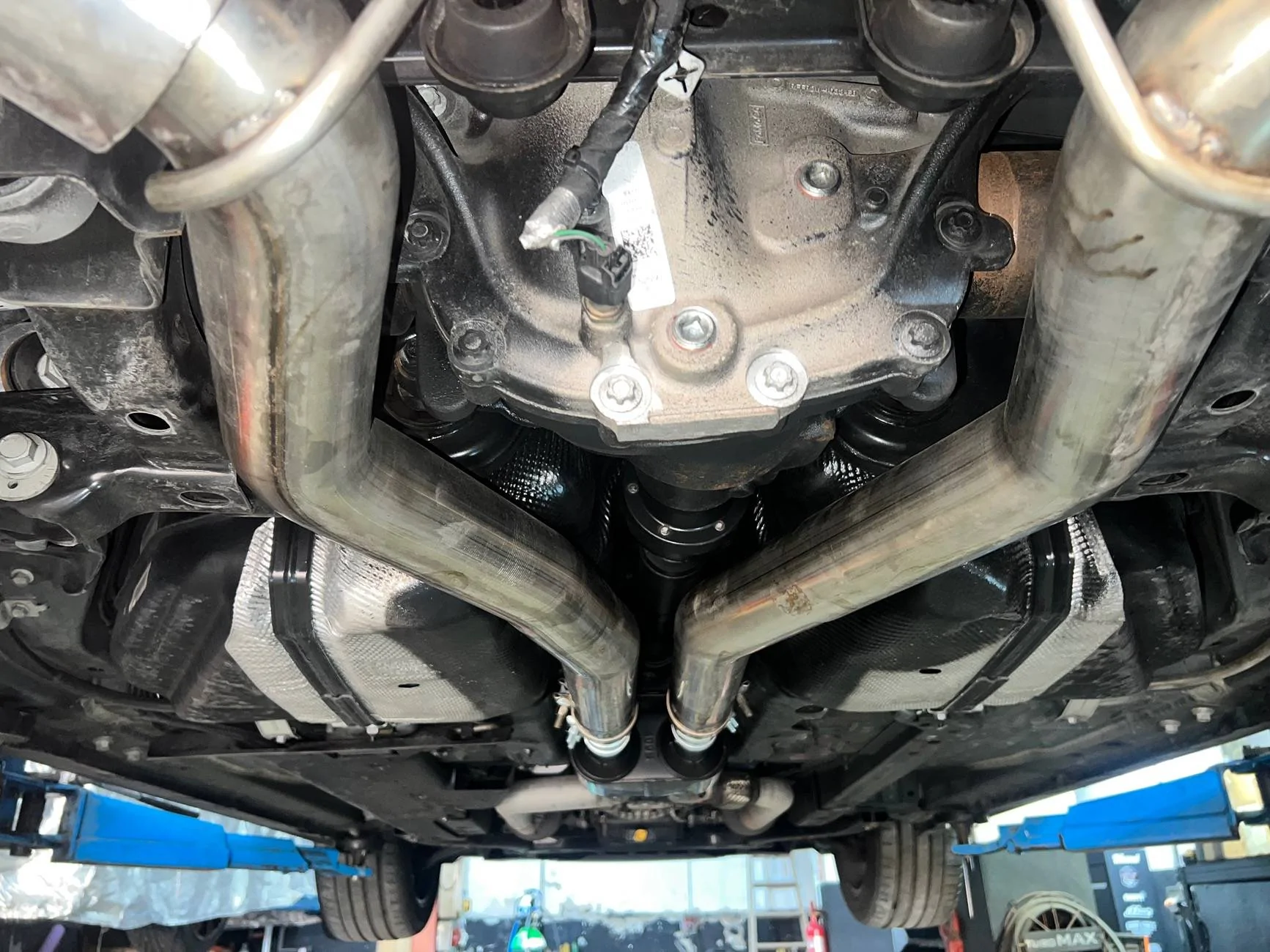

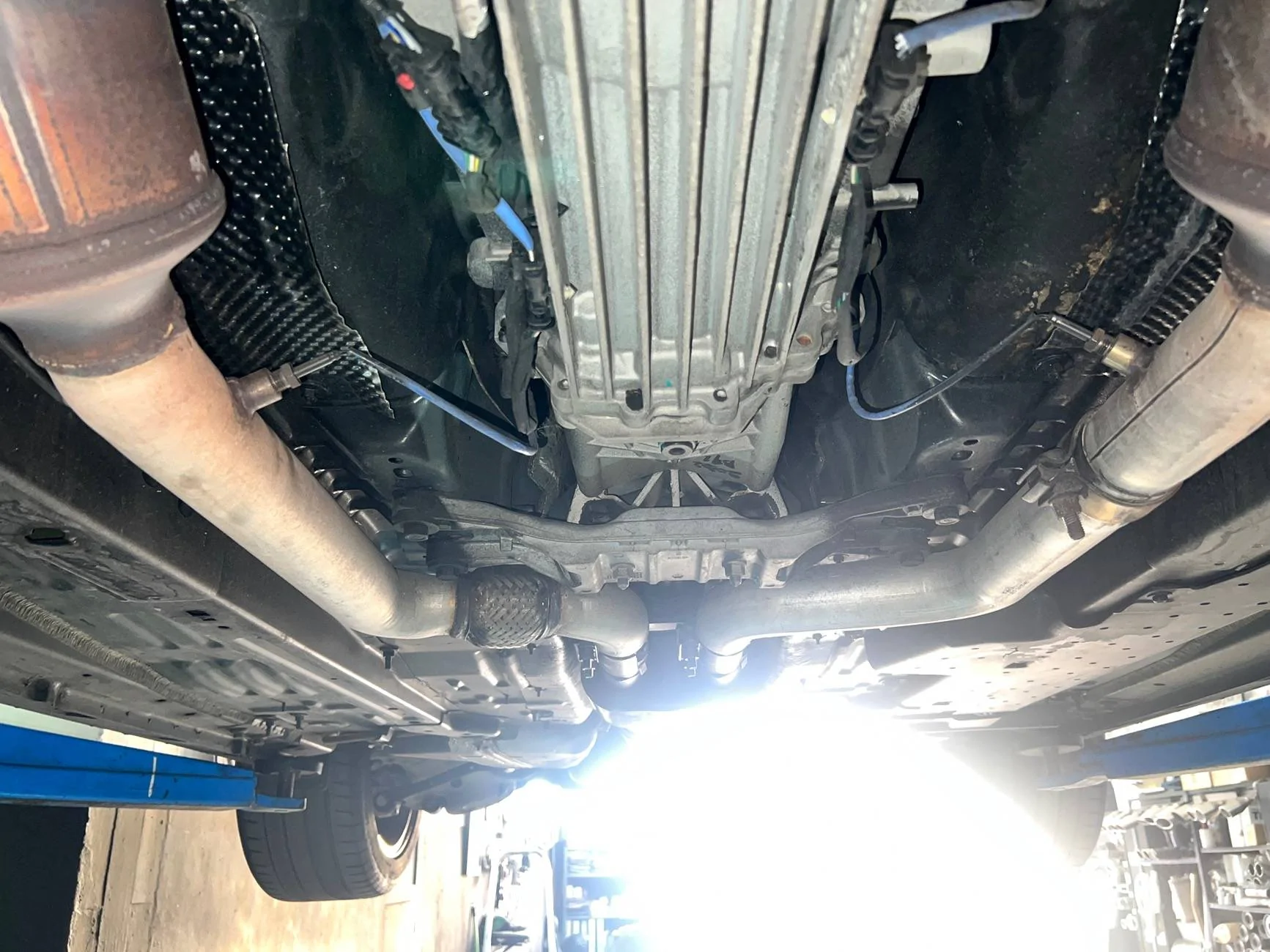

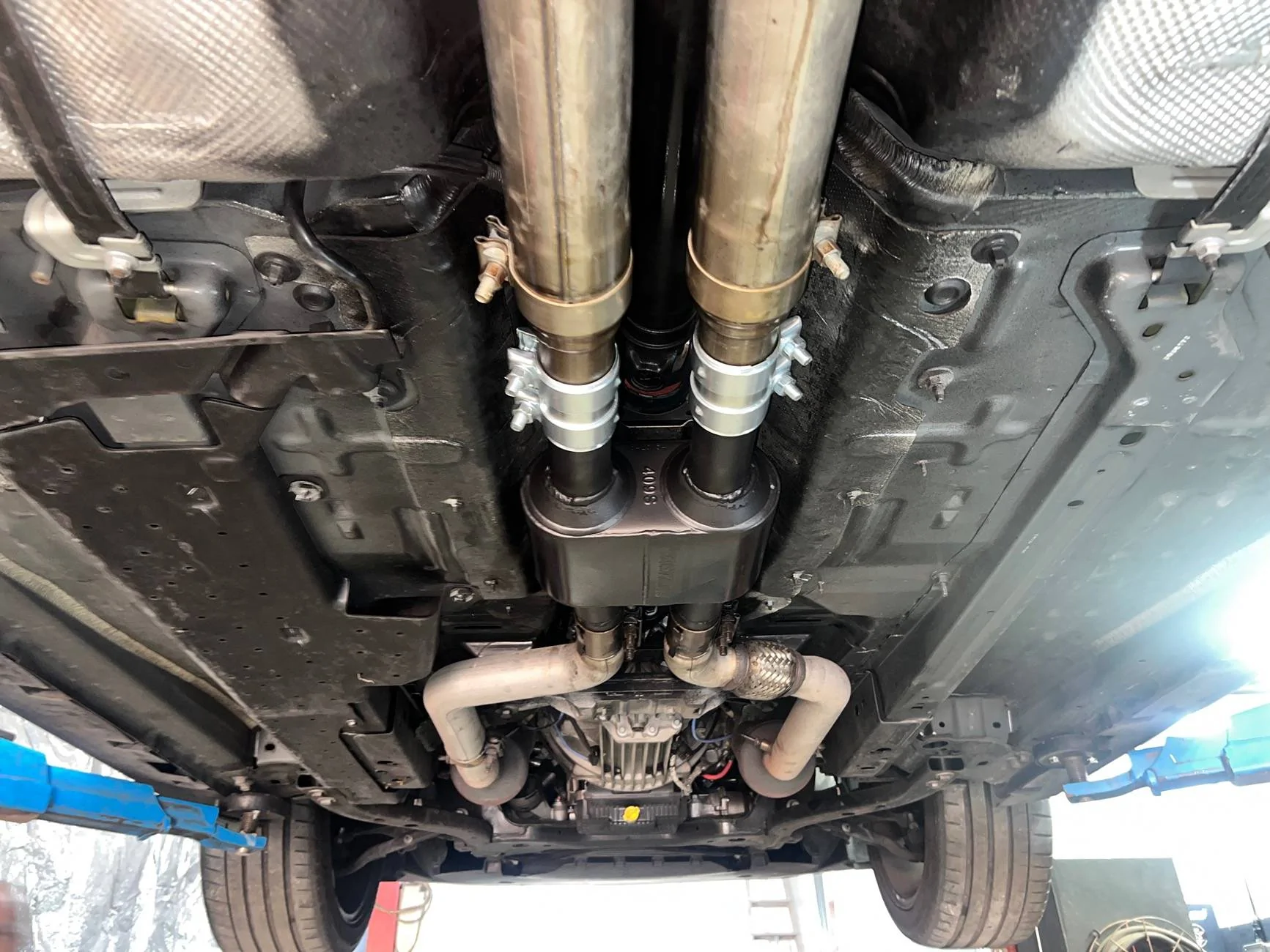

Here’s some photos of the install for space and clearance.

If it sounds right to your ears, then you’ve done well. Looking forward to hearing those sound clips.
