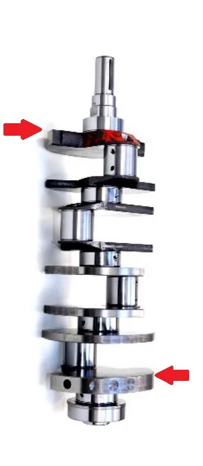

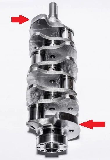

The performance comes from the breathing, it still has a sizable counter weight and again, not worthy of doing unless to market an engineering exercise. Which was extremely successful. Remember this engine was hyped for a few years before release in the media. People wanted it just because. Ask any engine builder in any form of racing, the performance gain is negligible.
The Voodoo has no counterweights on the crankshaft.

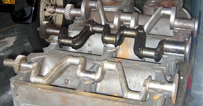

This happens in the Voodoo just the same. Each bank of the Voodoo has, believe it or not, a similar stroke pattern and firing order as the Model T. Afterall, the Voodoo is two I4 engines connected 90 degrees apart.
Nothing is free.
I am trying to think why Ford never used this in their marketing! LOL!

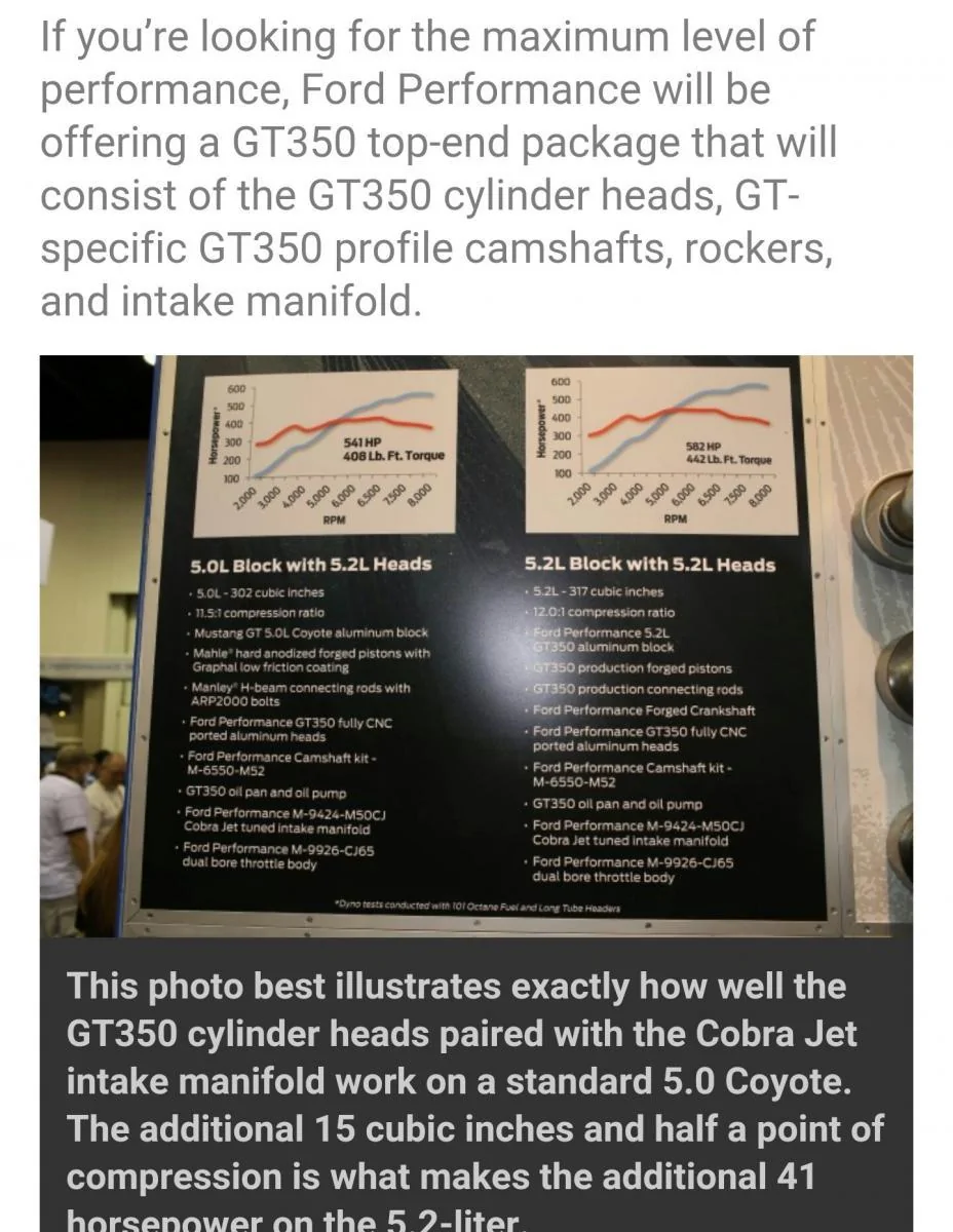

The only reason why the 5.2 voodoo revs like it does is because of many things.
1) lighter crank and rotating mass.
2) higher flowing heads and cams
A crossplane 5.0 or 5.2 can easily rev to 8250+ rpm.
Since you can't change the crank will head work alone(or GT 350 head upgrade) get you to 8200 + or is a cam upgrade also needed ?
If cams are needed would you use the GT 350 spec cams on a blower car or blower specific cams ?
Heads and cams would be best revving to over 8000. If I remember correctly you need new cams with the GT350 heads to work correctly on the coyote.
You can buy a 5.2 CPC and all the other bits to have between 540-580 at the crank.

No,you don't have to use the GT 350 spec cams with the GT 350 heads.
You can use stock GT cams(what I have in my hellion/KB cars with GT 350 heads) or aftermarket cams as long as you use the modified rocker arms (sold by MMR).
If you choose the GT 350 spec cams then you have to use the OEM GT 350 rocker arms .
