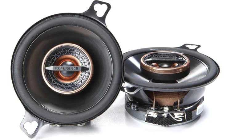

I did this upgrade myself using Infinity Reference REF-3032CFX co-axials.
Also disconnected the A pillar tweeters and center channel speaker. The difference was highly noticeable in a good way.
The only thing I needed to do was turn down the mid and high frequencies on the factory EQ as there was just a tad too much "zing" for my liking. Mid is now set at -2 and High is set at -2.

I was going to get these Infinity speakers but shipping was over two weeks, and Crutchfield had the Hertz 48 hours from my door. Both the Infinity and Hertz had the highest sensitivity rating which was good for the stock system. Appreciate the advice on turning down the mid/treble.
