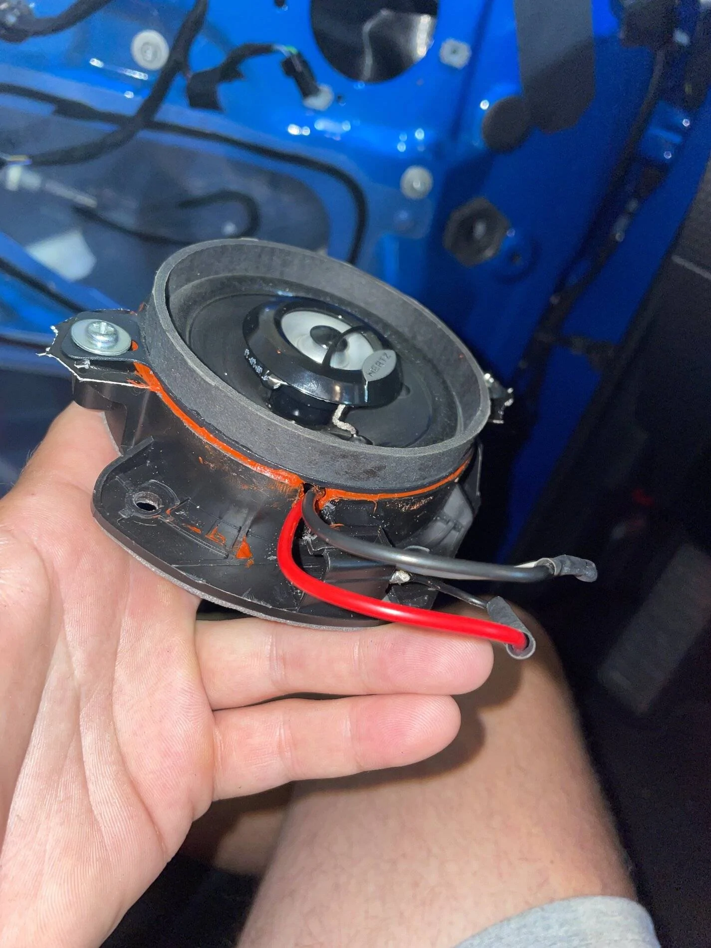

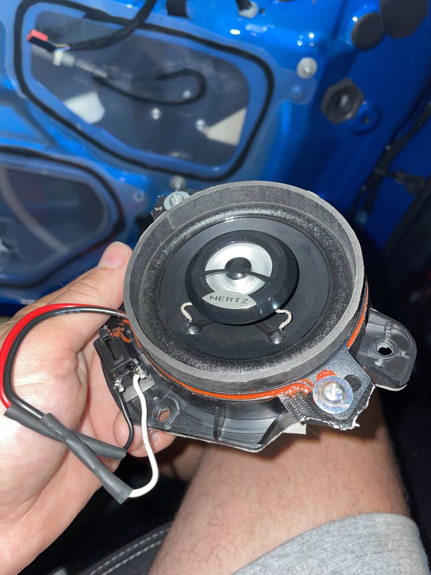

I was tracking on a recent post where an OP disconnected tweets, center speaker and installed Infinity REF3032 for the mids.
Instead of the Infinity speakers I purchased Hertz DCX87.3, 4 ohm, 92 dB, 30W RMS.
I recognize the system is 8 ohm, but after hooking it up (noting polarity) I have absolutely NO sound coming from the new mids. I hear a slight "pop" when they are plugged in (when the car is off?)
What went wrong here? Any help is appreciated.

Did you disconnect the battery before you did the speaker change?
If you didn't, you may have put the amp into a protection mode. Disconnect the battery and re-connect after a few minutes to reset it. Or pull the brown plug at the amp above the drivers kick panel or the fuse at the passenger kick panel.
Also:
Check your connections?
Check for any shorts?
Did you make sure the speaker terminals are not touching the sheet metal?
It could be any number of things.

Friends. I feel really silly and first wanted to just delete this post.
But for the benefits of others.
when I bolted in the bracket the back speaker connections were shorting out on the door and the speaker shut Down! Bending the terminals away solved it.
AND HOLY CRAP THE DIFFERENCE! I am blown away. Thanks for the quick responses all.

I looked at the side profile of that speaker and right away I thought there's a possibility the terminals were touching the metal. I once considered those speakers and did the measurements.
Glad you figured it out and are enjoying the sound.
