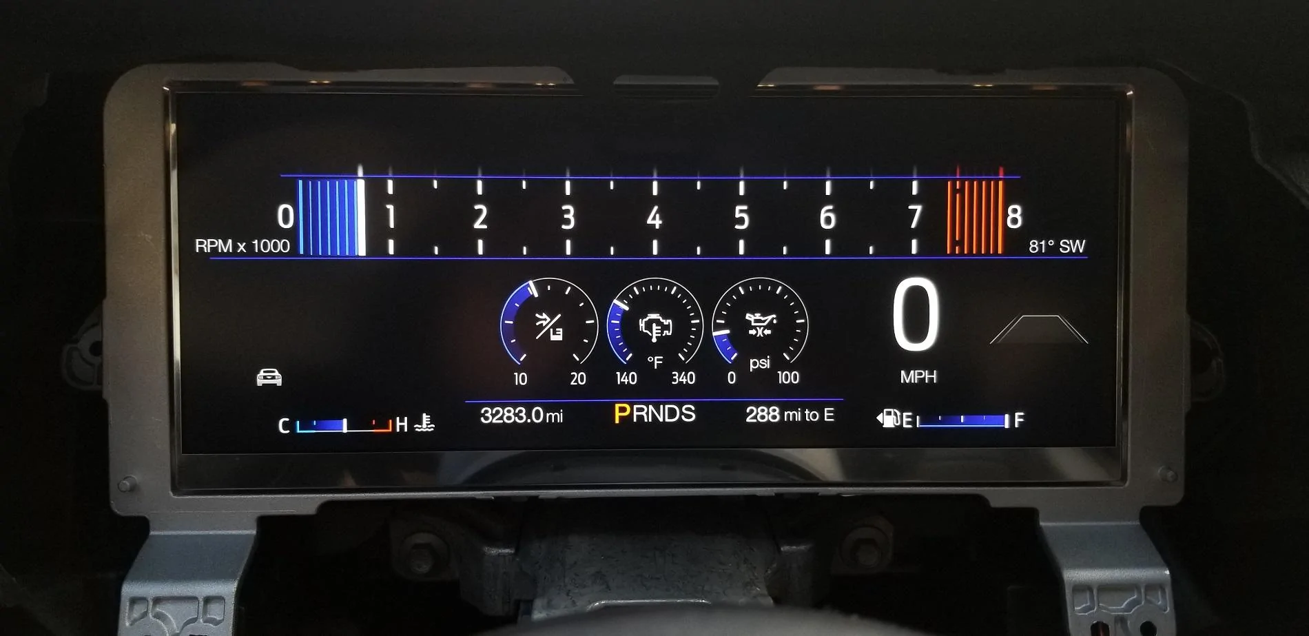

I pulled cluster trim off today and I applied a spray rubber coating to the reflective surfaces. Luckily the faux metal trim pulls off easily. I masked everything using painters tape.
So far it looks like other OEM cluster trims I've seen designed to reduce reflections. It's still shinier than I'd hoped for if I had felt of Alcantara but it looks OEM. I halso hit it with a coat of a matte black spray paint.
I'll haven't tried it yet but I should be able to do that tomorrow.
michail71
Apr 15, 2018
92
1,225
214
2018 GT 401a A10
The rubber spray seems to do a good job of keeping the reflections down from the side windows and front windows but not as good as felt.
What it doesn't get is rear window reflections since those are direct and they also happen no matter where the sun is located. It just has to be not night time.
This go me to wondering if that plastic over-screen needs to be there. What purpose does it actually serve? I can see if it were an analog display it would be there to protect the mechanical parts.
If it does need to be there a polarized film might help.

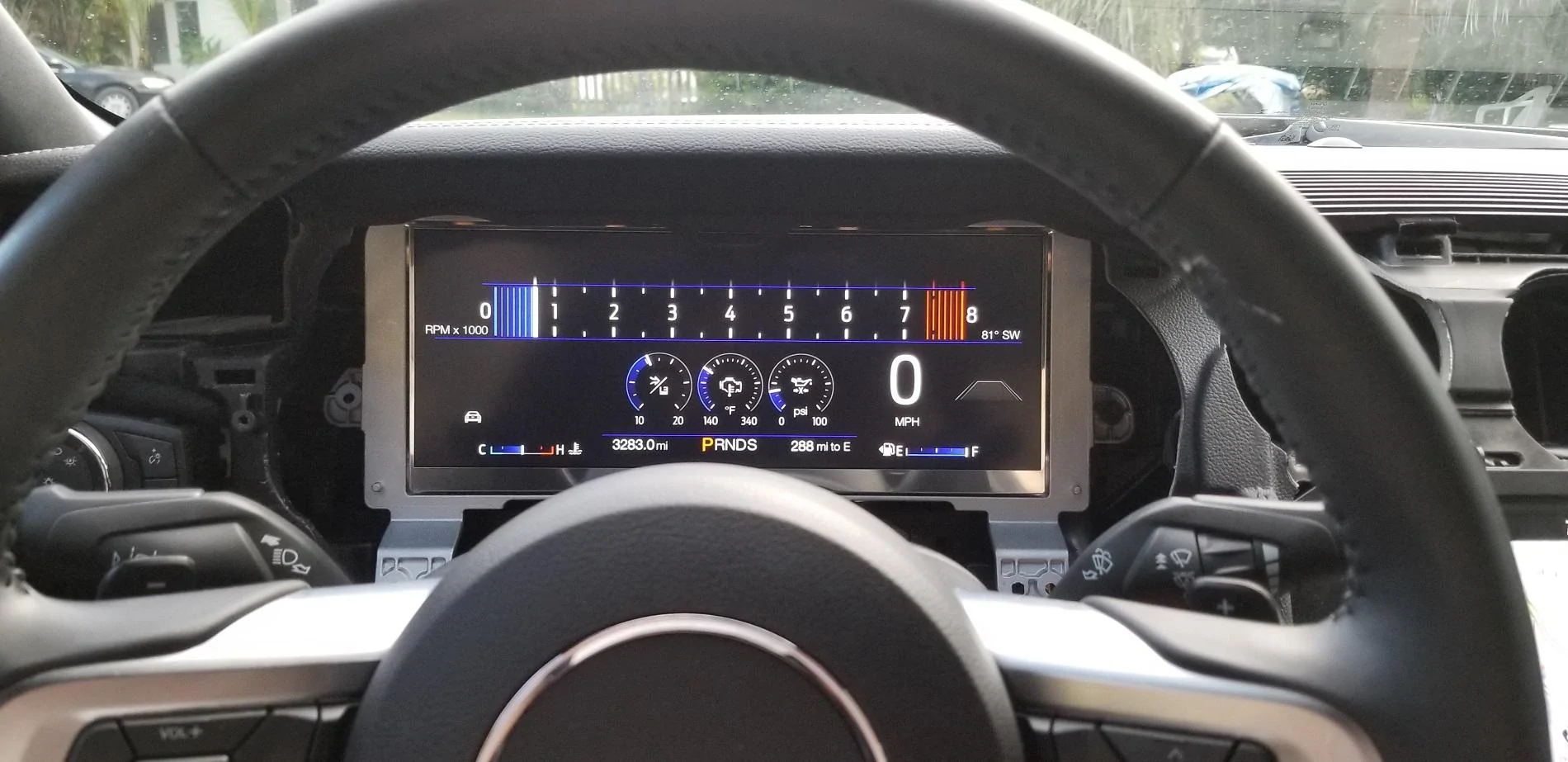

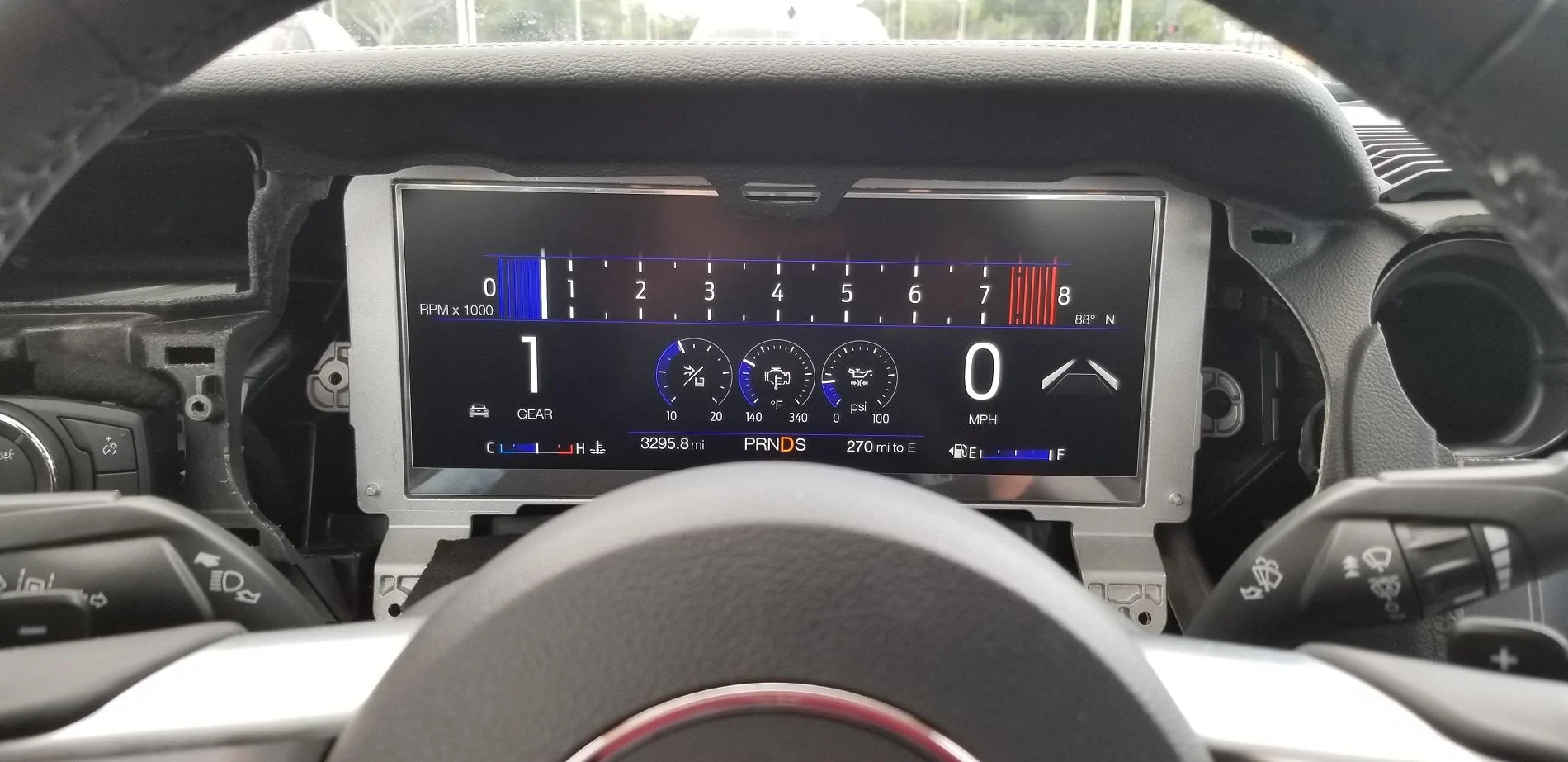

I removed the plastic cover today. It seems to have cut the glare down. Glare mostly turns into lost contrast now.
I drove around in the later part of the day and it was much better. I'll see how it does tomorrow.
The second shot was me trying to catch the most glare with some overexposure on the shot.
Unfortunately, as a permanent solution this would leave a big gap. :(
And OMG, so much wasted display panel! About an inch on the top and on the corners. This is a design example of form not following function.
michail71
Apr 15, 2018
92
1,225
214
2018 GT 401a A10
It crazy how much better this is driving around in the daytime now. The screen clarity is much sharper without the plastic window distortion and glare is eliminated.
In my photos I had it resting on the pins so it was angled up. Once it placed property any remaining reflection was gone.
It is just a normal lcd panel like on a laptop. So I don't think it is required. The trick will be removing the window and filling the gap.
I'm open to suggestions on how to accomplish that but I think this may be a nice "delete" mod.
Perhaps a gasket made with a 3D printer?
michail71
Apr 15, 2018
92
1,225
214
2018 GT 401a A10
This is the worst case scenario with full sun overhead. Most of the reflection is coming from the exposed metal on the steering column since the trim piece is off. With the trim in place and no plastic window it gets reduced even more.
