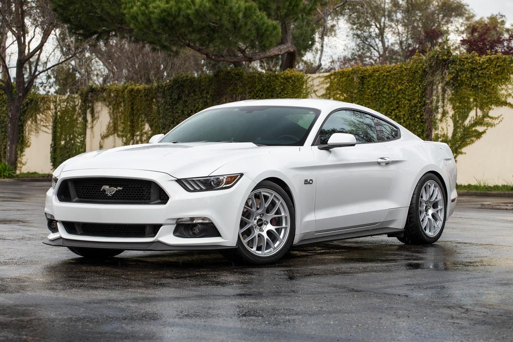

Here are a couple photo's of our 19x10" ET40 square fitment as an example.
