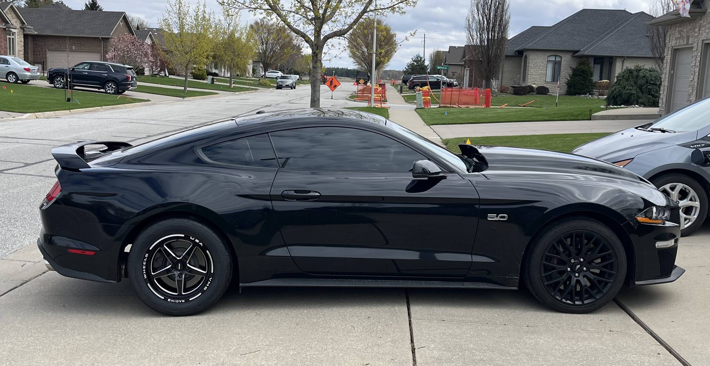

Hi everyone,
2018 GT PP1 corsa extreme active exhaust, stock tune, VMS 17x10 with nitto555r2 305/40/17.
my previous 1/4 was with stock wheels and tires and my best time was a 12.6. Really hoping to break into the 11’s with the wheels and DR’s.
what would those of you that know much more than me suggest for launching and running my best time.
drag made, track and advanced track disabled, D mode.
What Psi should I run my tires at? I do have to drive home about 45 min and I won’t be able to get an air pump in time to get them back up. I was thinking 25PSI?
would love and advice, thanks!

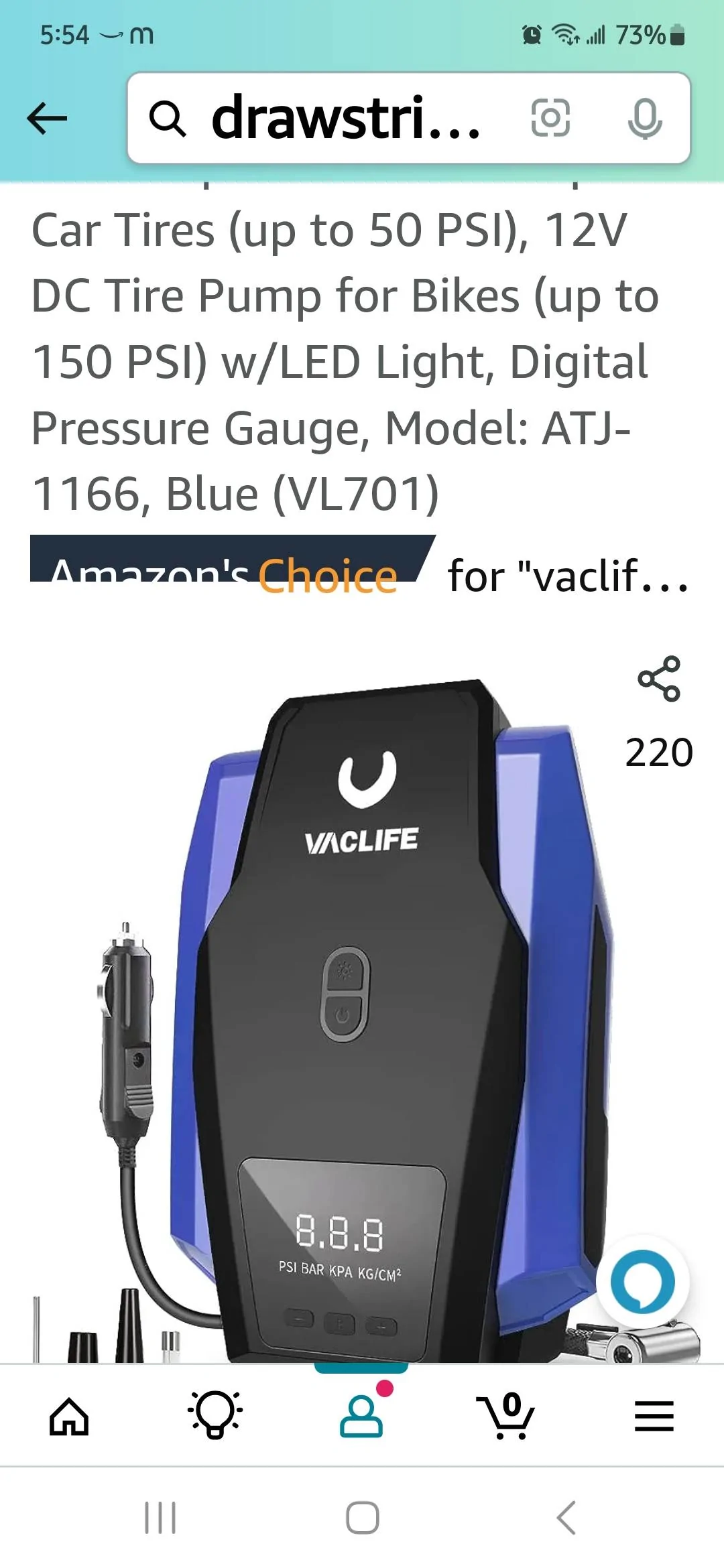

Hi. Easy Peezy. Buy one of these 12vdc mini compressor and keep in your trunk. I put them in all of my children's cars for emergency tire air ups. Good Luck!!

Every track I've ever been to has air you can use to fill the tires before you leave the track. You shouldn't need your own air compressor.

Thanks guys, I’ve been working nights and don’t have time to grab one.
