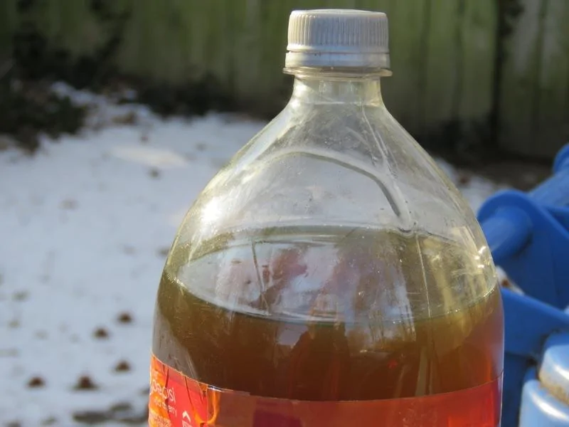

The average owner isn't going to bleed his brakes several times a year with fluid costing $20/liter and up, and the good track stuff absorbs moisture quicker and needs to be bled/changed more frequently even if the stuff that comes out at first doesn't look bad. In my experience, the first couple of pumps from the front calipers looks a good bit worse than this after just one track day.
