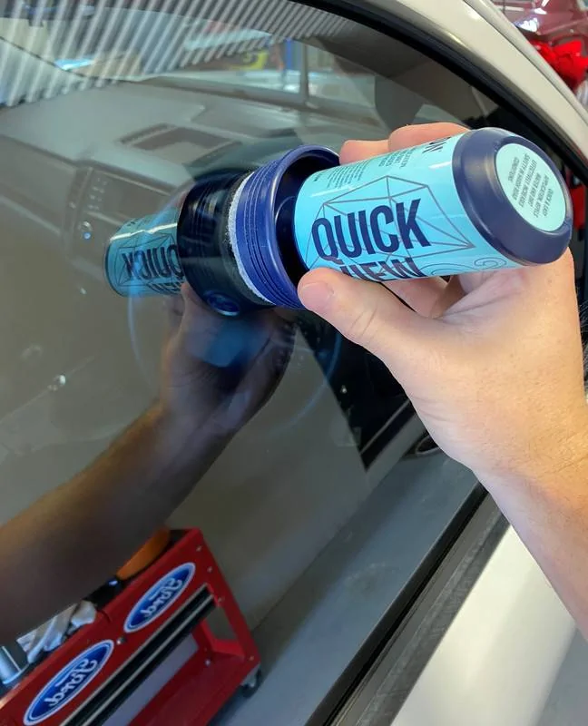

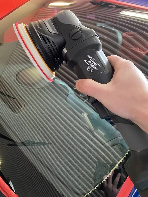

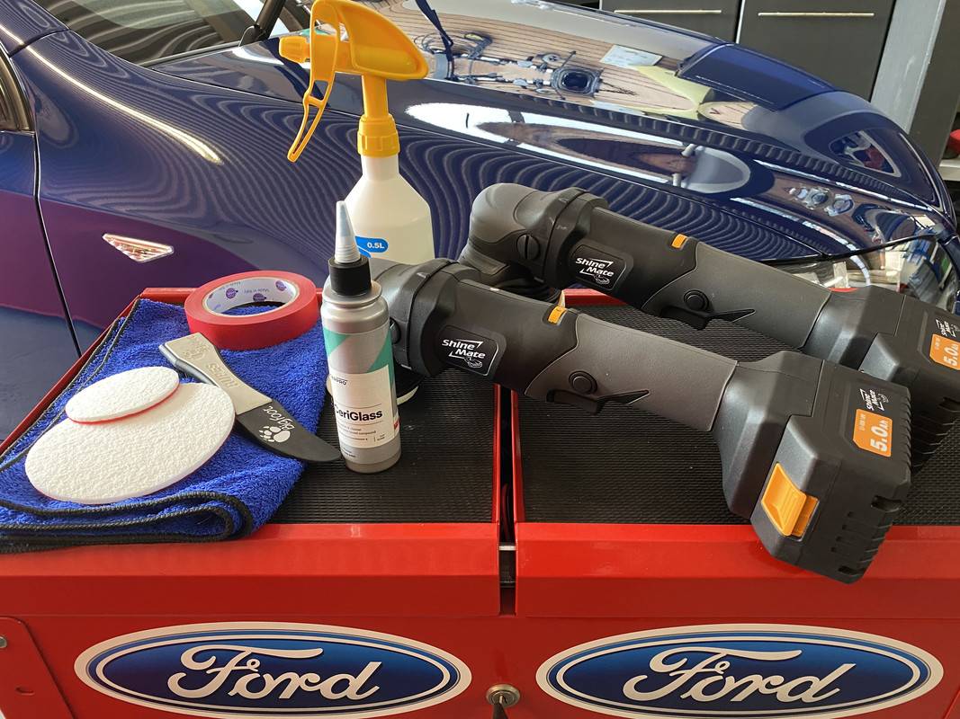

If regular cleaning is not giving you the result, perhaps try polishing the glass.
I use CarPro CeriGlass and Rayon pads for glass polishing. Polishing can be done on a machine or the small hand polishing cubes supplied with the CeriGlass kit. Make sure you mask up the rubber trim before starting.

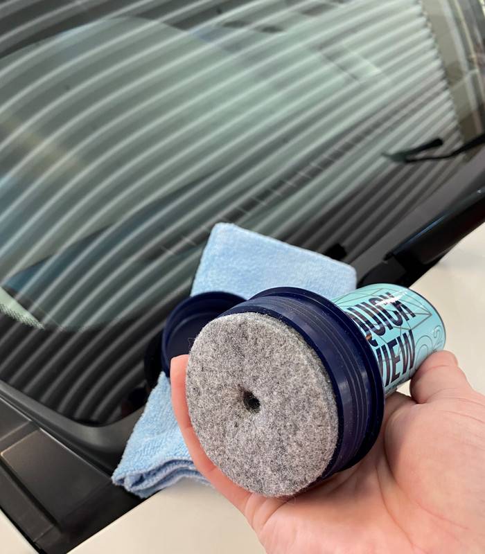

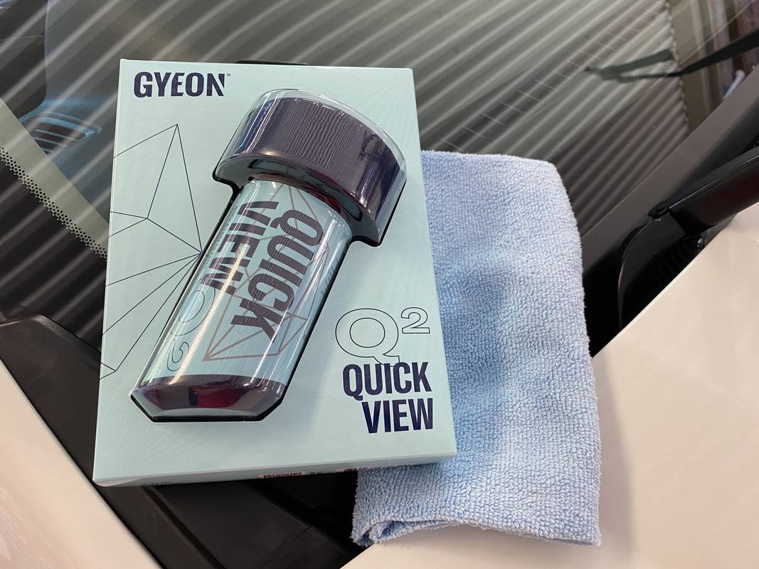

As for sealant, I'm using Gyeon Q2 Quick View at the moment. This comes as a combined bottle and applicator and is as simple as wipe on, wipe off. If you don't polish beforehand, at least clay bar the glass first and wipe over with an IPA product like CarPro Eraser or Gyeon Prep.
