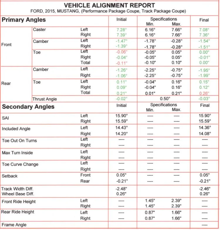

Here is the alignment sheet- how does this look??
camber looks pretty aggressive and I'm a little concerned by the rear toe- is this a concern?

Toe looks great, no need for concern, although your initial rear setting would be better. Front looks perfect for a street car.
I would like the rear camber to be a little less, closer to -1.3 to -1.5.

So-having the front and rear camber in the same range is preferred? I noticed that Ford's Track alignment specs have a bigger negative camber out back compared to the front spec. How does the bigger negative camber # in the rear affect how the car handles compared to having the front and rear camber in the same range (-1.5ish)?

More negative rear = a bit of safety factor. If you are tracking the car, you'll actually want the front to be in the -2 to -2.5 deg range, as high as -3 or so for more dedicated track cars.
-1.3 to -1.5 in the rear makes for a good balance of straight line grip and cornering grip for the street. The -2 setting would be good if your front was correspondingly higher as mentioned above (track settings). Remember, when you accelerate, the weight transfer to the rear will actually make both sides go more negative, reducing your contact patch as there's no roll.

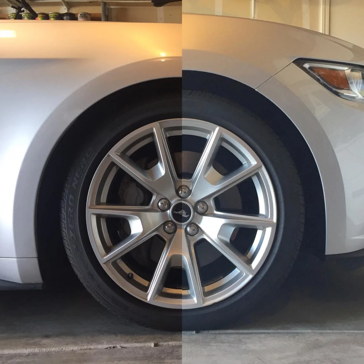

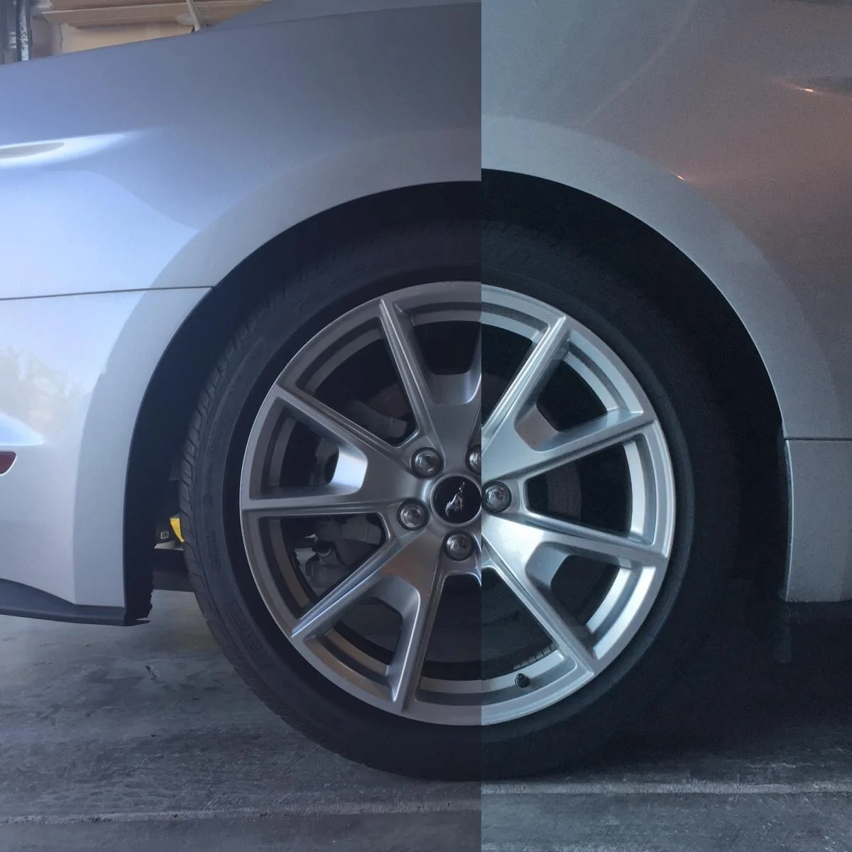

My best shot at before/after stance. Should I expect things to settle some more or nah?
