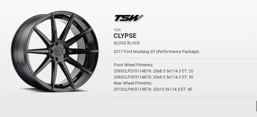

So after looking at what seems like 6000 wheels, I found some I like in Gloss Black. Really looking for the concave design, but not sure if these wheels will stick out the fenders. Looking at 20x8.5 up front, and 20x10 out back. Was really wanting a 295 or 305 tire out back, but I don't think that will fit safely on a 10" wheel? I assume also that a 255 tire is the max up front on the 20x8.5? Also, any negative feedback on TSW Wheels? Looking at the specs, says they are forged but only weight 27-29lbs. The offsets are variable on what's available, so anyone know the min offset before the wheel is exposed outside the fender?

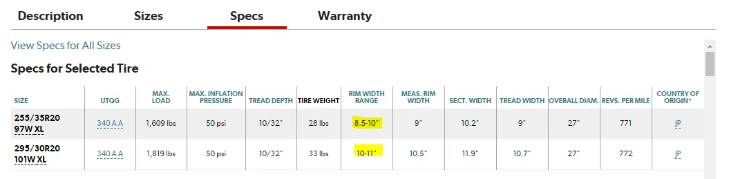

A follow-up, really settling on this one. Looks like with the offset being so low (really giving the concave look I'm after) that the 10.5" won't fit on the car. This isn't a problem if I can run a 295 on that 10" wheel. As for the front, wish I could get wider than the stock 255, but I'm afraid a 265 would be took wide for 8.5" wheel. According to TireRack, the 255 and 295 will fit on these wheel, barely.

Clypse: This one is my favorite, but the front sizing is too small I think, could probably only do a 255 up front. That said, I could go square with 295s all the way around on the 10" wheel. Will that 20x fit up front?

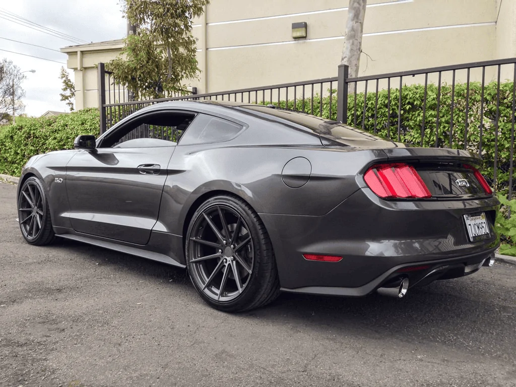

Cant fine a real image of these on an S550.

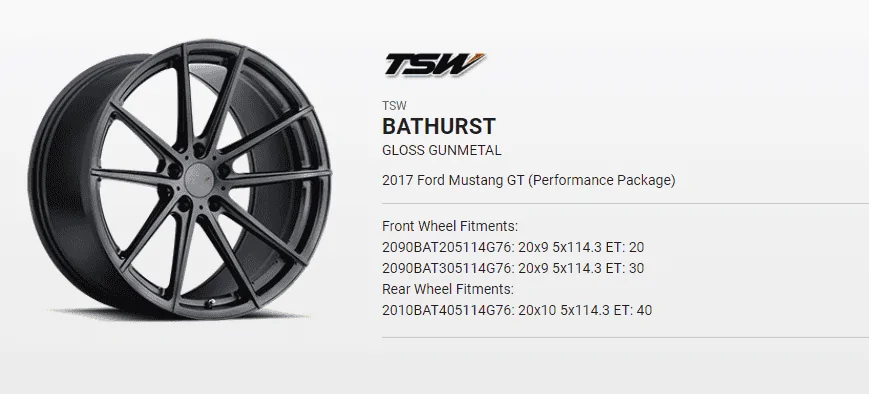

Bathurst: Problem here is I was really wanting gloss black, but otherwise the sizes are good as I could do a 295 out back and a 265/275 up front.

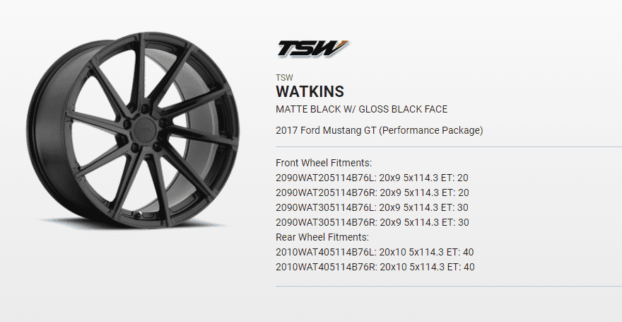

Watkins: Probably my third choice. The sizing all looks good, and they at least have the gloss black face (not sure what is matte black, the inner wheel?).

Those still aren't the best when it comes to the tire fitment you want. A 295 tire really needs an 11" wheel outback. A 275 needs at least a 9.5" for the front. Once again disqualifying compromise in my eyes. To each their own.

It is the minimum recommended wheel width for a 295 but its not optimal. The way you spend your money is obviously up to you. However this is a forum in which ideas are shared and if you are going to go through the expense of switching out tires and wheels (not a cheap expense at all) you should go what works best. A 295 tire won't perform any better on a 10" wheels than a 285 on a 10" wheel, in fact the edge might even go to the 285 tire.
