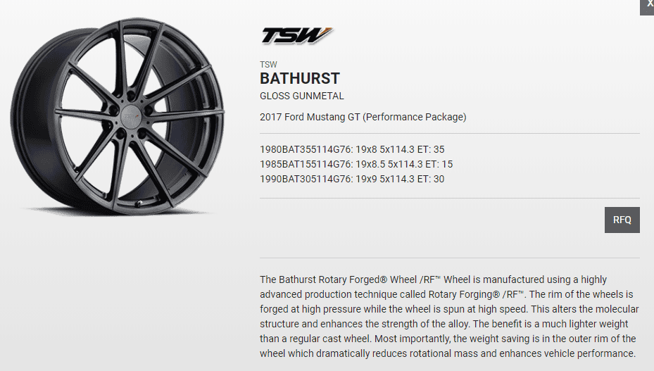

Thanks for the link sir. There are a few on there that I like. I did notice only 8 where 19" and I didn't really like any of them. Out of that list (all 20") the Verde and Bathurst are my favorites..
There are others I like, but those models look to only come in Satin Black. If I could get this one in Gloss Black, the decision would be made.

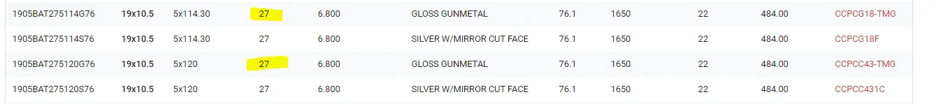

My preference is Gloss Black, I would consider Gunmetal if I have too. That said, It is interesting to see that 20x11 Bathurst because I hadn't seen that offered on any other sites. Largest was a 20x10. I assume that 20x11 with 50mm offset will fit?

All those Verde's are satin black.
Now I didn't see those Bathhurst wheels in 19x10.5, which would support a 295. That may be my best option so far. Could even do the 9.5s up front with 275s. I guess I missed them because their website filters them out when you input your vehicle details...notice the 19x10.5 isn't listed.
Perhaps it's because of the smaller offset?
Those ET27s will poke out a bunch by over 16mm.
Yep that's what I was thinking as well, which is probably why the TSW site filtered them out. So if the 27 ET is 16mm outside the fender, then the optimum is ET 43+ ? Most that I see are around 50mm on the rear. What about the front, what's optimum up there?
Usually a 50mm offset is for an 11" wide wheel. A 10.5" wheel has the same poke as a 11" wide wheel with an ET50.

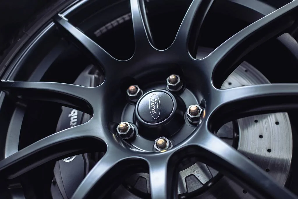

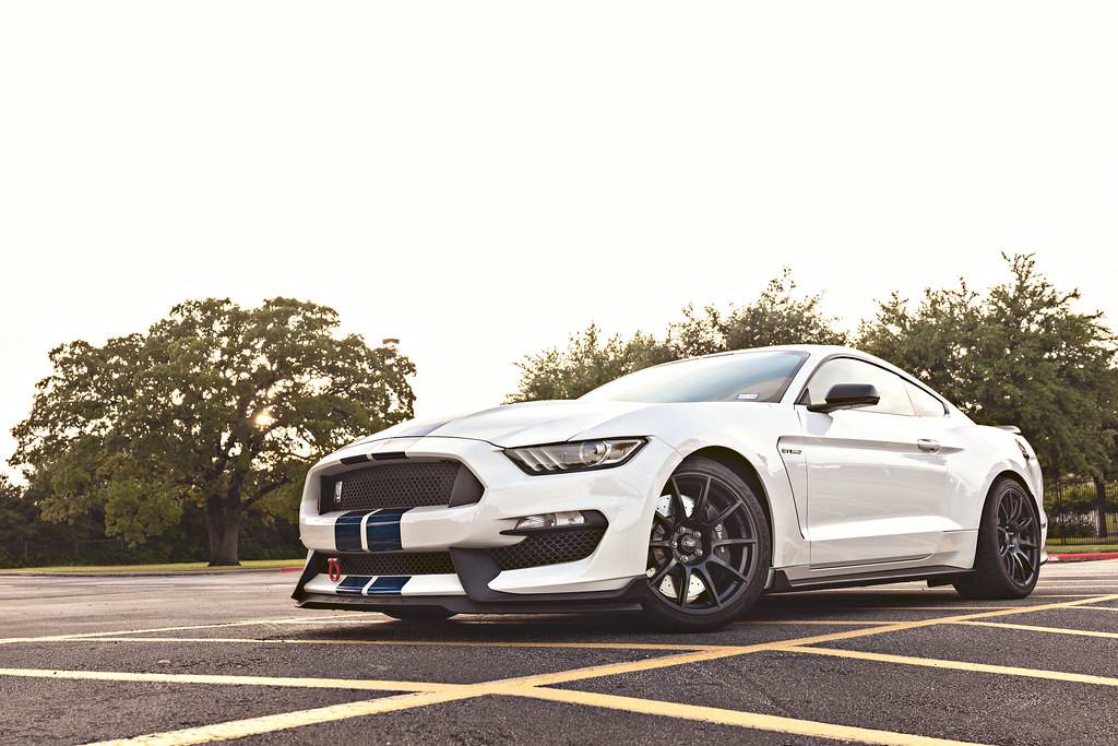

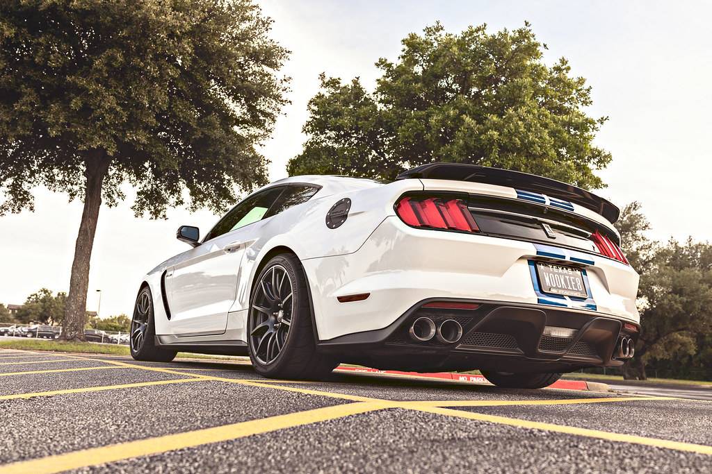

Concavity will vary in each design, but as a general rule of thumb on newer Mustangs, you can't run a deep concave wheel in the front as it won't clear larger brake kits or fit under the fenders. Concavity is determined by the width and offset of the wheel. Anything that's 8.5", 9", etc wide will not be concave at all if it's going to fit onto a newer Mustang.
Our EC-7 and SM-10 Mustang wheels are available in 18" and 19" diameters, with widths ranging from 9.5" wide to 11.5" wide at the moment. They all use our "profile 2 - medium concavity" face which to be honest, is as concave or more concave then many other "DEEP CONCAVE" wheels companies try to sell.
Not sure the exact wheel mentioned above, but 28lbs is not light at all for a 19" wheel. Check out our lineup, they range from 23-25lbs for 19" options and feature a 1650-1670lb load rating.
Here are a few shots of 19" SM-10s

Awesome thanks for taking the time to reply. Question, I’m looking for gloss black wheels, are either model available in gloss black? Browsing on Steeda and I only see satin black? Lastly, will the 19x10 fit up front on the 17GT with PP brakes? Regards.
These are only produced in Satin Black, which is pictured above. We generally prefer Satin Black as it stays much cleaner after driving on them with brake dust.
19x10" ET40 has no clearance issues up front with the PP brakes. Our 18" wheels also clear those brakes :)
