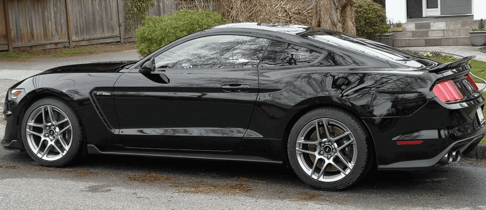

Do you have any pics of them? I am considering those tires for everyday driving and winter storage, but I am concerned they are too skinny at 255 and 275... How do they look, especially on the rear? I would do a square setup, so I would use 275 all around I suppose.

Here's mine last year with a set of GT500 Base rims (19x9.5") with 255/40 front and 265/40 rear Michelin A/S-3's.
You wouldn't want to do an autocross with it but heavy rain and standing water is no problem with this setup.

Thank you! Do you have any pics from the rear, I wanted to see how wide the tires are on that setup...

Unfortunately, I don't - I was more focused on the "look" of the GT500 rims on the black GT350 than I was on tire size. However, the Mustang GT PP1 comes with the 255/40x19 - 275/40x19 combo from the factory, so seeing it from the rear is easy - just find a Perf Pack S550 GT and look from behind!
