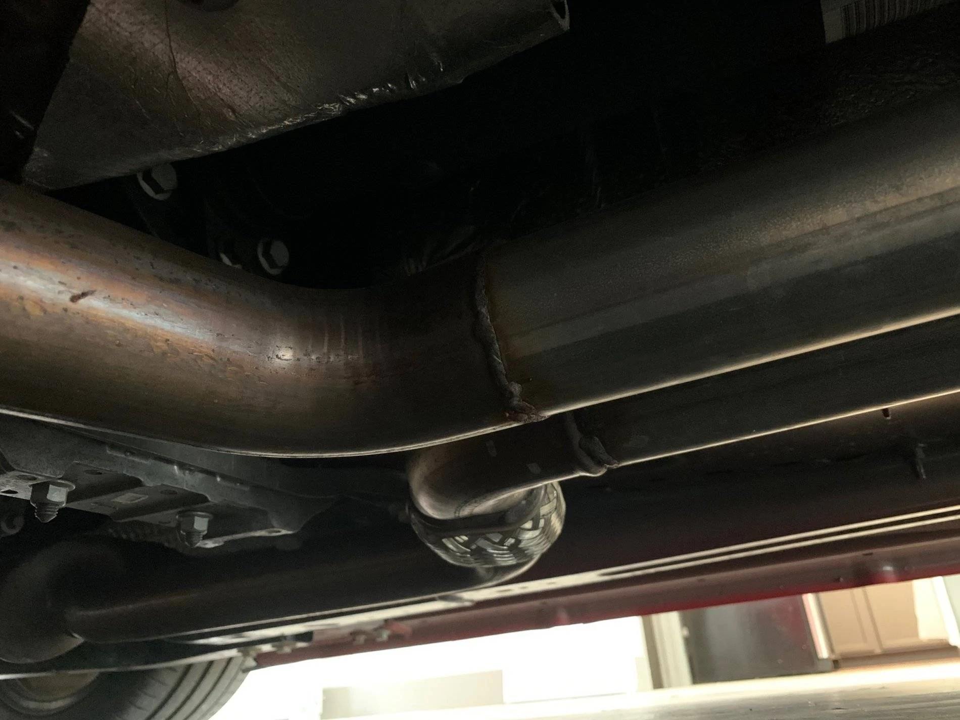

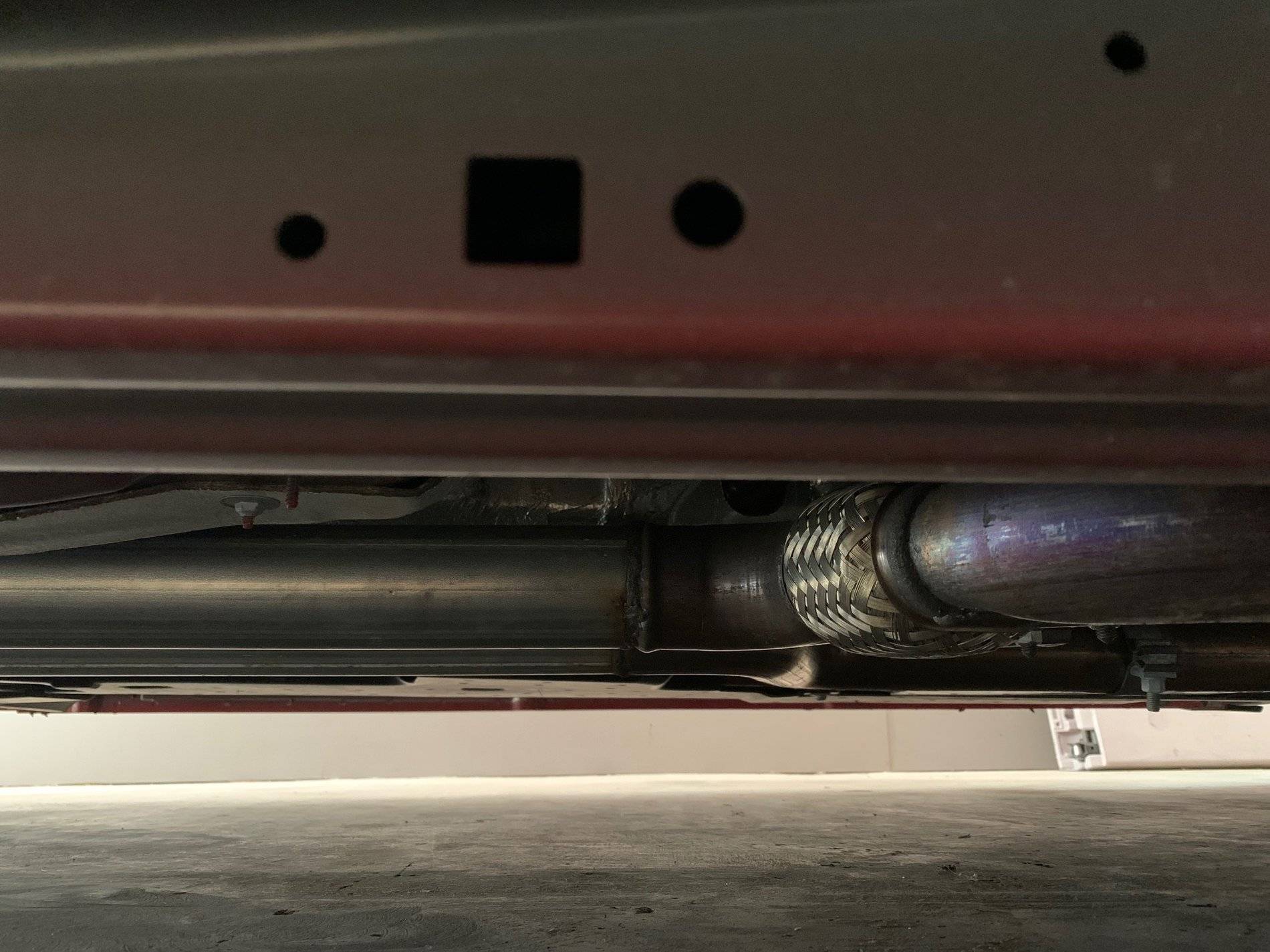

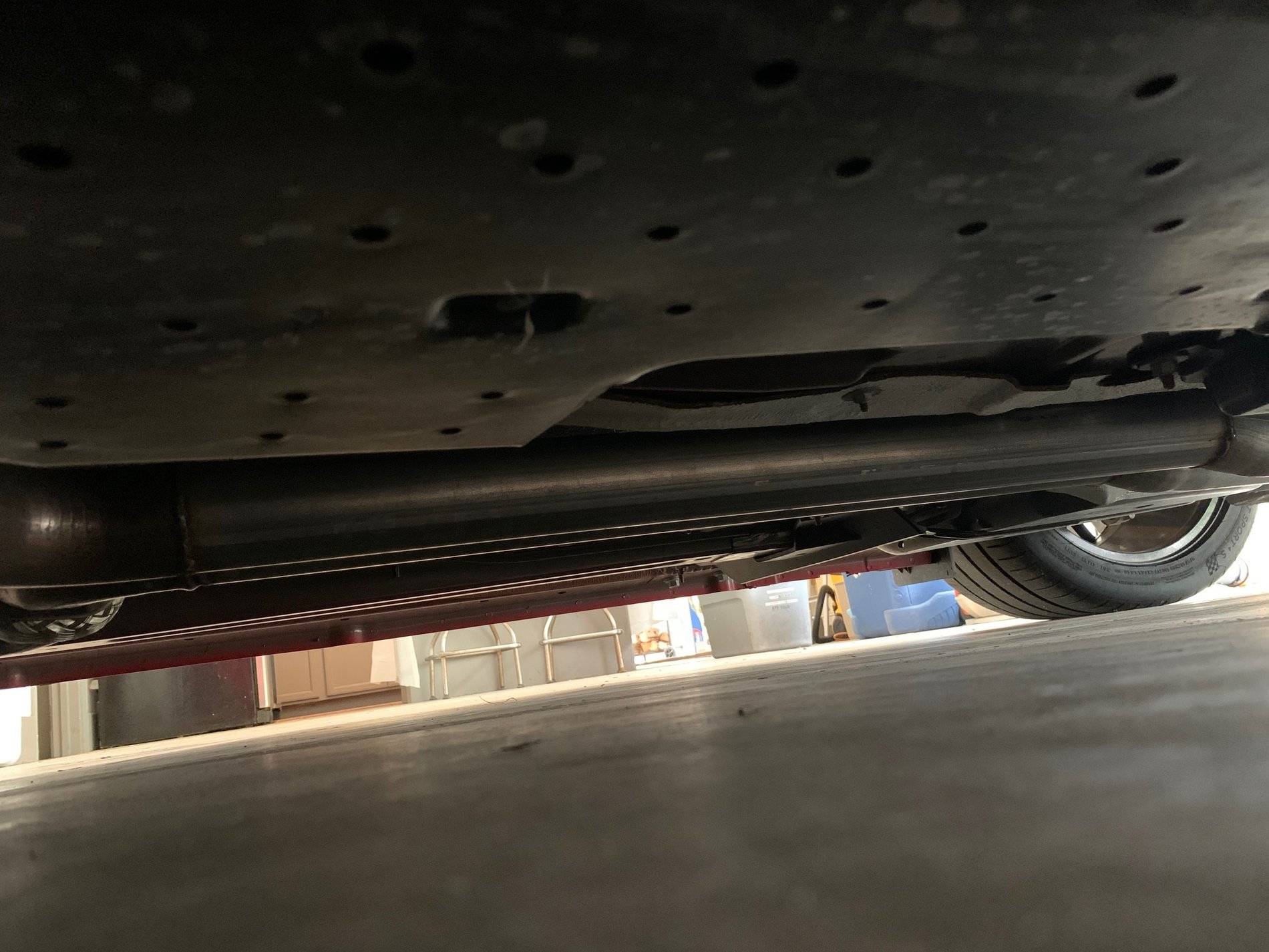

thank you for your responses, so more then likely i will need to take it to an exhaust shop to have it put on? i had planned on installing them myself but i suppose in order to have the fit just right i will need to pay the install fee as well.
here are the pics for reference

im curious about the OD on the pipes the welded in. i will need to get back under it and measure they look like they neck down a little in my pictures
They appear to be the same as stock header: 2.25". You should measure to confirm.
