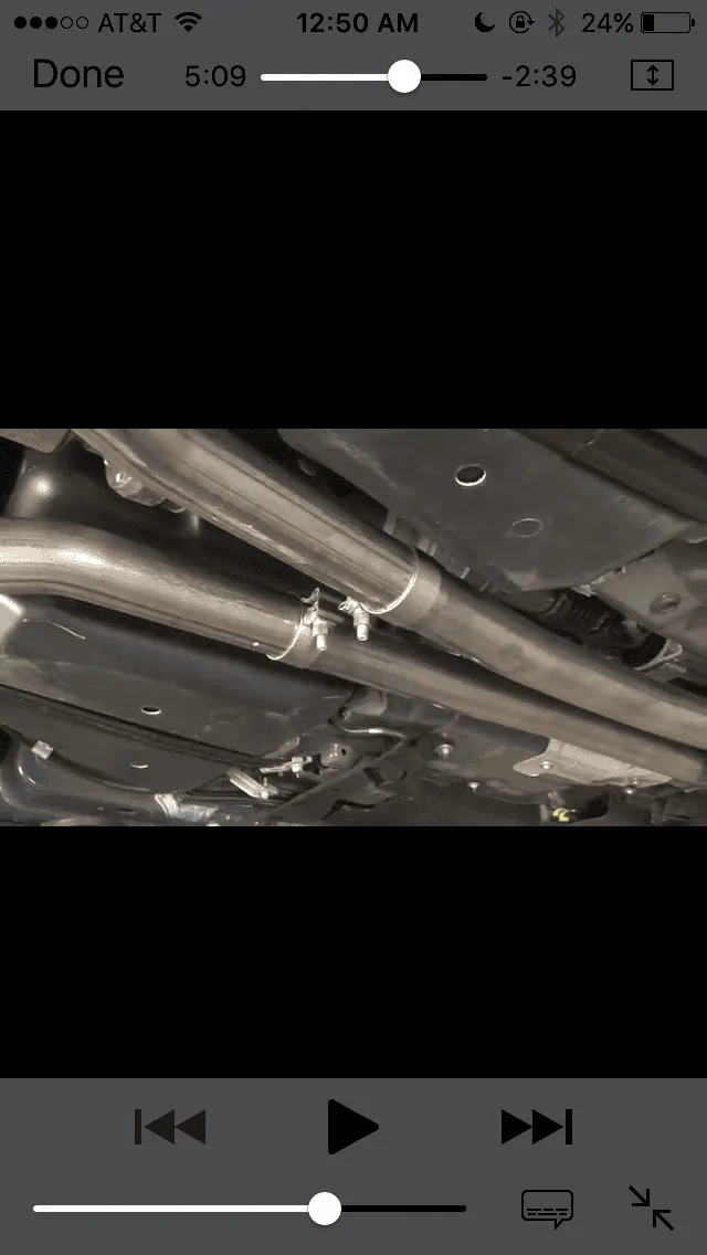

I have an H pipe resonator delete and axlebacks. I've tightened the clamps on the rear end of the H pipe two different times where the h pipe meets the stock piping before reaching the muffler piping and it seems it keeps coming loose and one side will turn slightly and droop down.

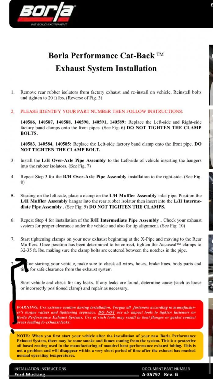

What did you torque yours to? I made it really tight but didn't use a torque wrench..
Here is a pic of the specific clamps im referring to:

The Magnaflow install manual said 38 lb/ft. The clamps they provide look similar to those

Borla install instructions say 32-35 ft/lbs

Try moving the clamps so they are in line with the edge of the pipe they're on.
From what I can see in the picture, it looks like you have them at the inner end of the slot that is cut in the pipe. That will reduce the overall clamping pressure of the strap. Which could cause it to slip. The picture is a little blurry though, so I could be mistaken.
