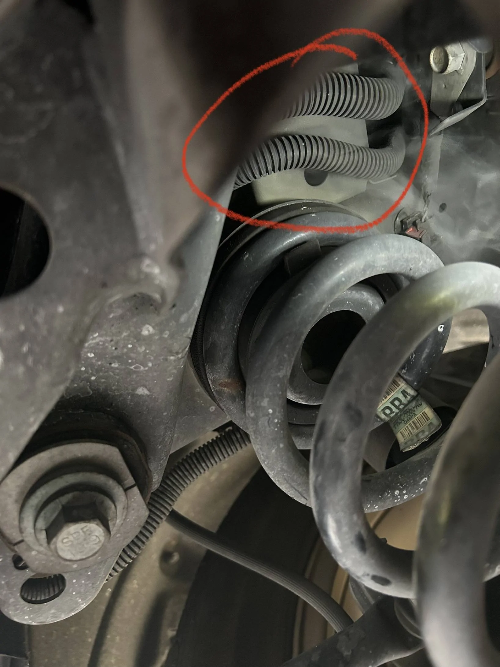

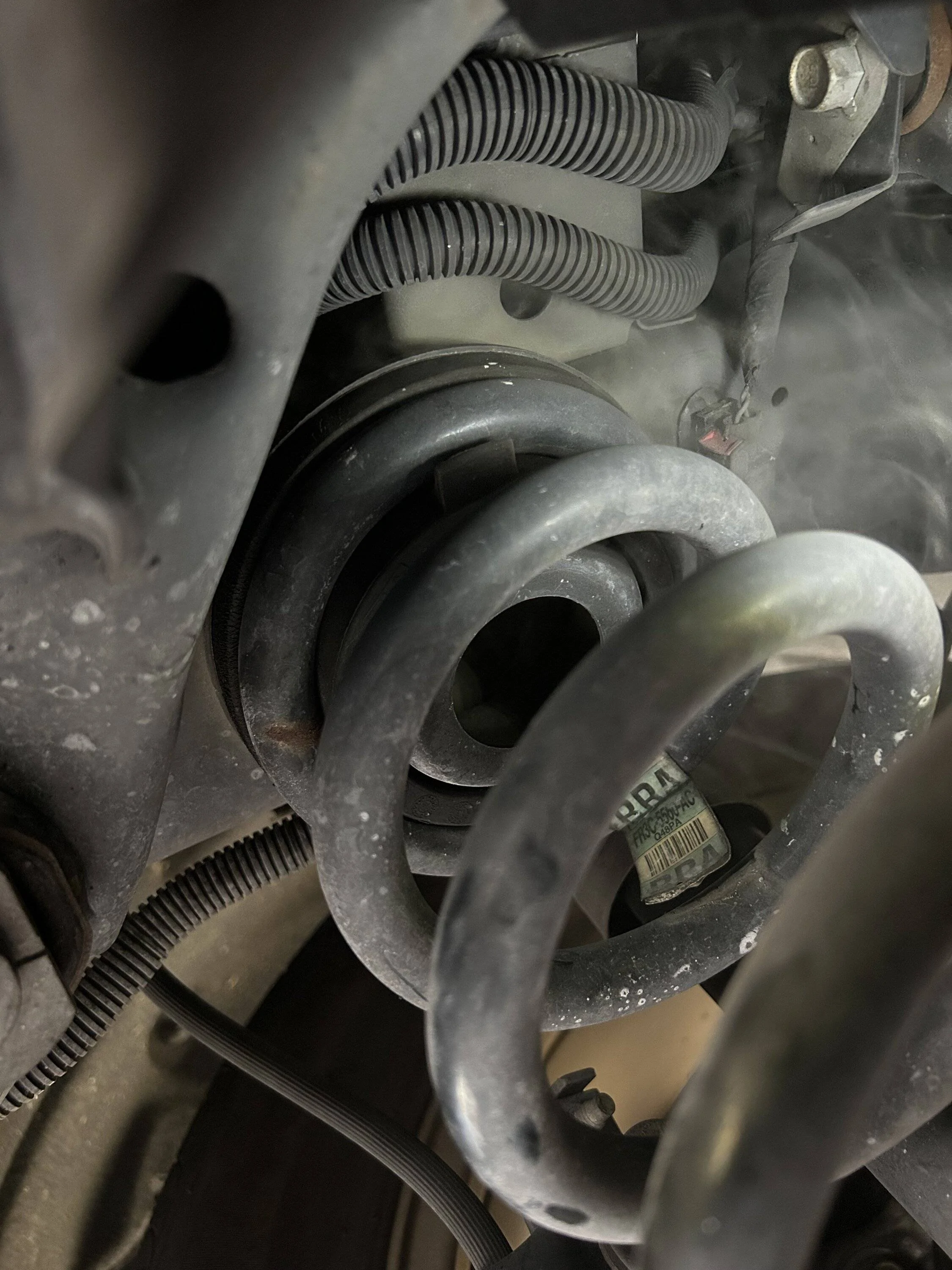

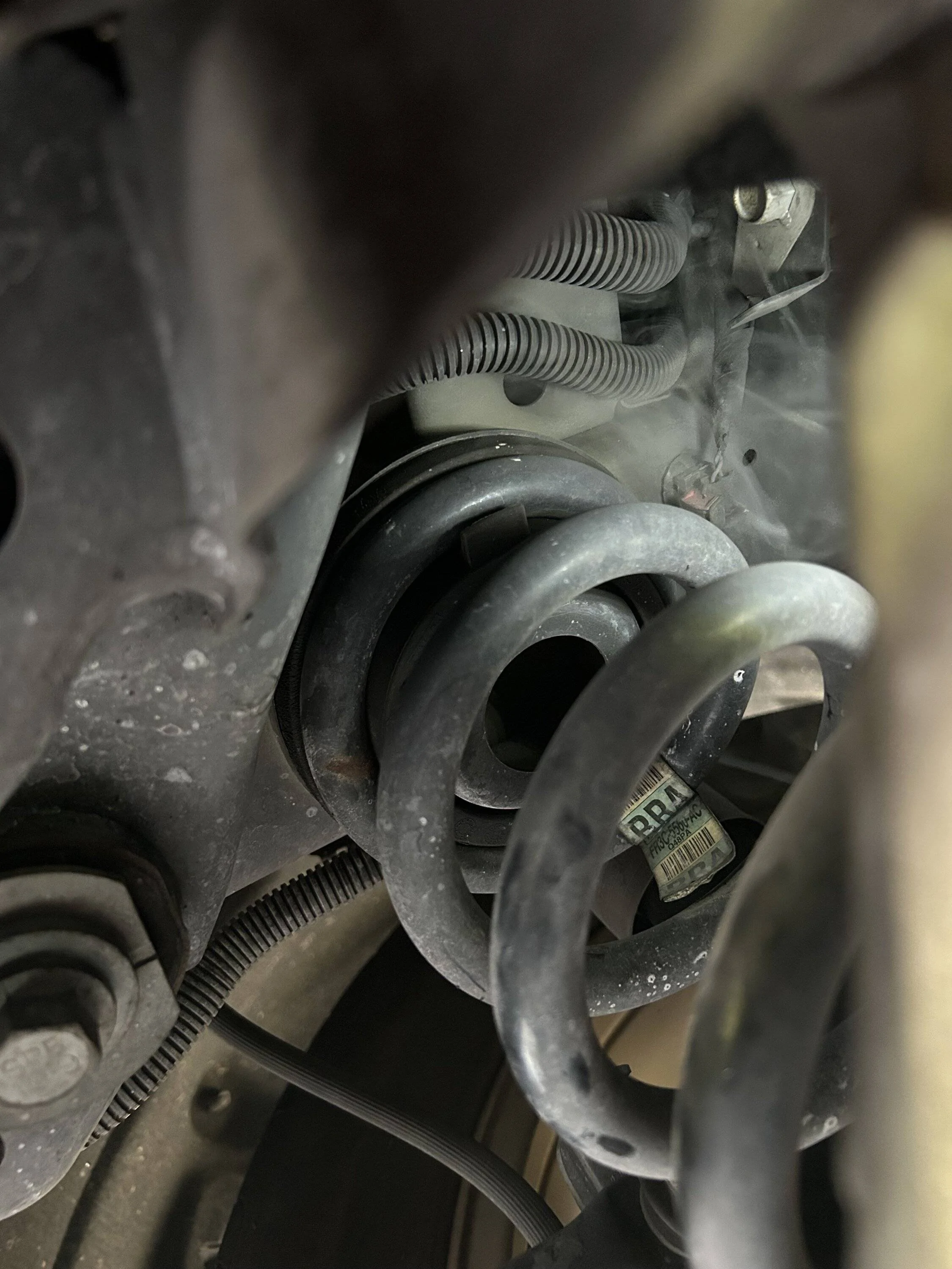

Did a smoke test and I think I found where the leak could be but still can’t pin point, what could it be and do I need take out suspension?
The pictures are from passenger rear side

Nvm, This looks like to be the canister vent. When I close it , smoke doesn’t come out this location

The vent valve is always normally open. This is what draws fresh air into the tank. You need to manually close it with a higher level bi-directional scan tool and then re-run the smoke test to find the true source of your leak.
