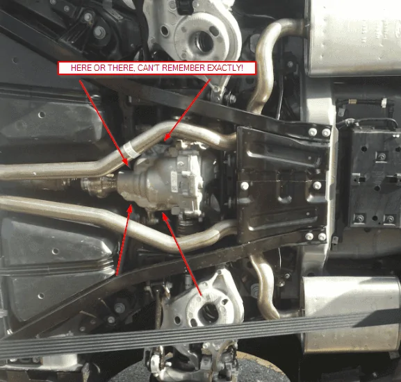

Thank you so much, So many searches and only Eco booast was comming up , you can see the sensor from the upper right arrow in the pic , top of the pumklin : )
Funny, I had P0453 on my 2008 F 150 and my 2017 Mustang GT at the same time, both inspections were due March and April, low and behold they both had a broken wire right comming out of the sensor plug. Saved a bunch of money : )
Thanks to the only post in the world where this sensor is on the Mustang GT 2017

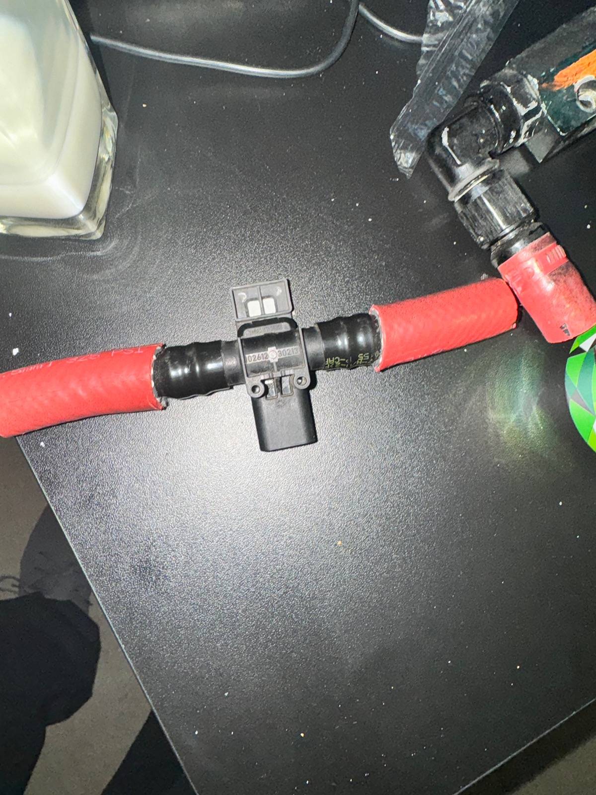

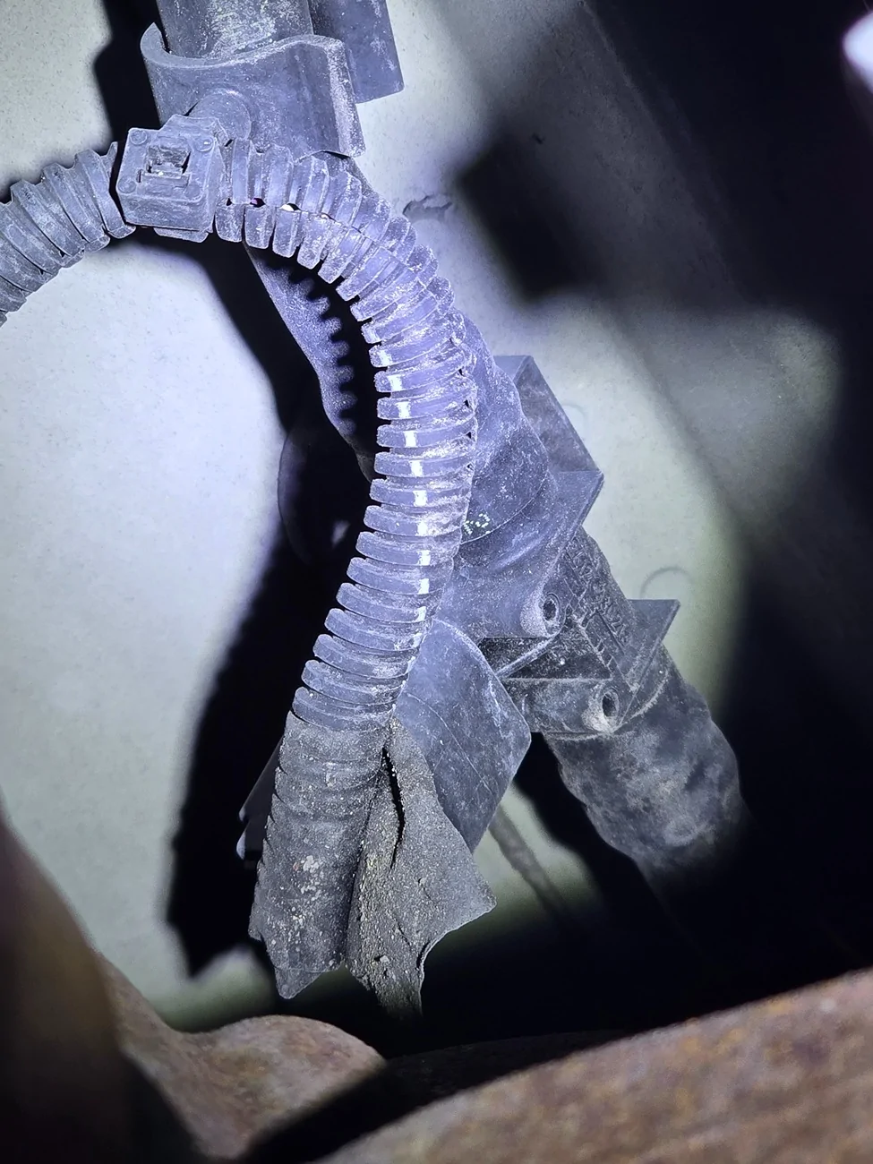

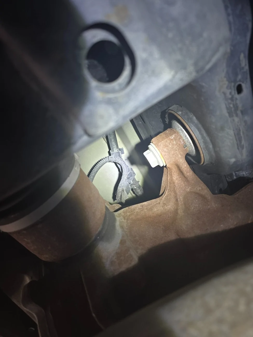

Welp, I went ahead and jacked it up and did confirm it is the inline style. For future reference here are some pictures I took of it on mine but it is reight above the diff, on the passenger aft side.
Also from research it appears the part number needed is 9U5A-9C052-BC. So I've ordered the sensor and will also attempt to swap it out once it gets here. I'll report back if it all ends up working...fingers crossed.
