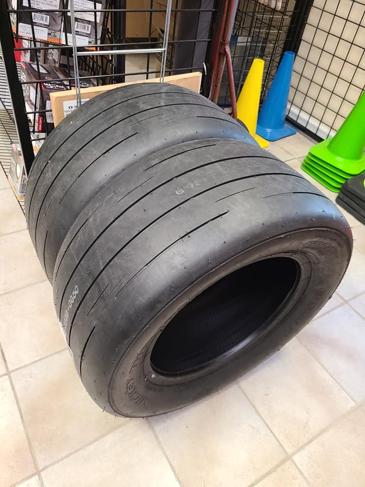

Better step up to the 315/50/17 Street R's.
Yea that’s definitely my next move and sell my current 305/45/17 SS that probably have another 3000-4000 miles left in them

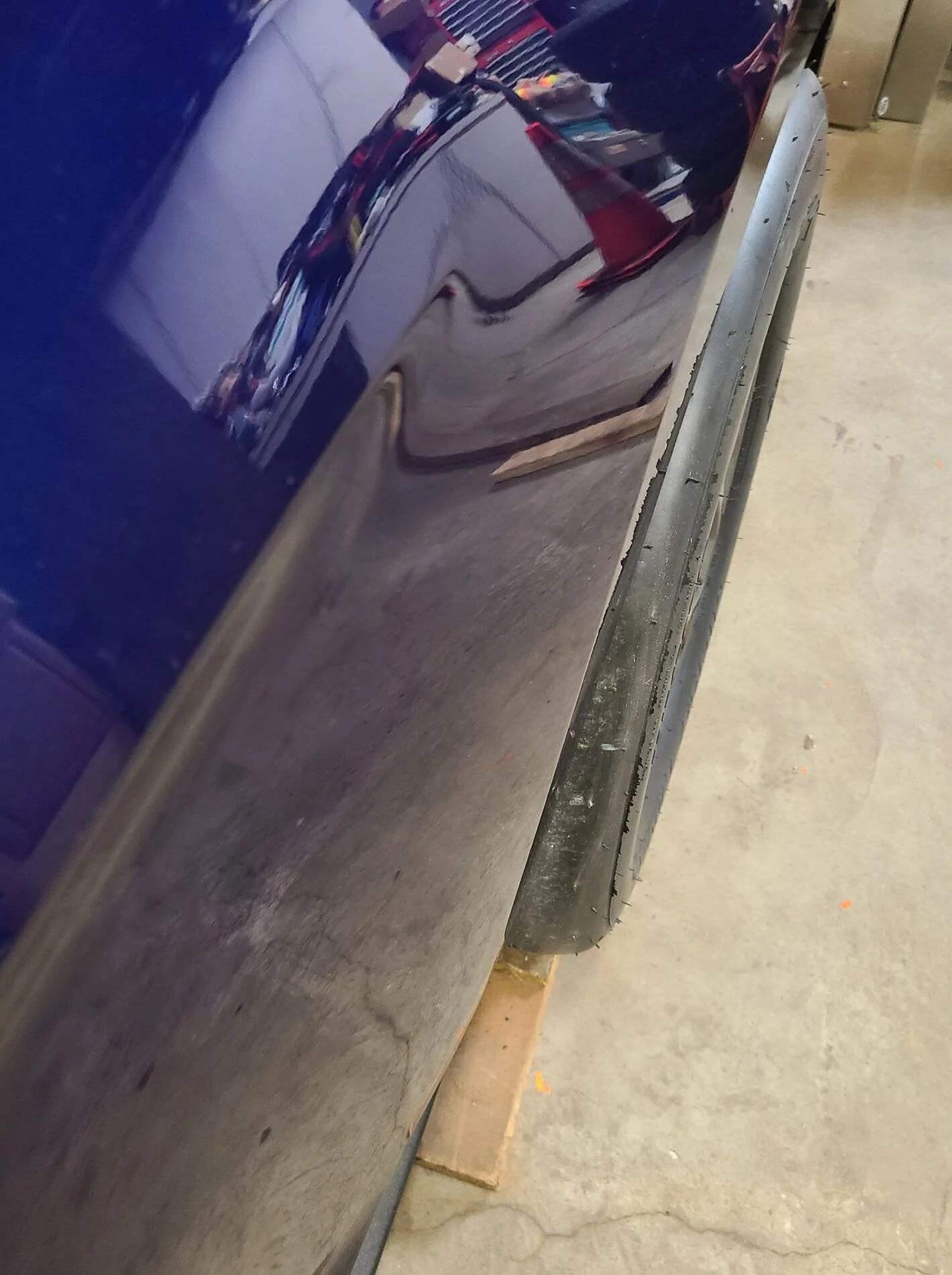

Any modifications required to fit a 315/50 tire?
I had to use Steeda's 3/8" spacers above my drag springs. If you are stock height, you may not need them.

I’m on eibach sportlines so I’ll definitely need them then
