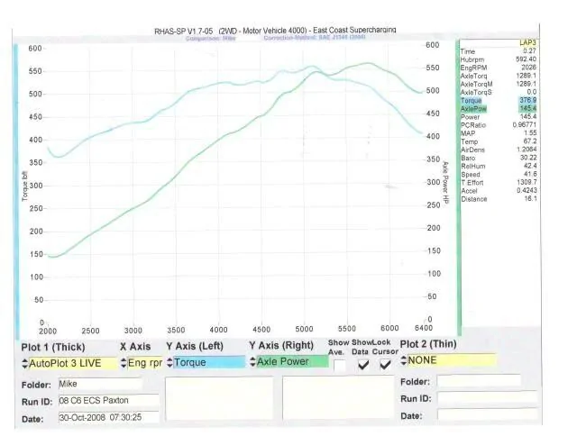

Remember, smaller pulley = more tq. Lol back in the day, the ECS corvette kits would come with a super small pulley, but a restrictor plate for the blower inlet that would limit boost at higher RPM. I always thought that was genius because you'd get almost PD blower tq since it was spinning way faster at lower RPMs, but at upper RPMs it would be limited by the restrictor plate. They were able to make HUGE tq at the bottom like you were running an eaton or TVS blower, but with a paxton novi 1500 on the LS1/2/3 cars.
No idea why we dont do that with Coyote kits. Same problem they had needing more tq down low but wanting to control boost up top...

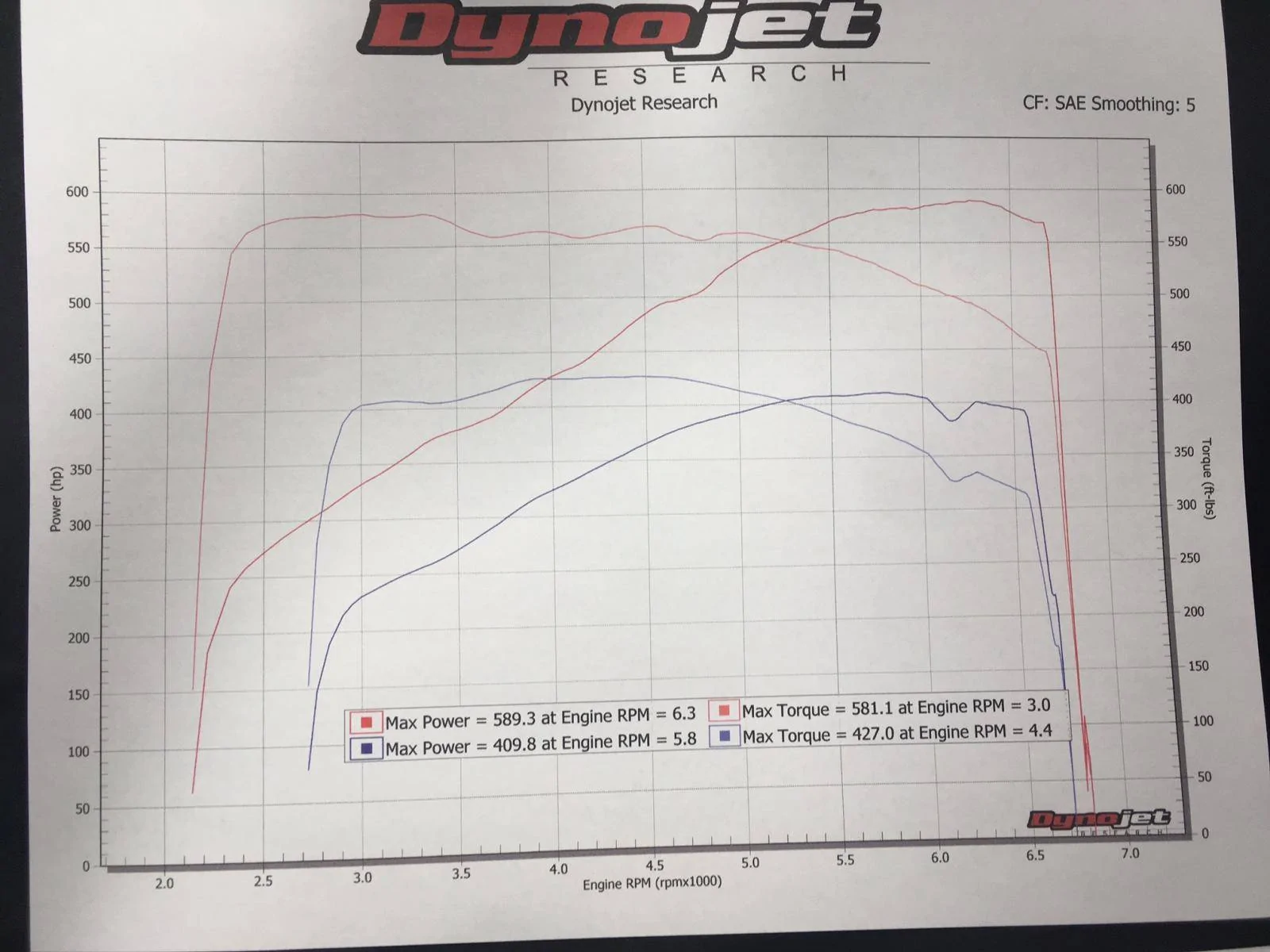

:crackup:
Not even close to PD power or boost. Tiny gains down low.
robvas
Nov 18, 2023
3,816
3,609
MI
2011 GT
Looks pretty good to me for a novi 1500. Making 400ft lbs at 2500 for a centrifugal blower.
Compare that to stock. It might be making 40-50 more. Whoopity do. It's a 6.2 liter engine, what did you expect?
You said "HUGE tq at the bottom like you were running an eaton or TVS blower"
That's not a true. A centrifugal is never going to make any meaningful boost down low (only a couple lbs), so it's only going to see minor gains.
Something like an LT4 blower or Magnuson is basically going to make full boost at 2500rpm and make like 550 torque.
So as I said, not even close.
To be fair your mind is probably warped from seeing stock 5.0s make like 150ft-lbs at 2500 rpm :giggle:

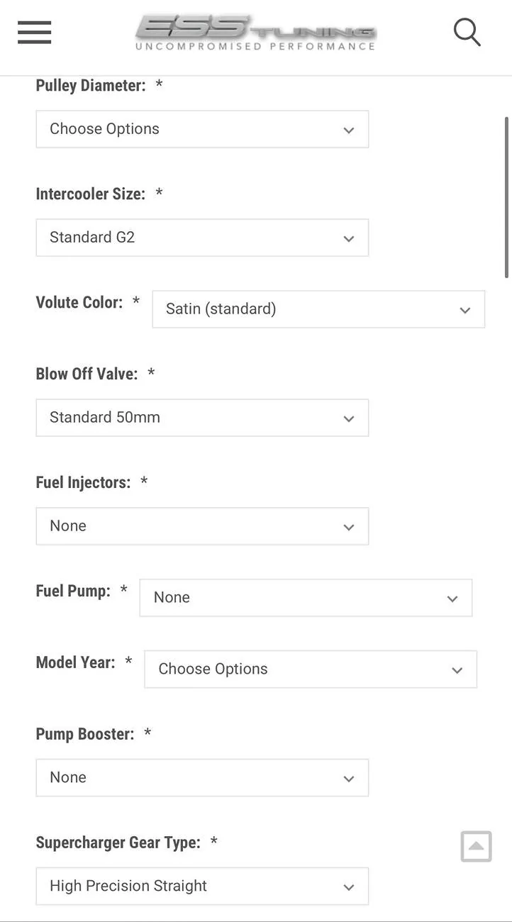

I'm torn, thinking of the G2 (laughs from the crowd) since I don't plan on big numbers. I want something that continues to handle great, has great brakes and still makes 600rwhp+.
I figure I can always go E85 at some point if I want to run quicker at the drags, but I just matched the G2 and the G3, and the G2 with the G3 intercooler is only about $600 less than the G3 with the identical setup, since the G3 comes with the G3 intercooler already.
I should go with the G3.
Will they make the same power with the same size pulley, or does the G3 make a tad more based on the impeller?
