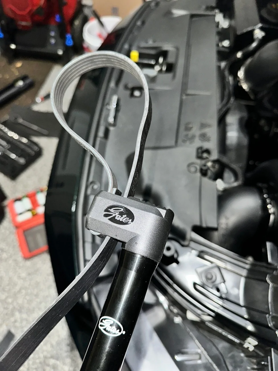

Do you mean this? It holds the pulley while you loosen or tighten the main bolt, which you’ll only have to put one once because with the griptec pulley it slids over the shaft
