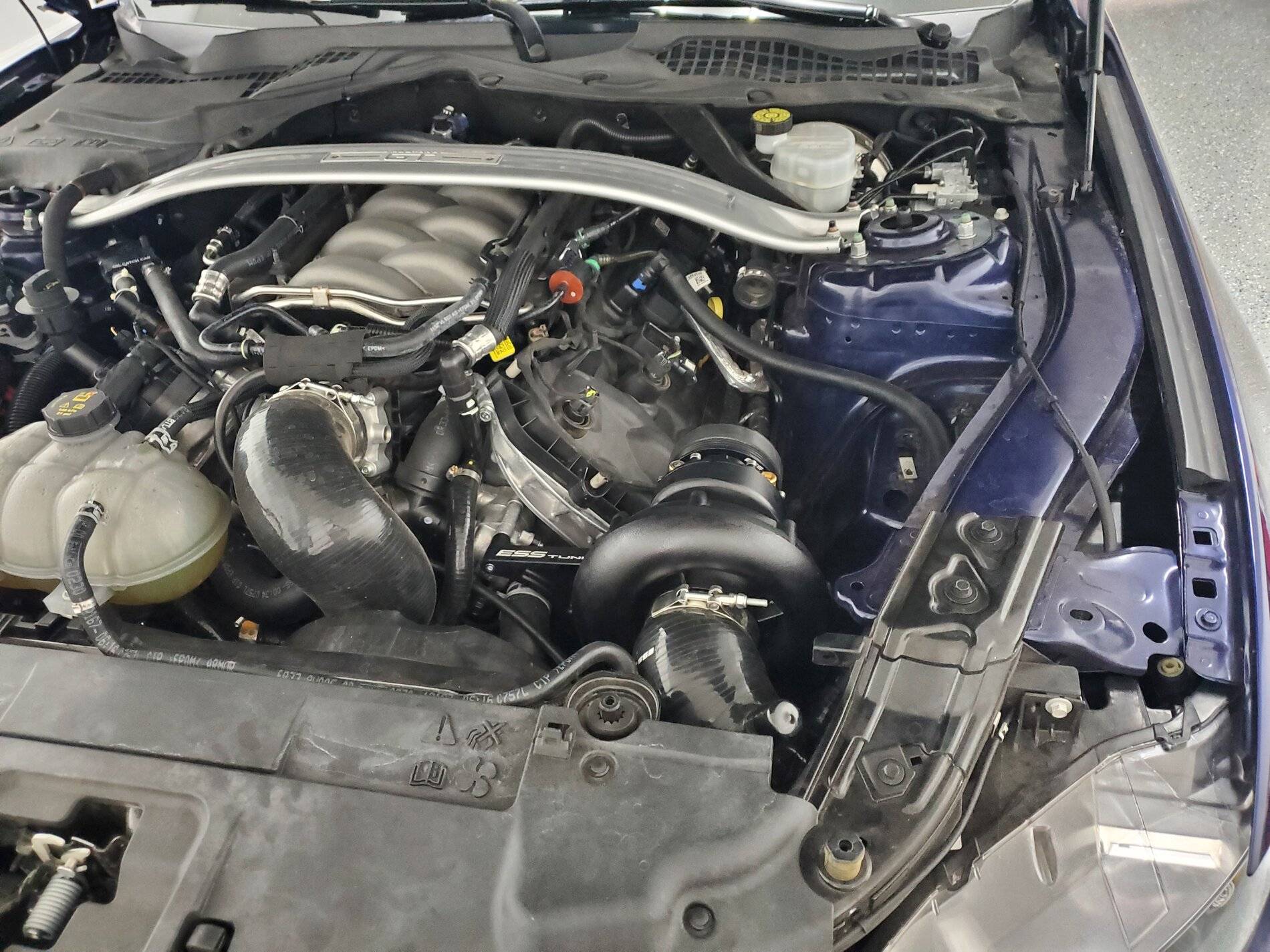

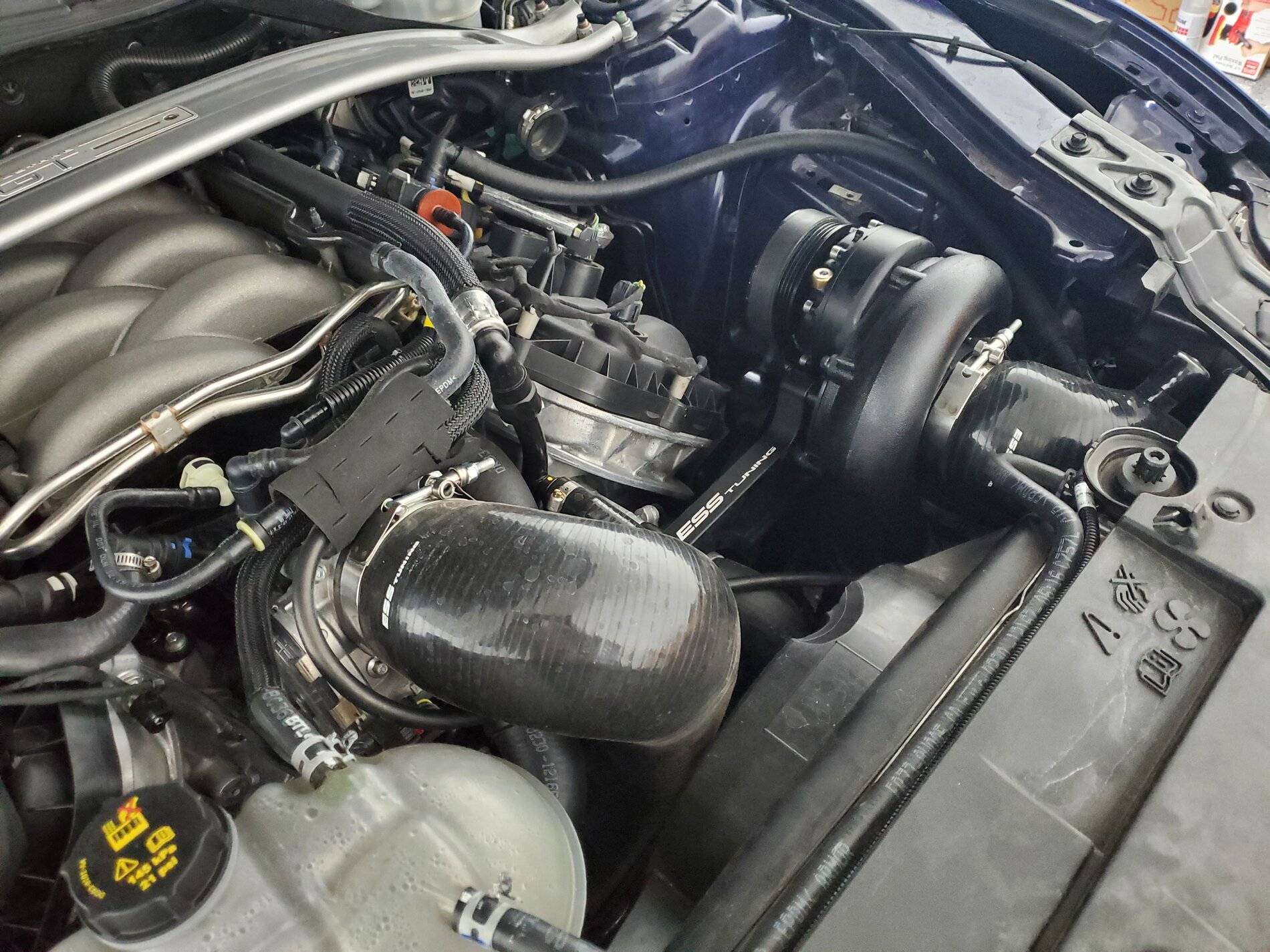

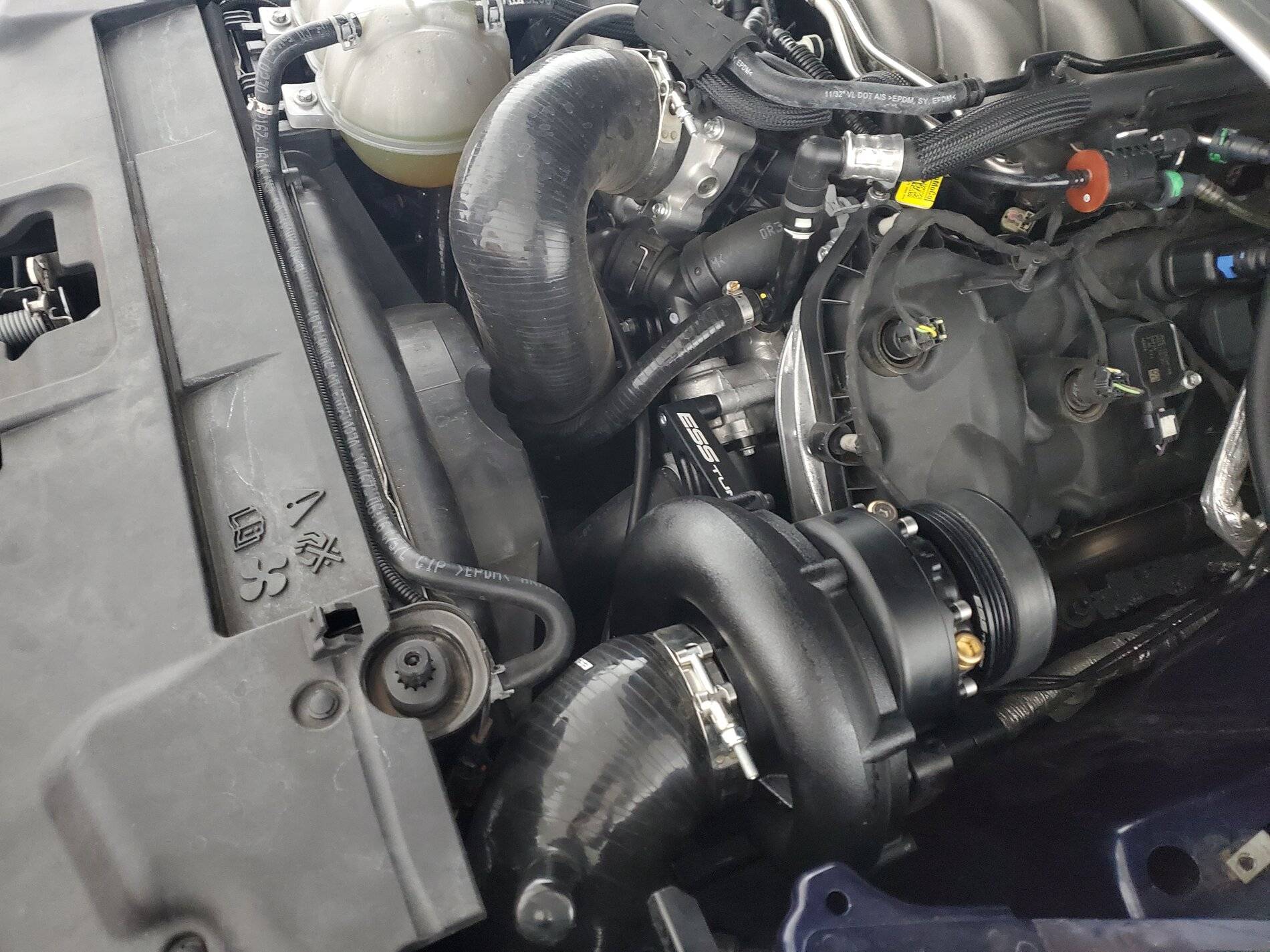

Ordered my kit Friday!! G3 with 7.5 pulley , loud gear set and black blower.
it’s going on a 18 10r80 gt350 manifold , 87mm tb , LTH headers. I’ll be running e85 and low boost.
I was thinking about painting the blower black. Post pics when you get it!
