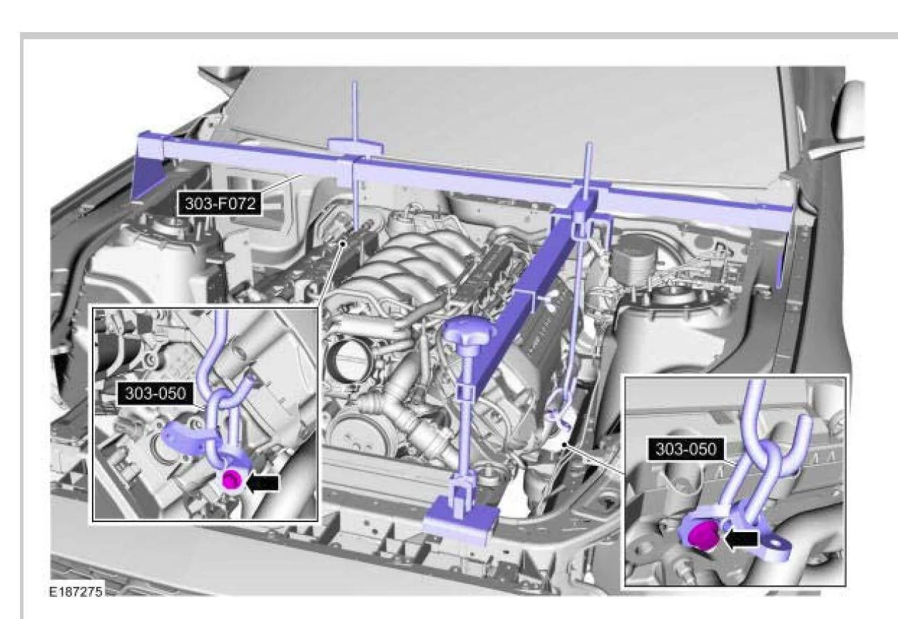

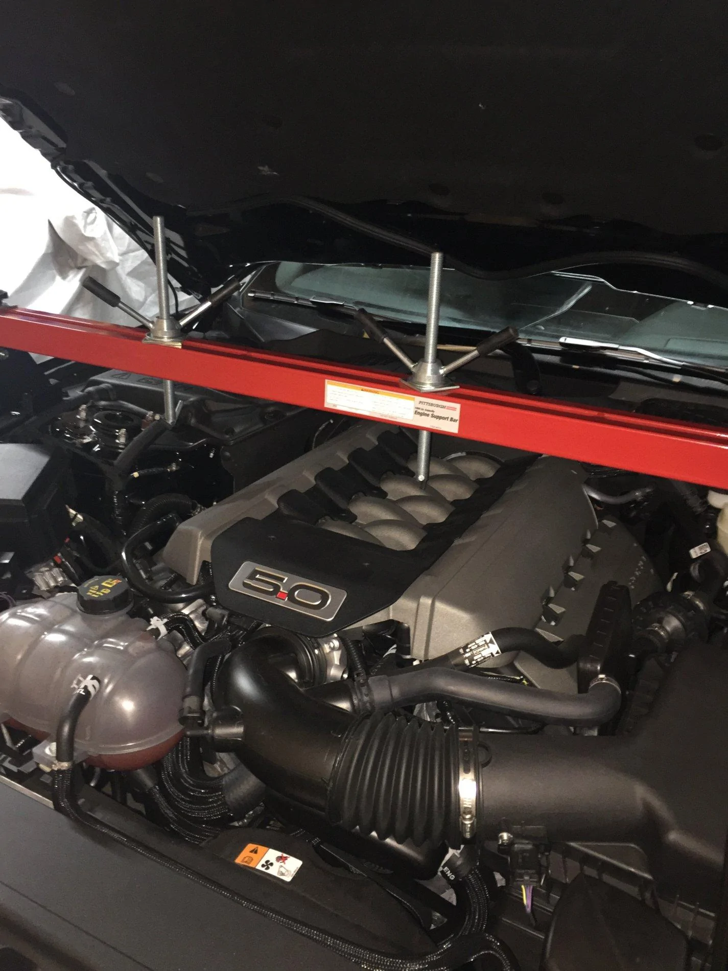

i got an engine support bar but trying to figure out where are all of you hooking the chains to on the motor to support the engine?

There are probably lift rings under the cover at opposite diagonal corners. They may be buried deeper than just under the cover.

The 2019 service manual shows that the intake manifold is removed and the lifting brackets are bolted to the engine where the manifold was. I would not try to do any of this without the service manual, a 36 hour subscription is only about $30.

Never mind I found it. Not the best location in the back though.
