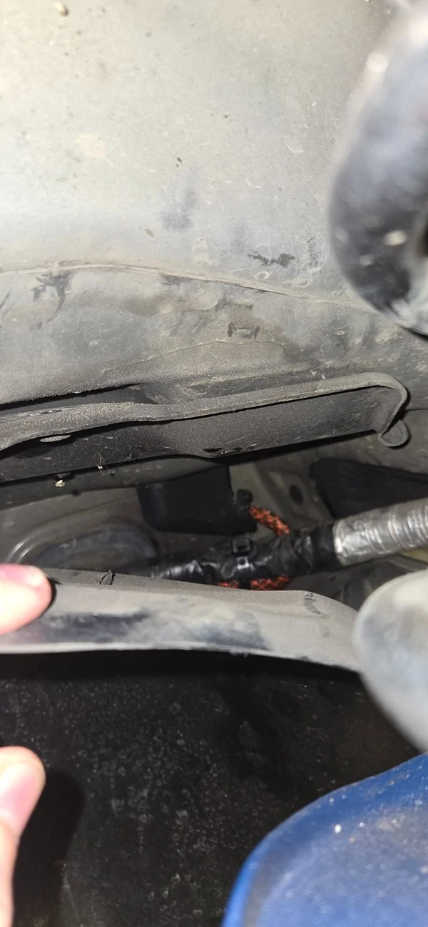

Some videos i saw mentioned this piece is underneath and accessed thru the fender liner. i dont recall seeing it when i was looking for the nuts originally.,.. there was no other hardware securing anything thats forsure...

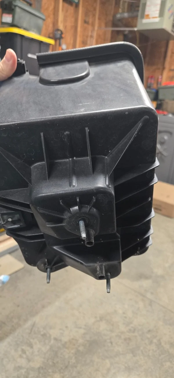

and put them inside the holes in the picture below.. but it doesnt do fuck all as the nuts arent welded to the metal below.

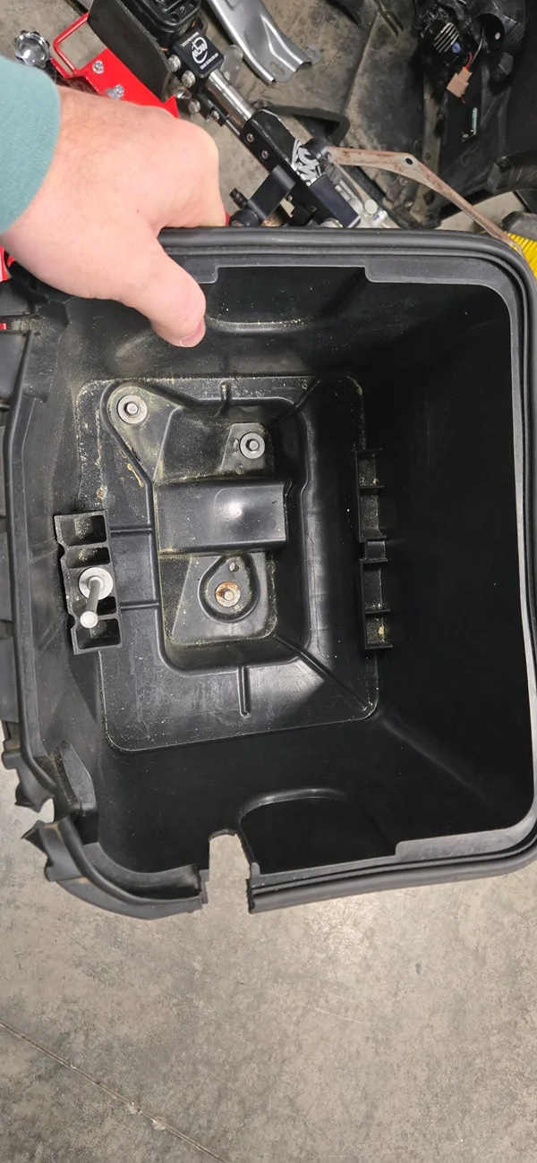

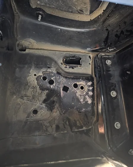

Picture below is what it looks like once the plastic battery tray is removed..

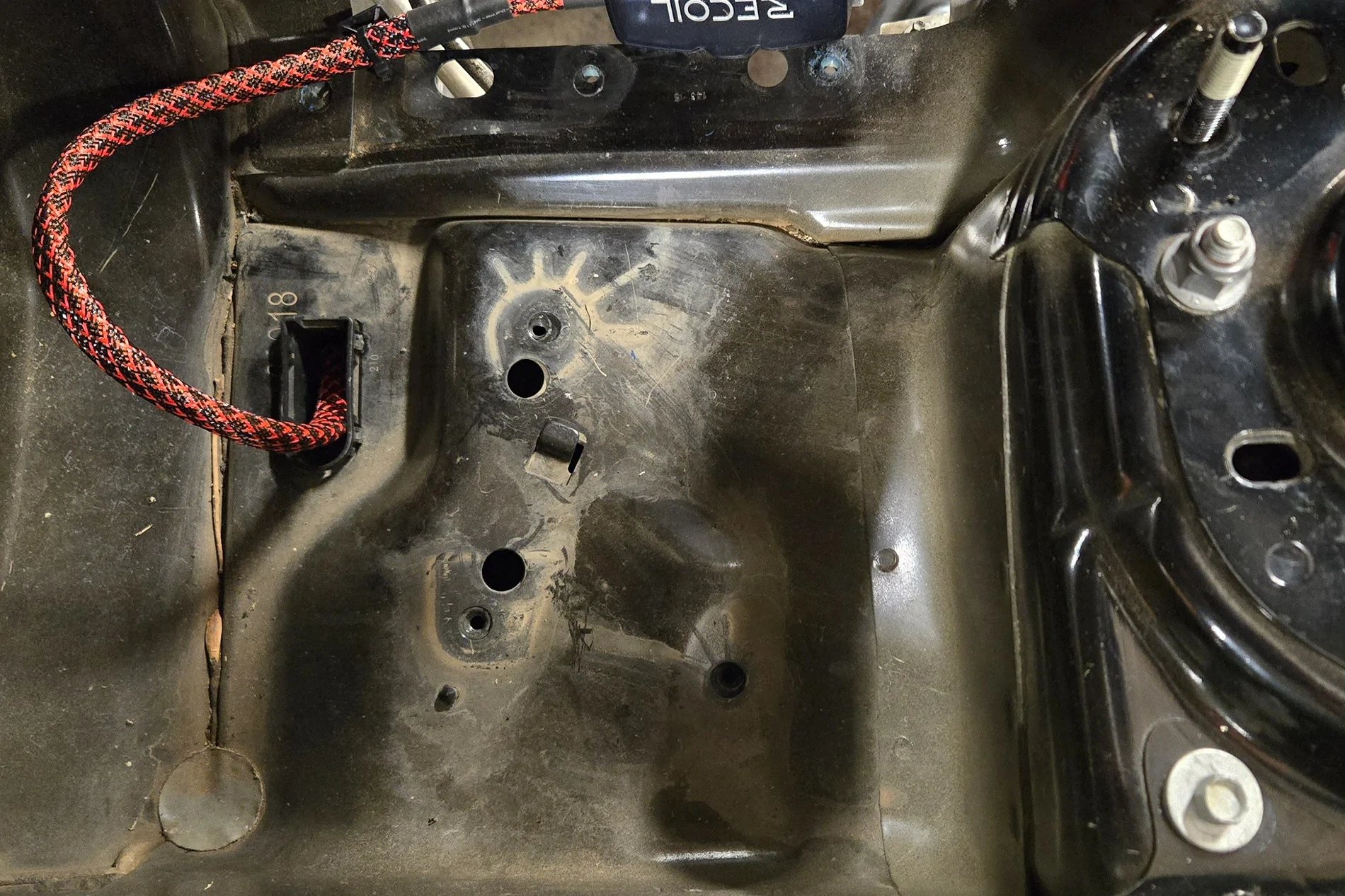

I took some pics this morning of my car, as it was apart.
I think you need to pull your inner fender liner and look for the support plate.
It looks like it only hangs there in its place by the single metal bent tab.
I am guessing the whole plate fell down into the inner fender.
Either that, or someone rigged up some loose nuts under there at some point.
Regardless, the support plate goes underneath.
Hope this helps.
