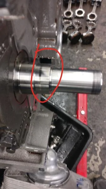

The only culprit the technician found was where the oil pump assembly and the crankshaft meet. There was scoring on the crankshaft and metal shaving littered the inside of the pump and the oil filter was filled with metal shavings.
