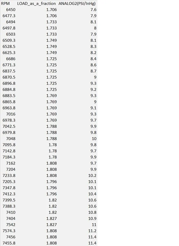

Here is some condensed info off of one of my last logs. Lund, Ngauge, Boost+

How accurate is that i see wheir1.808 of load comes to 9.9 psi boost then a little higher in the rpm the same 1.808 of load is 11.4 psi of boost.So does it use load and rpm for this formula?

Engine load will not be directly relate to boost where when one goes up so does the other.
Load as a fraction and load as a percentage are you absolute load. One just isn't multiplied by 100% and left as the result of the fraction (air mass)/1.183(air mass)*cylinder displacement.
Air mass is the weight of air that got into the cylinder before the intake valve closed. Boost would be a function of MAF and what didn't get into the cylinder and remained in the manifold. Because the coyote doesn't have a MAP sensor this would be logged as inferred MAP. Not sure if the Lund ngauge had a manifold pressure gauge I would need to look but that's what you would want to be looking at.

If you want to know load, log your load....
If you want to know boost, log boost with an outside source.
(and one that does an offset for BARO)
