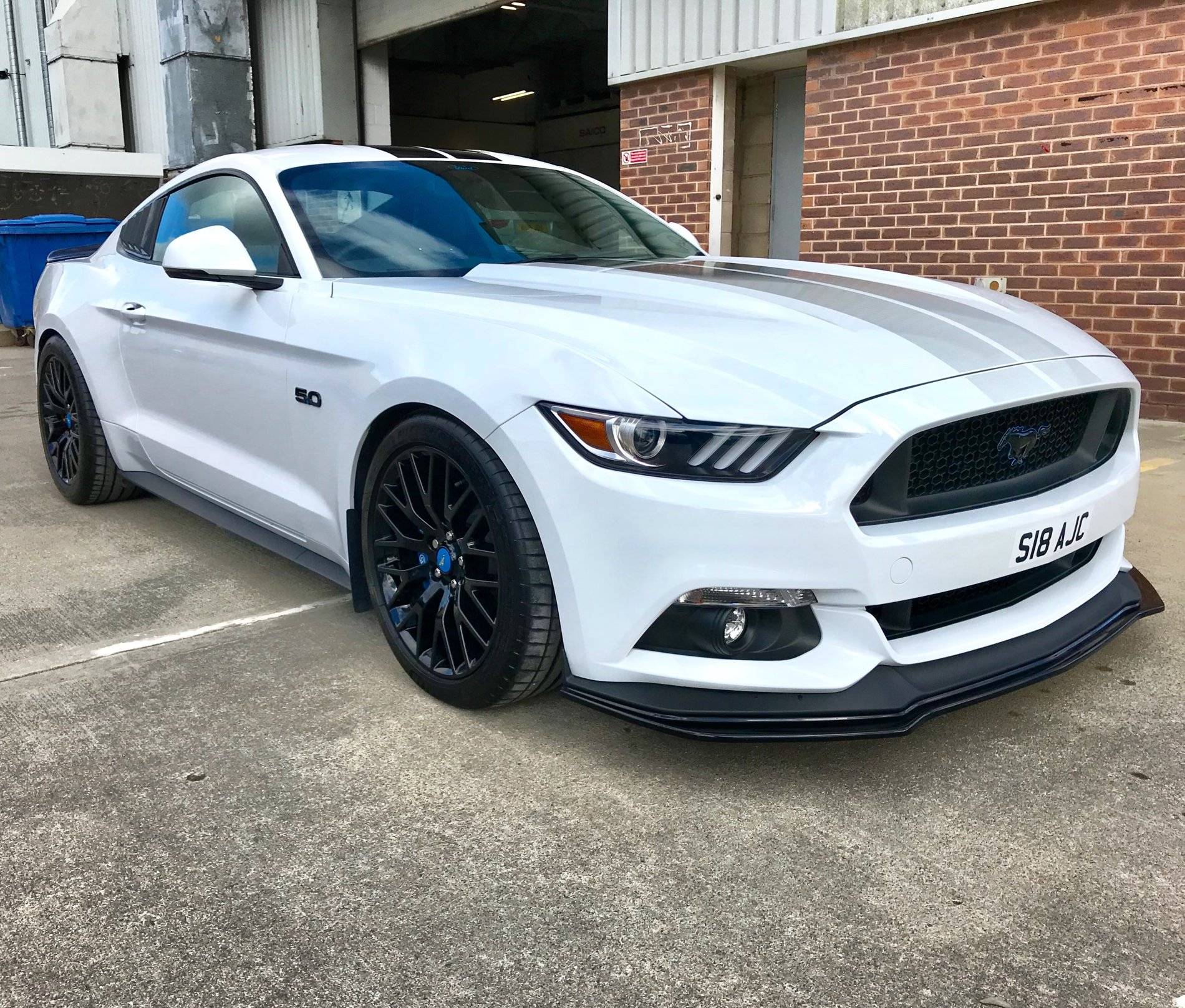

I’ve also got the Ford approved eibachs, still a nice smooth ride, no harshness or bounciness while driving and much improved stance, even with the Maxton Design front splitter I’ve never hit a speed bump :thumbsup:

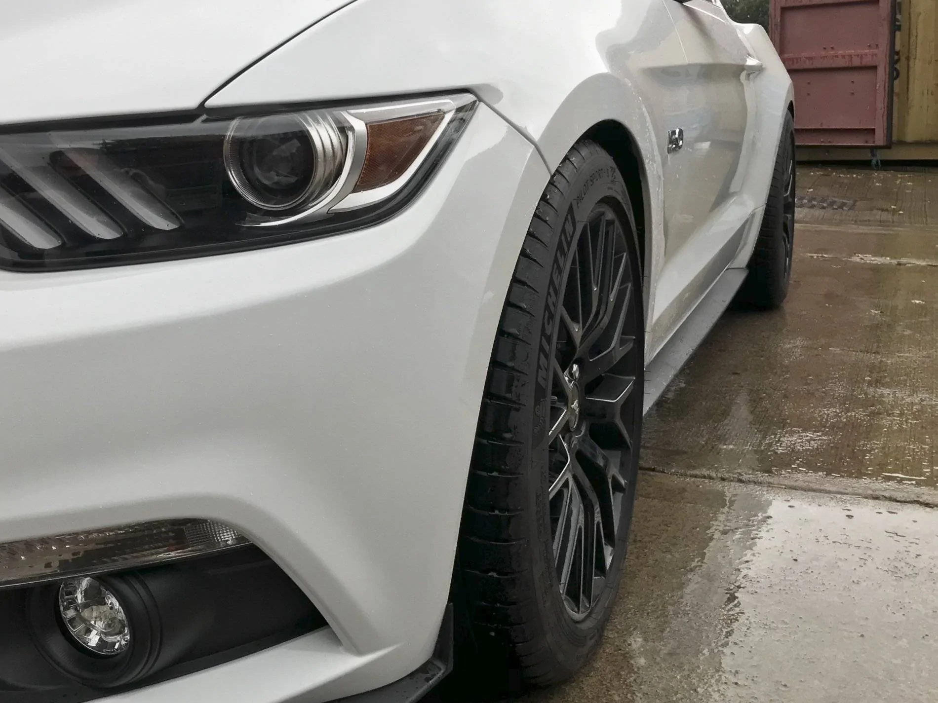

25mm spacers all round seem to be the ones if you’re running Pirelli’s still but I went with 20mm items as the Michelin’s have a wider sidewall, I have heard these catch a couple of times on the wheel arch liners at the rear on big bumps in the road so glad I didn’t go for the 25mm ones as it would be like back in the day of when I had a Vauxhall Corsa lowered like 100mm on 17” Wheels! Scrub city!

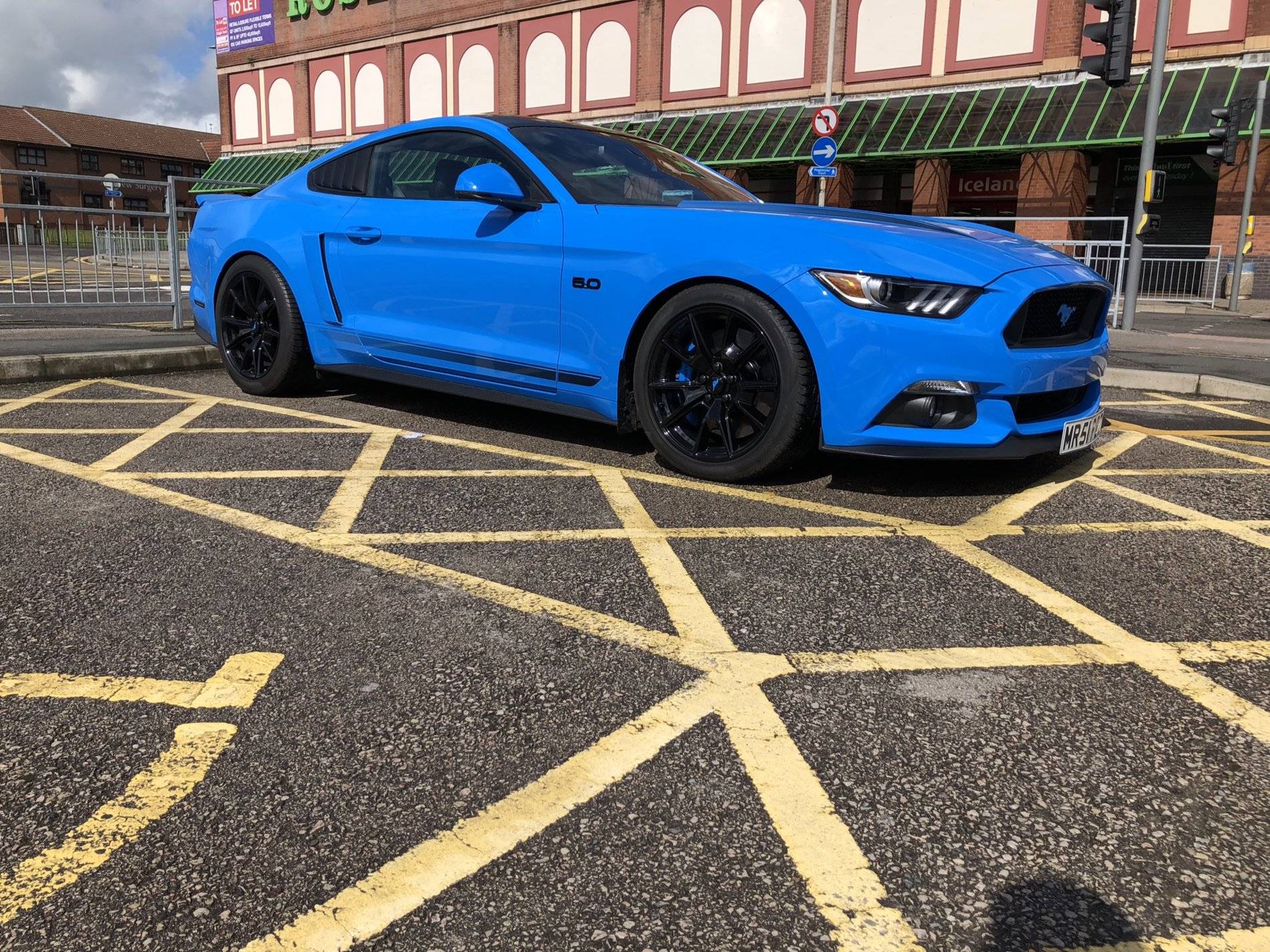

Loads of photos of mine on the magnetic photos thread.
i have 20mm on the rear, 23mm up front. It’s perfect imo with the stock wheels and tires. Always get a lot of compliments...
25mm on the pro kit springs does mean the tires poke out just a touch, depends where you stand really. It matters to some not to others, but i’m very happy with how mine sits.
EDIT: worth highlighting that anything thinner than 25mm spacers, and you'll need to trim a few mm from the end of the studs. GT101 did mine.
