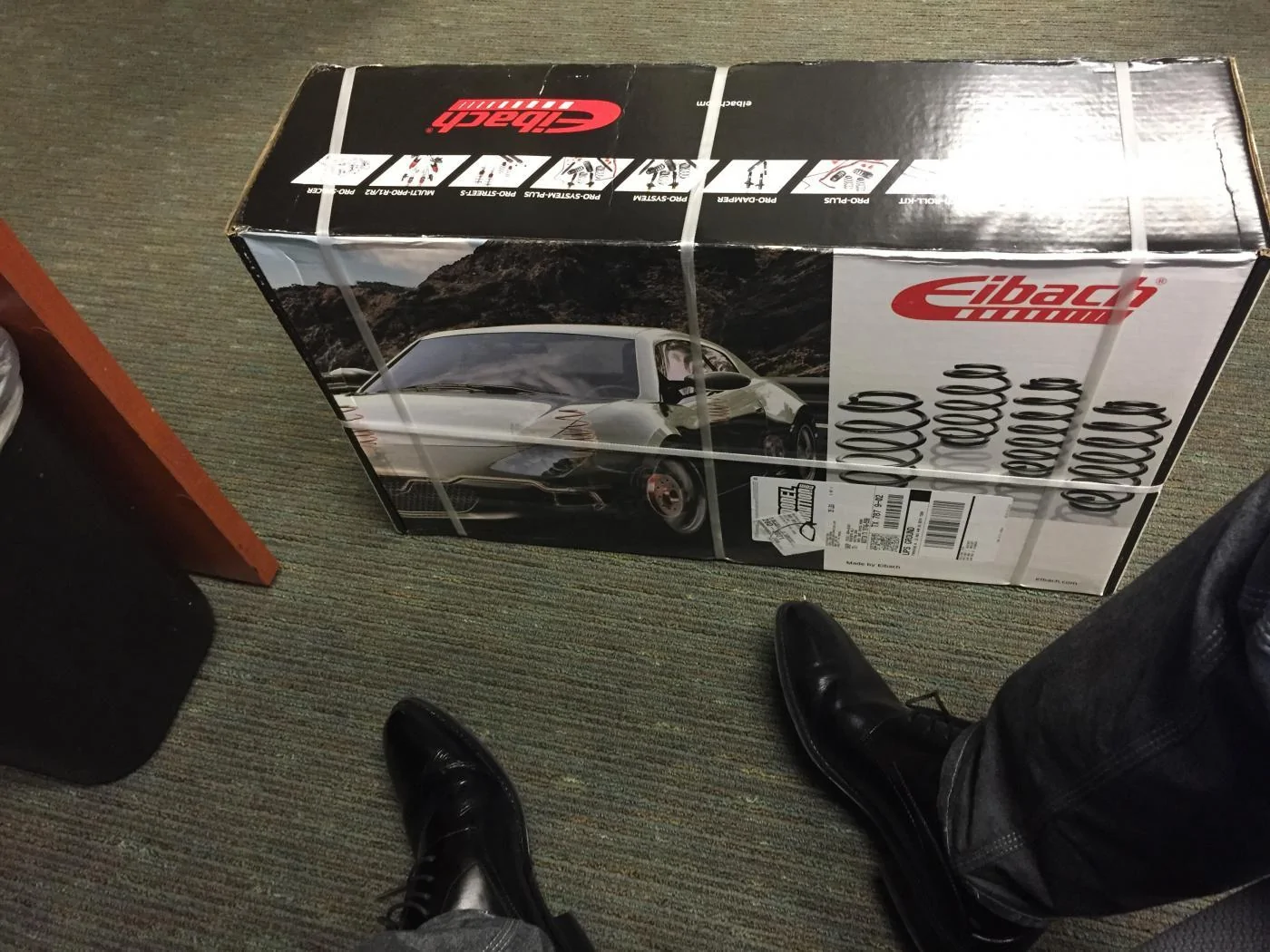

So my eibach prokit springs just came in as I am at work. I was initially planning on doing it myself but due to the lack of place and tools, i was leaning towards getting it done at a shop.
The one shop I found is charging almost $400! Looks quite expensive. Does anyone know anybody who can do it/good shops in Austin/Houston TX that are more reasonable?
Much appreciated!
