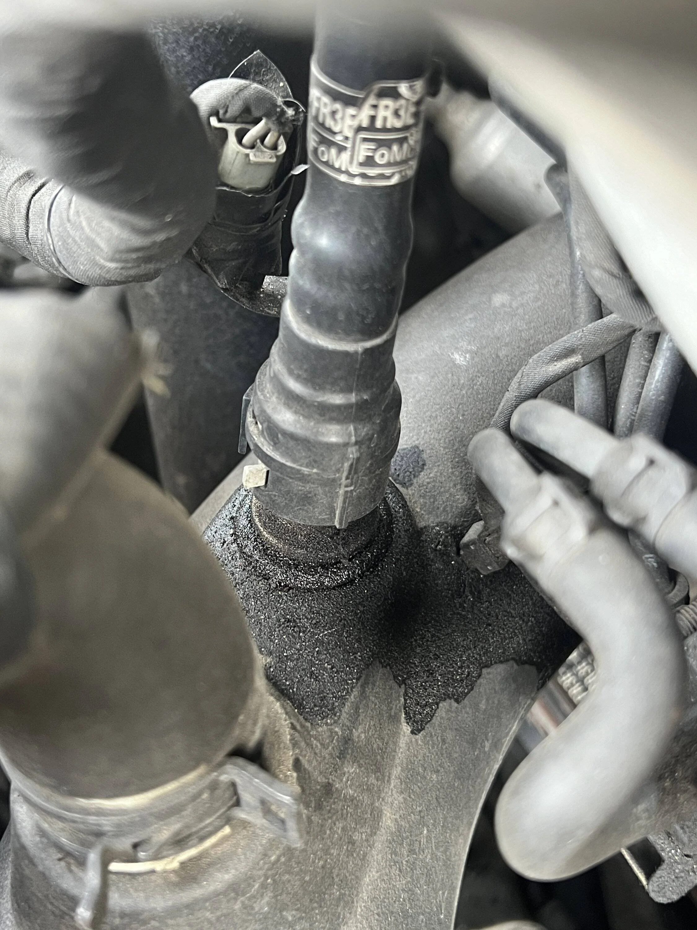

Hey guys just have a question if anyone ever experience this before. I have a airraid coi on my ecoboost, and from one of the connections it’s leaking of spilled some oil. Anyone know what this could be?

Can you provide a better pic from further out to see exactly where that is located on the engine?
It could be just a bad o-ring or that end of hose needs to be pushed down further onto the nipple.
If it were me, I’d spray down the area with some EFI cleaner, use a micro fiber and wipe up the area and hose that was sprayed down and monitor it to see how bad it leaks OR if it takes a while to accumulate again.

Simple, replace the hose.
