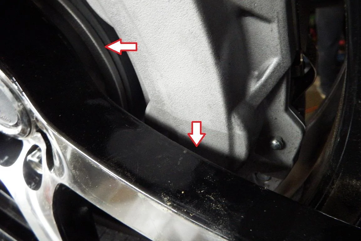

This one didn't work we had to change them:

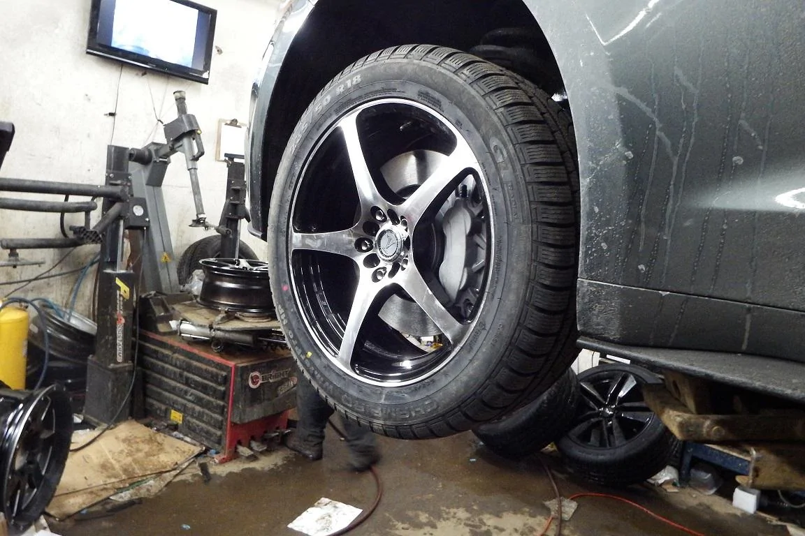

This one did work but we had to use 5 mm spacers:

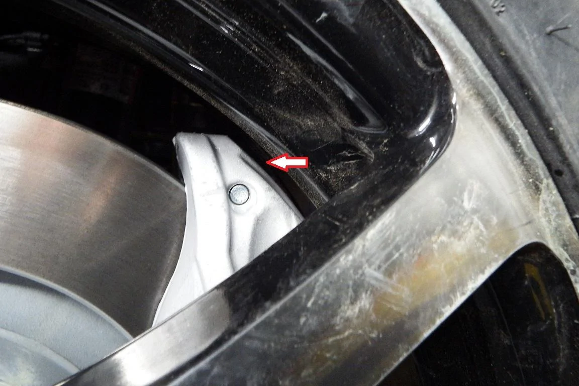

You can see the spacers and the clearance in front:
and around the caliper:

You getting really far out of the open window to fall down! My tire shop said that too and I did ended up bringing the set back what they believed would fit "300%"! They than started to check every 18" wheel they had and only two did clear the front caliper. Period. Saying that basically every 18" would fit is not right. FYI.:cheers:
