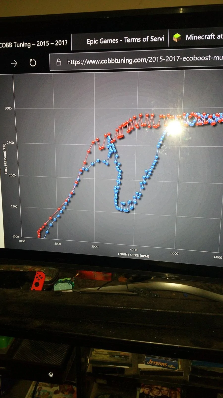

I noticed on COBB's website in the FORD Mustang ecoboost BLOG they found a problem with fuel pressure in ford's matrix software dropping under load around 3000 rpm to about almost half what it should have been, anyway I was wondering if that could cause LSPI and maybe ecoboom or be related.
I didn't see this when I searched the forums.
RedSled
Sep 7, 2018
KC MO.
Cliff
2017 PP ECO
Cobb found this just a few months ago and has revised updated software to load onto the access port if you do a update.
The red line is the update, and the blue line is ford's original.

So is the fuel pressure drop to 1600 psi to much at 3500 rpm causing a lean condition AFR wise.

I'm not following this. The LPFS many are concerned with is a low-pressure fuel sensor. This graph is depicting high-pressure fuel. What would the LPFS have to do with this?
Well, considering that the High Pressure Fuel System gets its fuel from the low pressure rail...an inadequate amount of fuel in the low pressure rail would lead to an inadequate amount of fuel in the high pressure rail. The HPFP has to get its fuel from somewhere...

I thought it was a sensor issue, not actual low fuel pressure. Is that incorrect? Assuming actual fuel pressure is good, how would a low pressure indication on the low side result in low pressure on the high side? As far as I know the ECU does not manipulate fuel pressure, it's supposed to be held at a constant value by a pressure regulator.
The HPFP is electronic too, there a command value the ECU gives and the pump tries to maintain, follow.
Check this aftermarket pump diagram as an example
https://www.livernoismotorsports.com/product/LPP501115
Also as I mentioned if you have a secondary pump way upstream (engine compartment) and your low pressure cannot handle the flow to keep up with the HP it can give issues.
I am not saying this has anything to do with OP, I don't know.

So it appears the PCM will boost the low-pressure side to compensate for low-pressure on the high side, but I don't know if the PCM will cut high pressure to compensate for a high-pressure indication on the low side. That still wouldn't make sense to me since I believe the PCM controls mixture by modulating timing/duration of the fuel injector operation. The only way that would work is if fuel pressure on the high-pressure rail is held constant.

In my link, it was just a graph showing the command value rate and the HPP value of the stock vers there HPFP. To see it click the product info tab.
I have nothing to do with them, there were also posts in this forum showing it but I didn't find them easily.
I guess there a lock-up table for low and high pressure and ECU will vary and try to compensate where it can.
But under full load, the HPFP does seem to have problems keeping up with modified engines.
