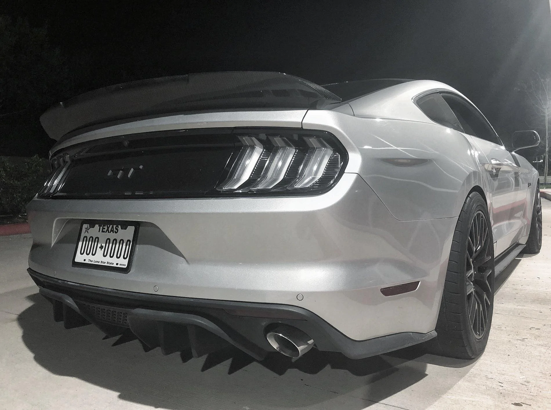

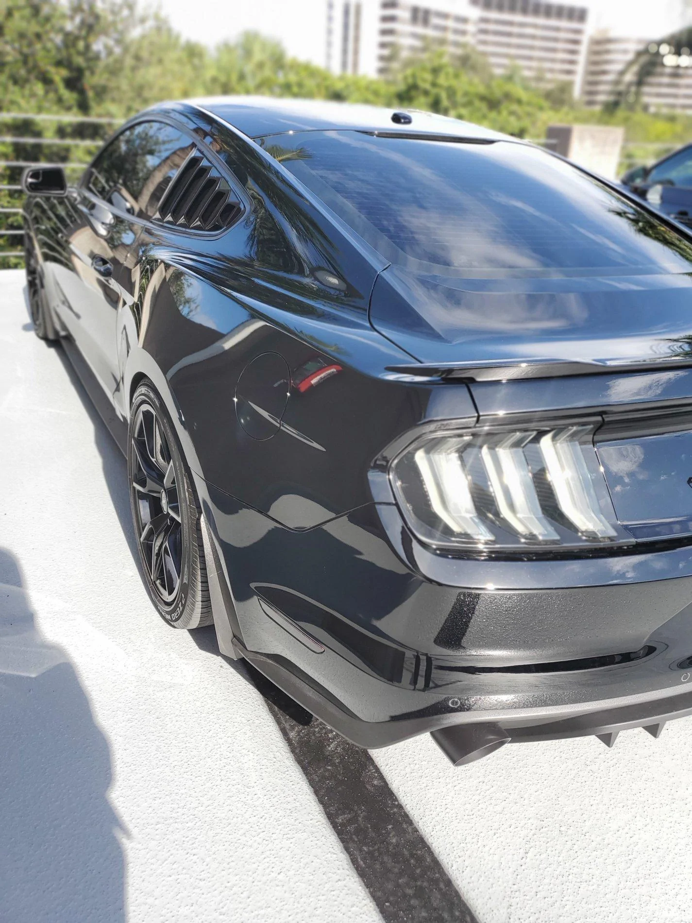

S550euros quoted me 795 , after doing some research i figured they were selling vland. I found the 2 mode vland version on ebay. Seller had them listed at 468 and i made an offer and he accepted. Package was delivered in 4 days
Do you have more pictures! I have a black mustang also and this looks stunning. Just need more angles.

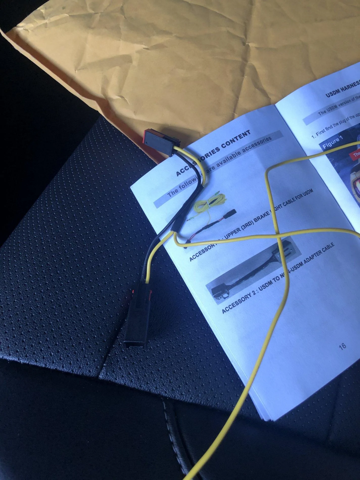

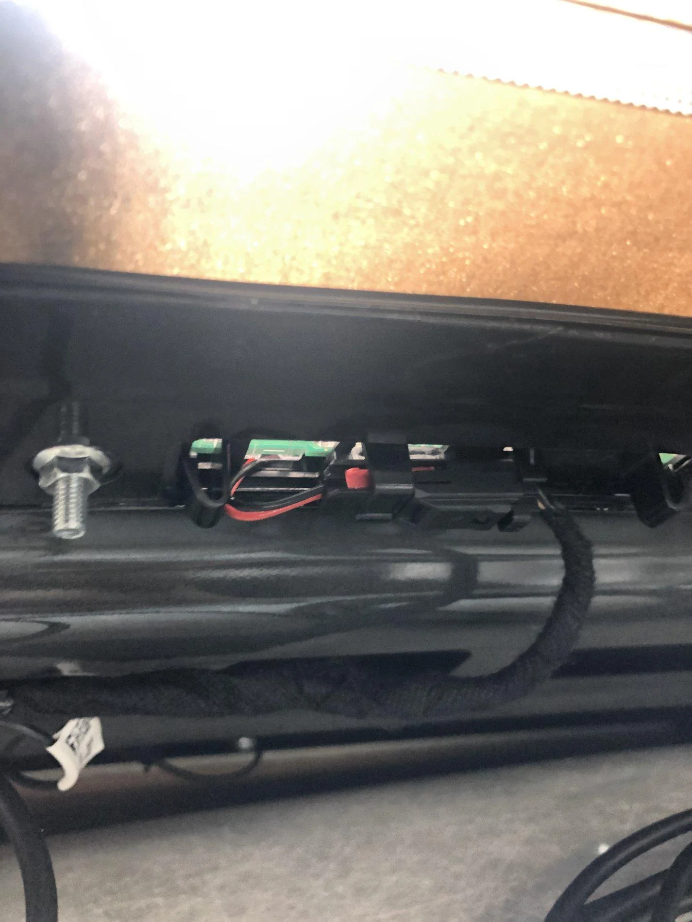

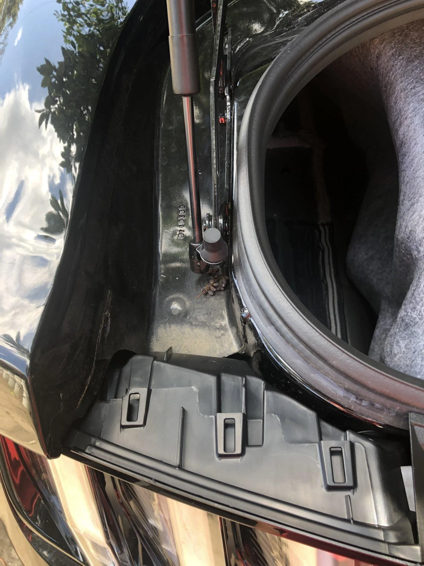

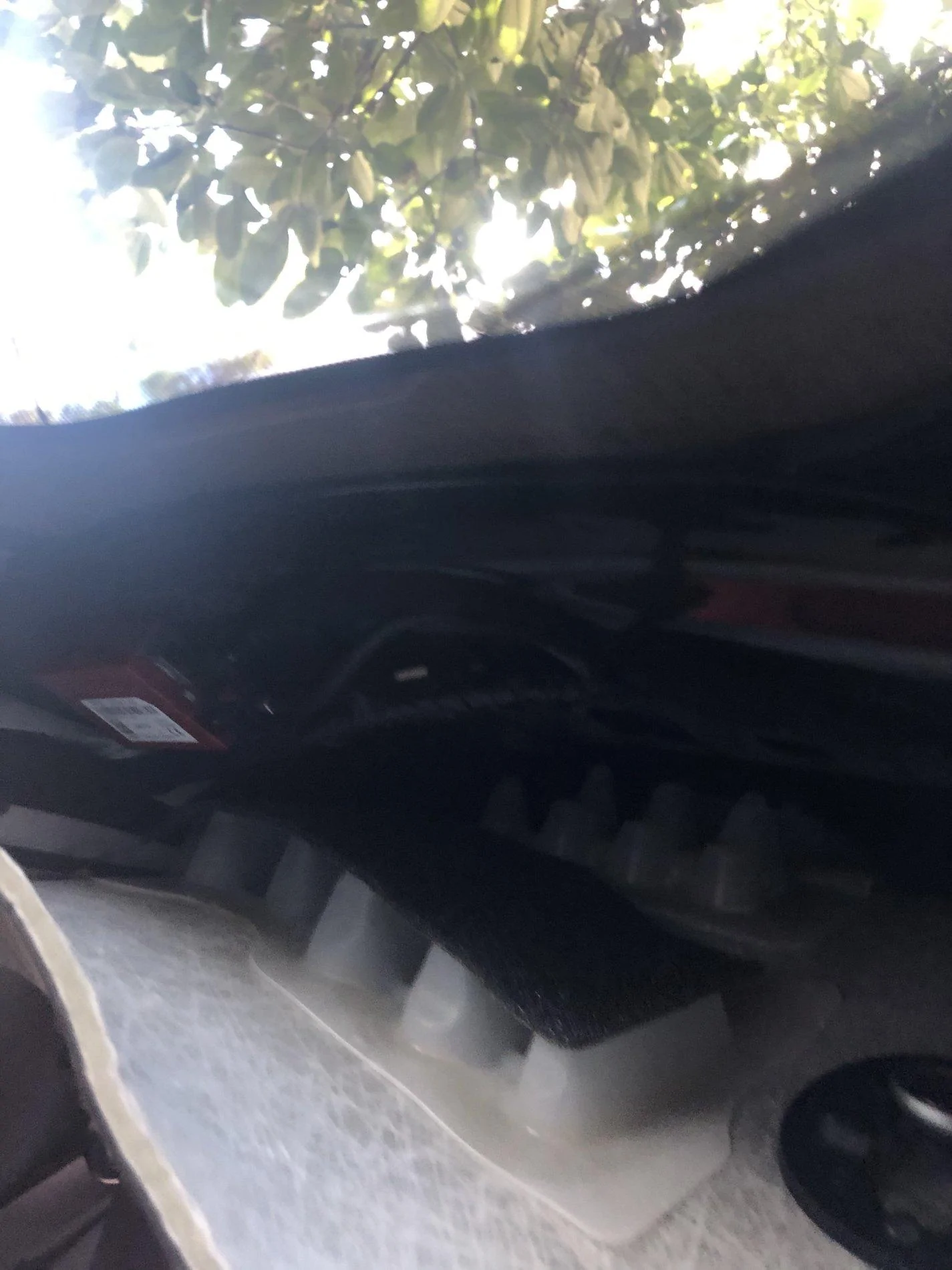

Thanks I understand this but idk exactly how to attach the piggy black plug. Like how to connect the black plugs to the third brake light, there's 2. Somehow I got all the way here. Installing it was easier than imagined.
So like right in the middle what exactly do I do? Am I supposed to connect anything to that red box thing? Also in the image of the trunk is there supposed to be something on top of the taillight to block off water from running in?

So there is an original wire that you have to unplug from the 3rd brake light. I believe you press on it to release it from it's socket. The wire that you unplug goes into one of the sockets on your wire that is coming from your tail lights. Then the other end plugs into the 3rd brake light itself.
Ignore the red box.
Also, that's just how the 2018s are made. I also noticed it too when I tried to put my old tail lights in, it had a different shape on top. (15-17) back into the box that the euros came in. They wouldn't fit.

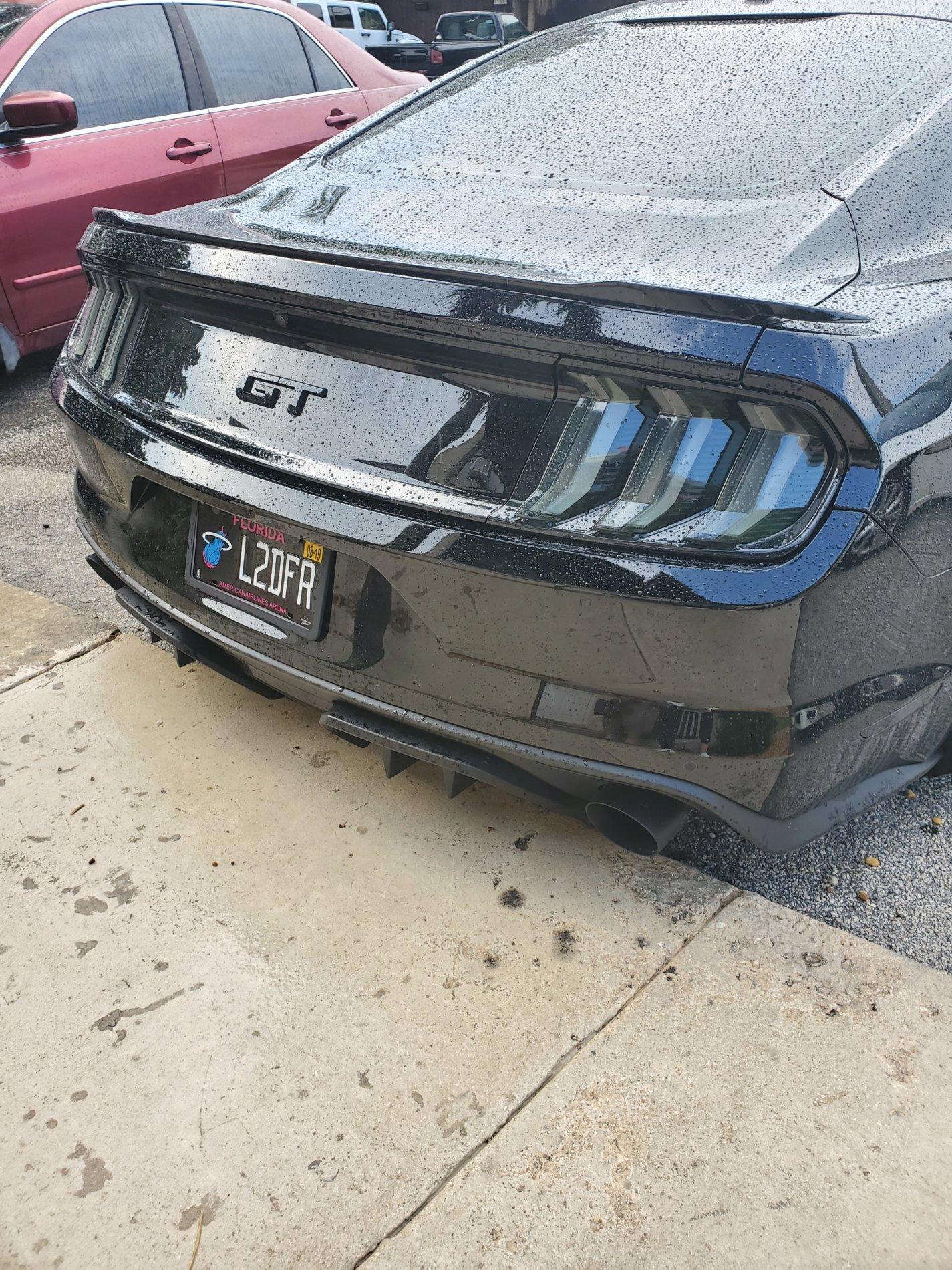

Here is how it's supposed to hook up.
Also a bonus picture of the tails

So nothing should be removed
But look at this ebay listing for reference of an OEM light
https://www.ebay.com/itm/2018-2019-...845104?hash=item5d90c5de30:g:aoMAAOSwPRldUIdm
It has the same design on top. (4th picture).
So nothing goes into the second picture I posted right? Sorry. I'm really starting to doubt my reading comprehension.
The two black ends of the yellow wire: One black end goes into the red box thing (into the socket) and the other goes into the wire you just pulled out, correct?
Edit: Just saw your picture! GOT IT THANKS!

Jban100 You have to reuse the tops of your factory tail lights. They just clip on. I was confused by that when I first saw it myself.

Don't forget to transfer the clip from the trunk side of the lights to the new tail lights. it is on the back where the textured panel comes to a point it hooks to the bumper cover.
