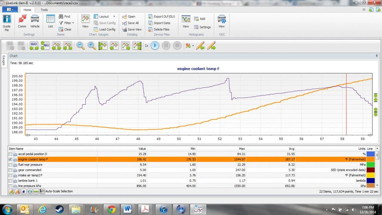

Here is a datalog from the track. It begins with me sitting at the tree, after doing a burnout and getting the car nice and hot. It was 189 at the tree. It went up to 198 by the end of the 1/4 mile. While driving around, my temps are 185-187. If I had time to let the car really cool down, I would have started with a colder temp. I am struggling to see how a 10 degree colder thermostat is going to really make more power. I would like to see empirical evidence of this.

I have never been a fan of cars that ran hot. However, I would still like to see some actual proof that your thermostat results in more power. You guys have a dyno, you have a car. How about you test it and provide real hard data? Get the car up to operating temp with a stock thermostat and do a pull, then repeat with your thermostat. Post the dyno graphs. If there is a difference that is more than negligible, you have proven the value of your product.
I will buy one if it does something as I am looking for real gains for my car.
