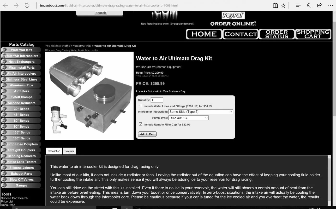

Use a cold can in spare hole put pumps there also, no coolers to mount easy line routing, just add ice every time you fill up, let pumps run for cool down between sessions. Might be cheaper also.

Ice can wiith 2 circuits $400
Few minutes searching found this

Well, that's an idea. Not sure I would call it easy though. Seems easier to me to add FP coolers, lines, pump and be done with it, forever, without having to add ice. This is also meant for drag racing, to cool during and after 10 second passes (or less). During a 20min track session the ice may be gone in a minute, who knows.

Those are designed for cooling the intake air on drag cars. They only need to cool from when you drop the ice in until you get the car off the line. They're meant to be very very temporary - as rb92gt said, a 10 second pass or less. The moment that ice melts they will start adding heat soak. It's a glorified temporary version of a water to air intercooler - for intake air, not transmission fluids.

its an idea, seems putting radiator up front all the parts brackets, same with diff is a lot of work and expensive. This would be 4 lines to the drain fill ports one switched wire some holes in trunk done. maybe there is not enough thermal capacity in the ice. I'm just thinking how small the cooling coil in a radiator is for a automatic tyranny. If somebody made the trunk kit for you would be done in 2 hours and no shop full tools. my guess there is enough cool in 3/5 gallons of ice water to make 30 minutes on the track and not boil. Hell I'll bet there will ice left over. What need is some spec on BTU removal on the air radiator FP uses then we can get idea of output from tyranny. Remember the latent heat of water to do phase change is very large. Even if boiled the water the temp would be ok for tyranny oil. Limp comes on at 293'F. Remember they trying to cool air and air is hard to get heat out of. I was watching street racers and they were making multiple runs without a change in the water. I don't we talking that many BTU's coming from friction heat.
