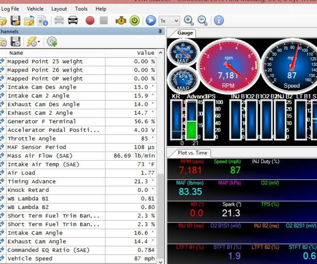

Good reason to run e85. This is with 15psi. Got spark?
