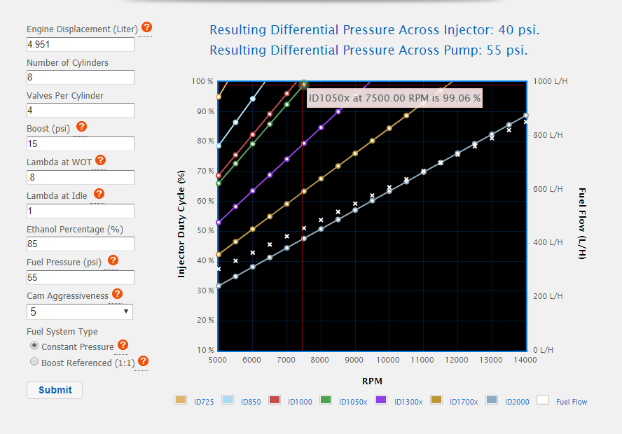

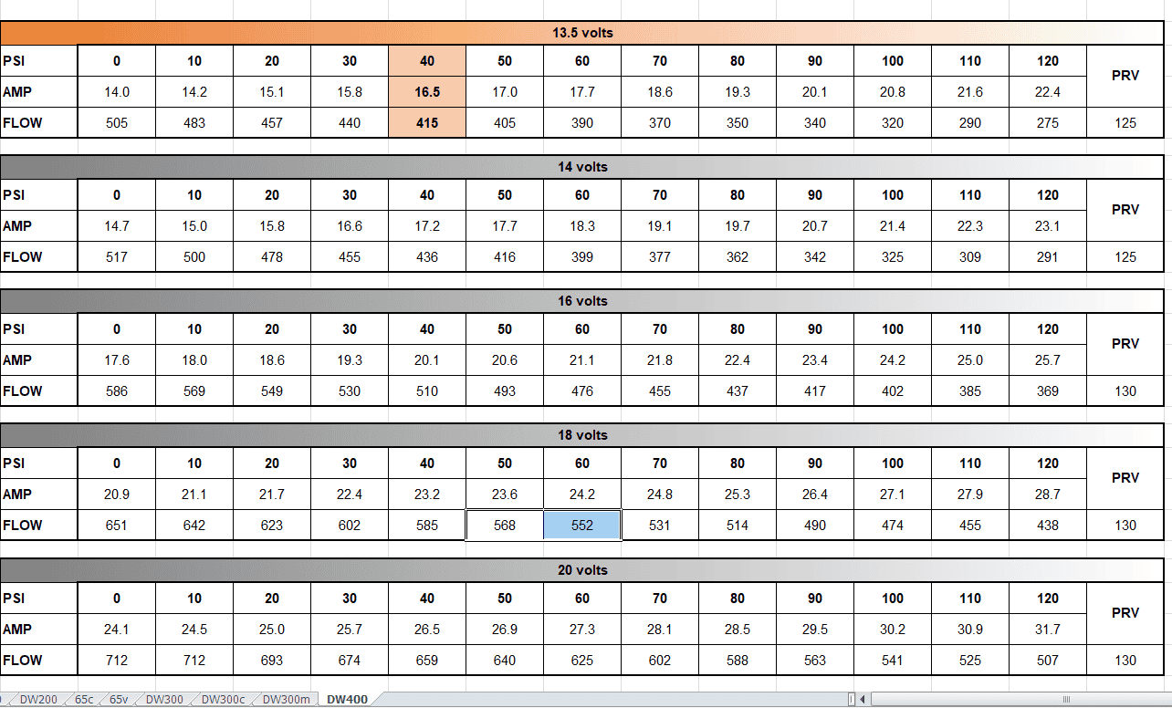

The data says a DW400 and Voltage booster will flow enough for E85 (560L/H). It's the small stock feed line and 1050x injectors at only 55-58psi rail pressure that you can't trust above 13-14PSI on E85. The 2020 gt500's are at like 100PSI or something crazy from what I hear (it would be the limit of a DW400/VB). The return systems allow a lot more rail pressure and these injectors can be stretched to higher RPMs. If you are running a 1300 or 1700 size injector, E85 on a DW400/VB is possible, just not as confidence inspiring as a true return style system with dual or triple pumps. I would probably also just upgrade the feed line to the largest you can and not choke the pump. The other thing to consider is, are you going to get 25+Amps to the pump through the OE wiring and grounds? It uses a 30amp fuse.
