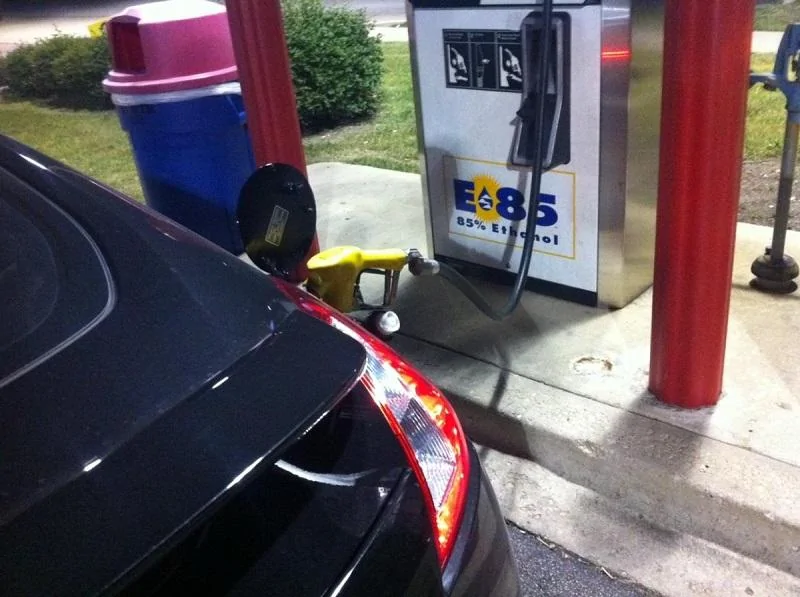

I have no pics at the pump but just got my e85 tune dialed in. Running 15lbs on the stage 2 with D1, about 20 degrees of timing. Pulls hard.
