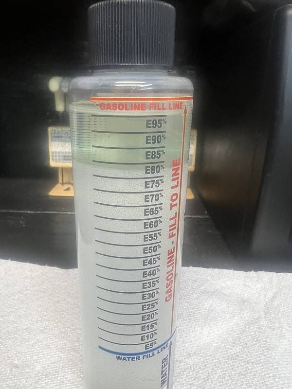

Get the E85 app and read the comments. Some of these stations don't have nearly close to 85% E. I have a Procharger D1-X with Fore Innovations fuel system and only run E85 so it's really important to have a station that can provide over 70%.
I also bought a $13 tester on Amazon to see where the ethanol level is. I fill up at the same station, over 70% every time.
Untitled by jpjr50, on Flickr
