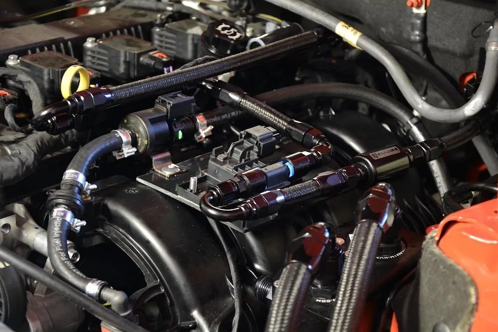

Picture below shows the prototype system. From the picture the following will be changed:
-Line and fitting routing
-Mounting plate (will be 3D printed when finalized)
-Mounting Hardware

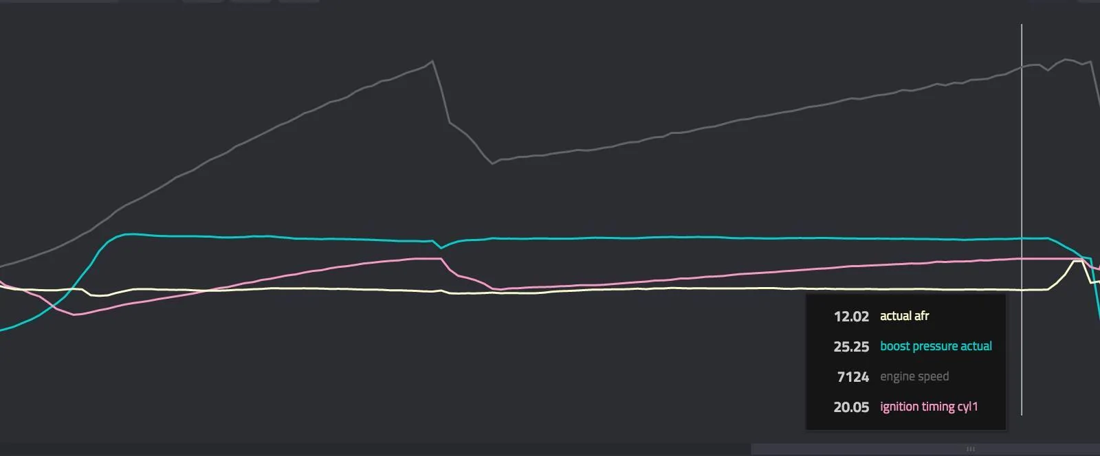

Initial results, which based on the many other cars I have tuned should put me right around 500whp.
