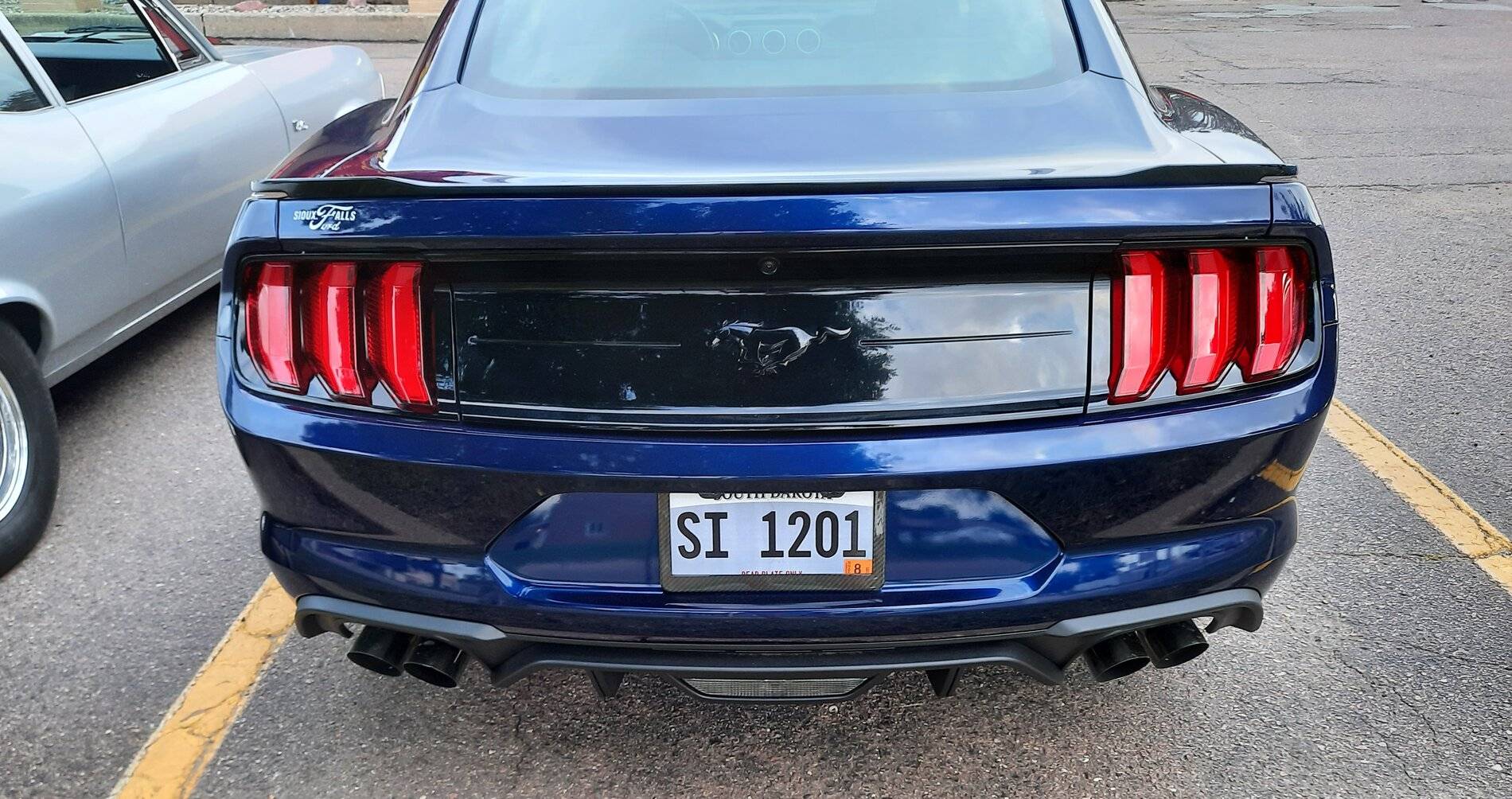

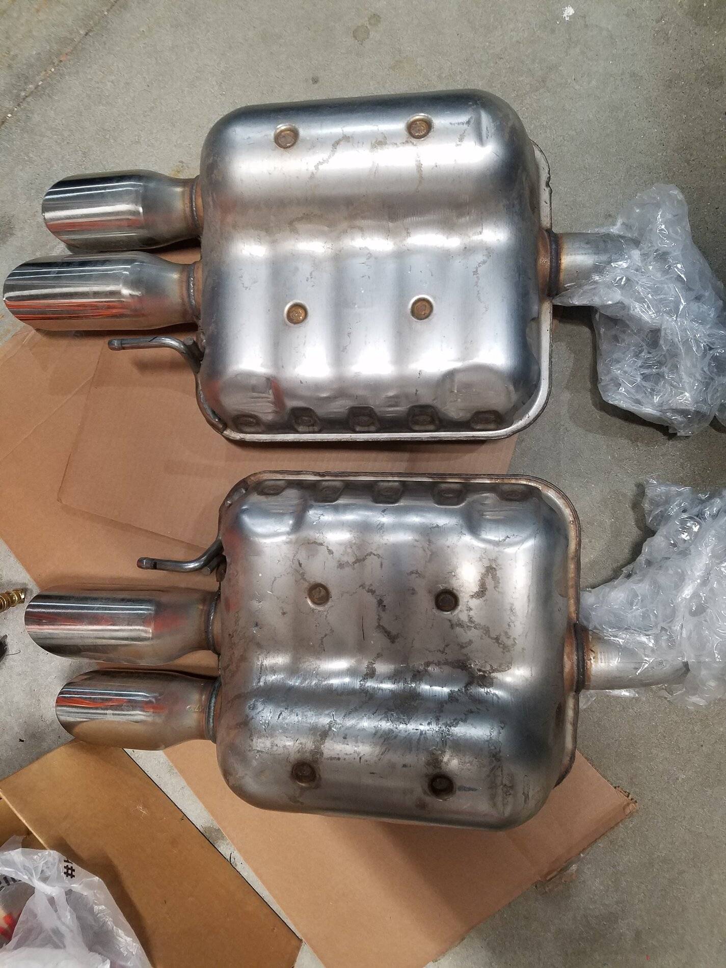

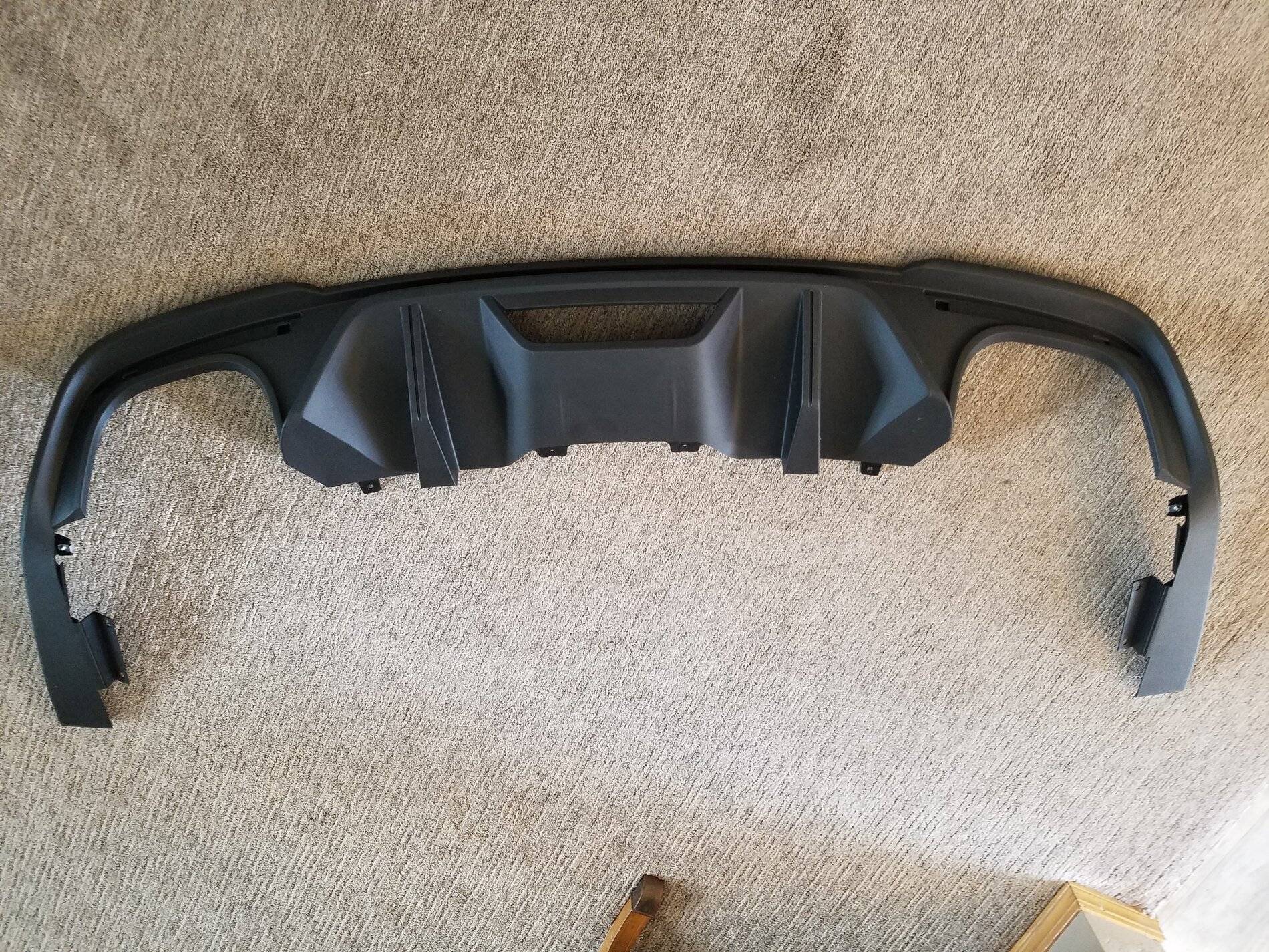

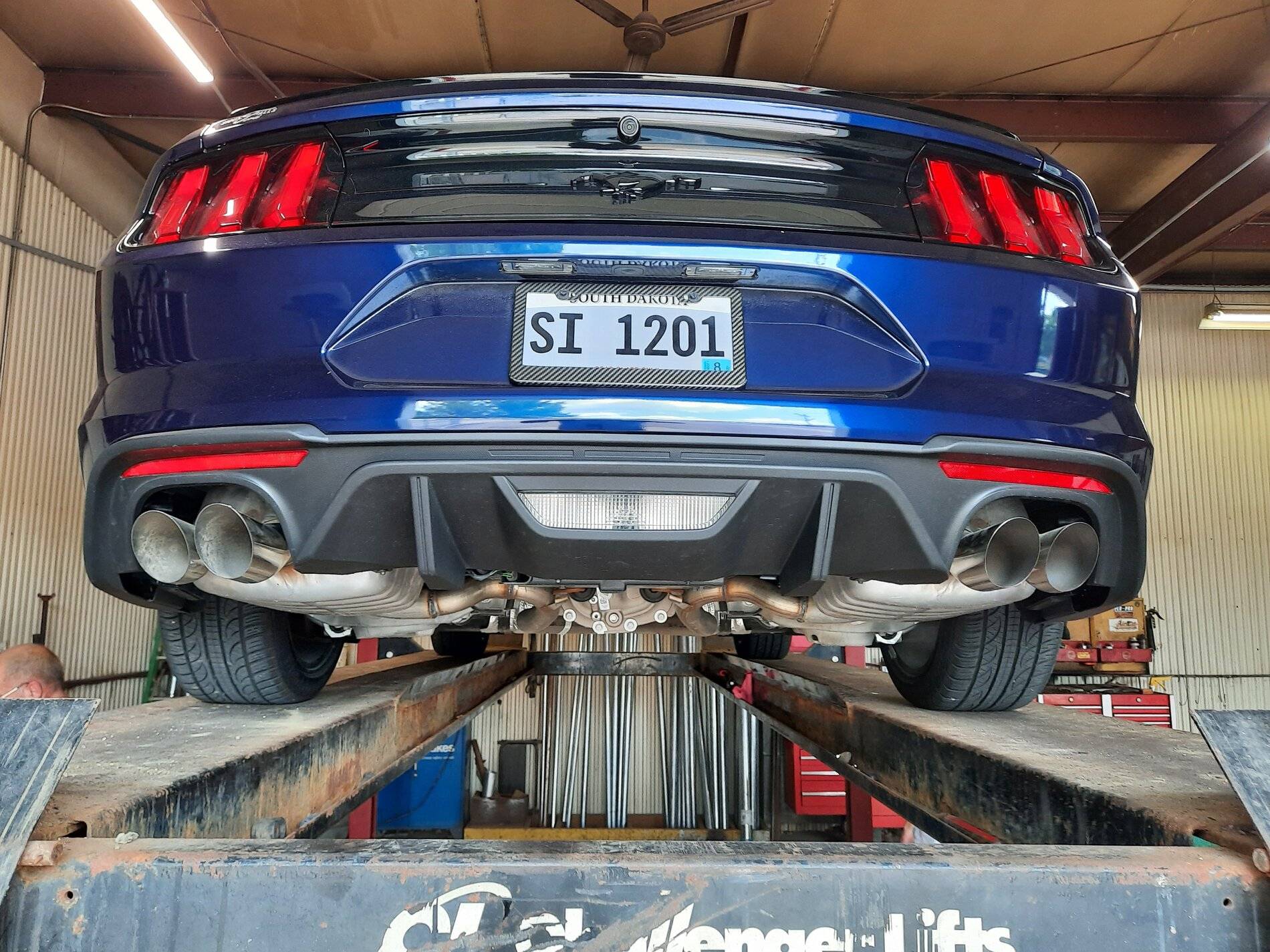

I had some help from another member on here who did it before i did.
The rear diffuser takes about an hour to swap, fairly easy . had an exhaust shop cut the old muffler off, the GT muffler pipe slips right over the eco pipe , weld it and done . Just slightly louder than stock

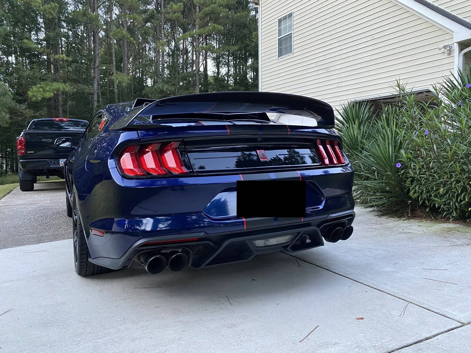

I had a 3” MBRP street cat back on mine before I decided I wanted quads. Kept the Y pipe in place, swapped the valence and bought a Corsa Sport system for a GT and my guy welded it right up. Love this tone.
