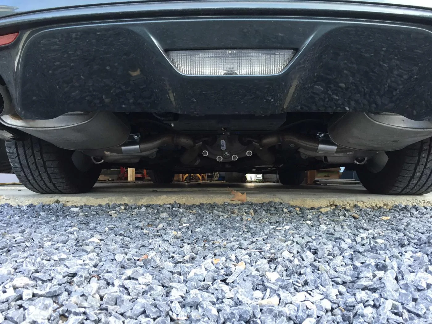

Thanks for the comments! As for your questions!
1. Easily being able to revert back to stock was a major requirement for me so yes it is very easy. I had to separate the OEM mufflers from the center resonator piping so that did require cutting. Basically when/if I want to all I have to do is loosen the band clamps and replace my custom exhaust with the OEM mufflers. I have a picture below to so this. For aftermarket setup's I should be able to install them with no problem. It really depends on where they require the OEM piping to be cut.
2. Everything is 304 stainless steel except for the mufflers which are unfortunately aluminized steel. I guess thats all you can get for $40 a piece! I plan to watch them closely and if I see rust forming I will remove them and seal them with a high temp black paint to prevent future rust.
Picture of OEM mufflers installed.

So there is no factory assembly point right before the mufflers like on an S197 ... did not know this. So I guessing it is one welded piece all the way up to the Catted H-Pipe ??
Your S.S. band clamp solution is basically what the factory does elsewhere, and might be what other aftermarket companies offer for an "axle-back".

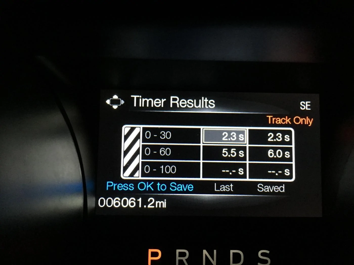

Well I think I might have added some power to my 6 :D:D
6.0 is with OEM mufflers. 5.5 is with my custom exhaust. Around the same conditions for both runs.
From 6.0 to 5.5, this is amazing! I am stumped, have to admit.
As am I! Just imagine what removing the center resonator could do!

Nowhere near enough weight loss to get 0.5 seconds. Nice gains!

Exactly. At max I cut 15-20lbs with my new exhaust. What's even more crazy is that before when I did my 0-60 on OEM mufflers it would chirp the tires on launch with traction control off. Now, tonight when I did my updated run this car fully excitued a burnout with some sideways action before straightening out and chirping into second gear. It is absolutely crazy the apparent gain in power from just a muffler change.
I doubt you saved more than 10 lbs, to be honest. That's all power. Makes me wonder what the delta would be during a 0-100 run...
