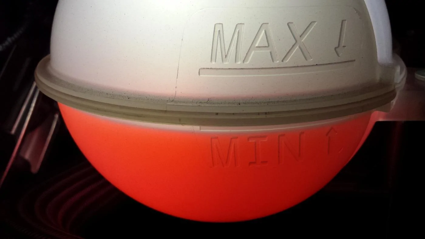

Here is a pic from mine this morning if it helps. Temp was low 40's. Car is a '16 GT with 2k miles on it.

Water evaporates from the coolant all the time, but has no where to go and eventually re condenses unless the pressure got higher than the cap spring, which will then do it's job of venting a little bit to protect the cooling system. If you were driving hard this summer that's where your water went. most cooling systems start venting at like .8 bar. It's only steam too, as the actual antifreeze takes much more temp to boil so it doesn't leave a trace
This is where mine is sitting.

Nothing to worry about here, once the tank over-pressurizes from heat there is a relief at the bottom of the cap towards the engine.
Some steam will come out over a period of time, you wont see it or notice it. Just top it up every few months and you're good to go.
Here is a picture of where the steam escapes from;
2016 EB w/PP -
My coolant level is the same as stangbro posted above. When dead cold before starting the car, the level is right at the middle where the top and bottom part of the molded tank meet, no higher.
