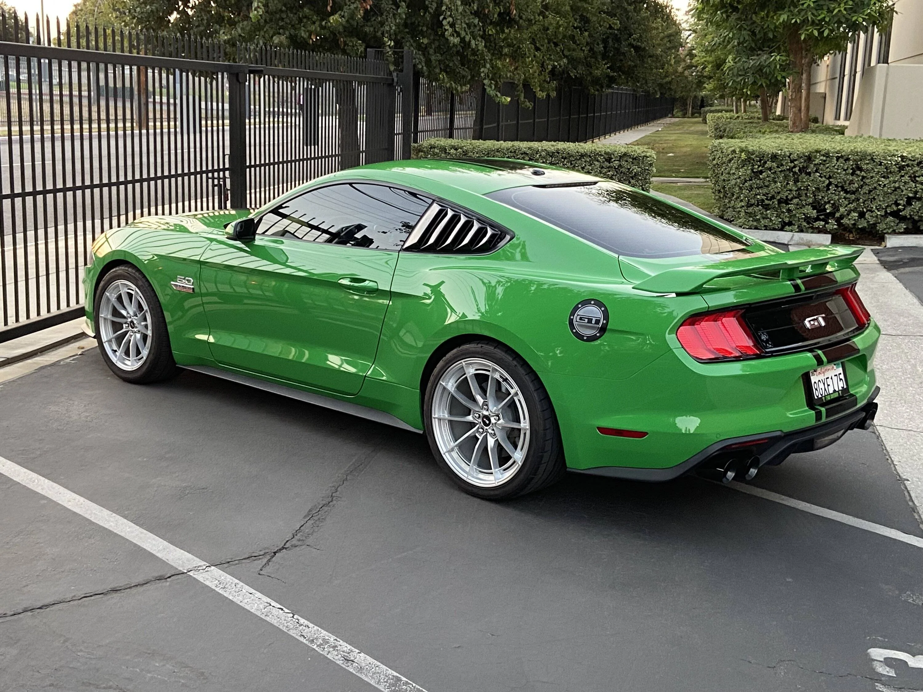

Do you have a pic of this? I've always been curious of what 19/20rear would look like on mustangs. You don't see it and I like how it looks on m2's/3's vettes etc
Not yet picking the car up Friday.Will post when I do.

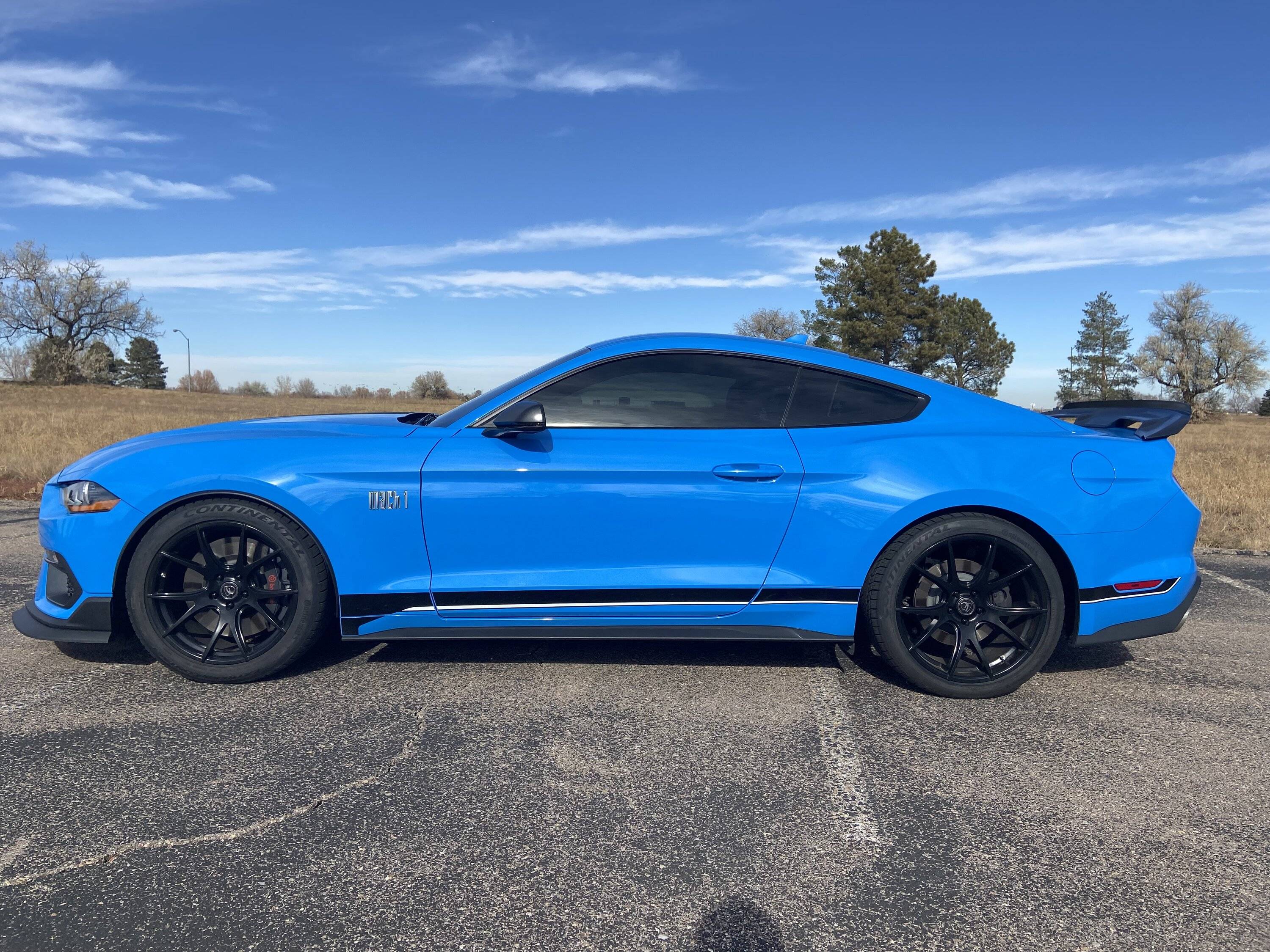

Finally got the car and put the wheels on. Look pretty good and will definitely work as a cold weather set up.
