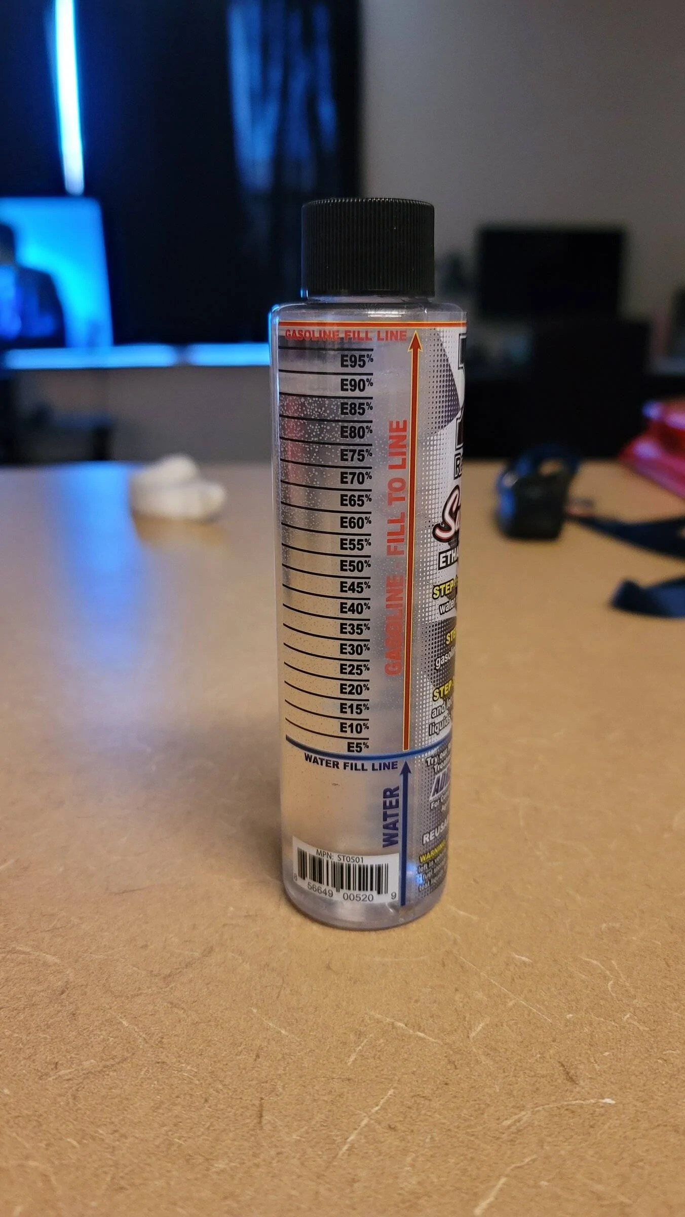

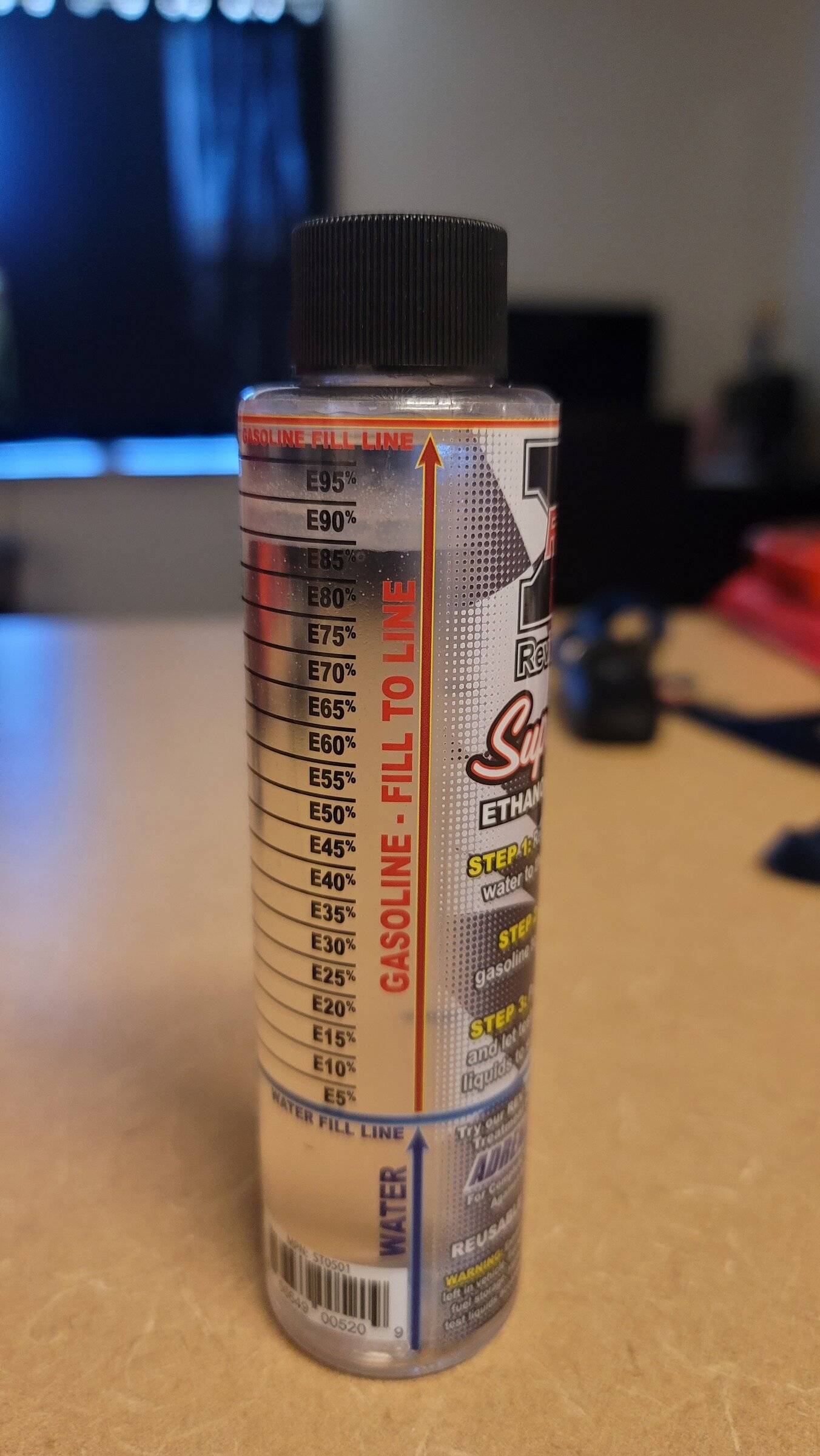

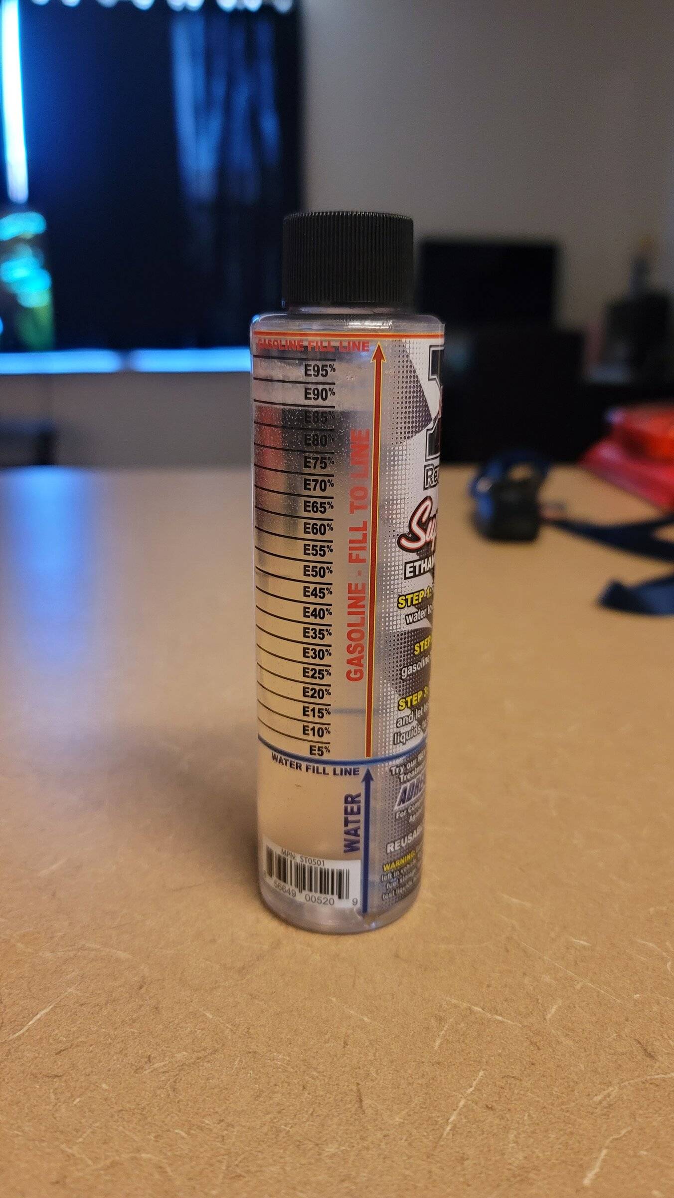

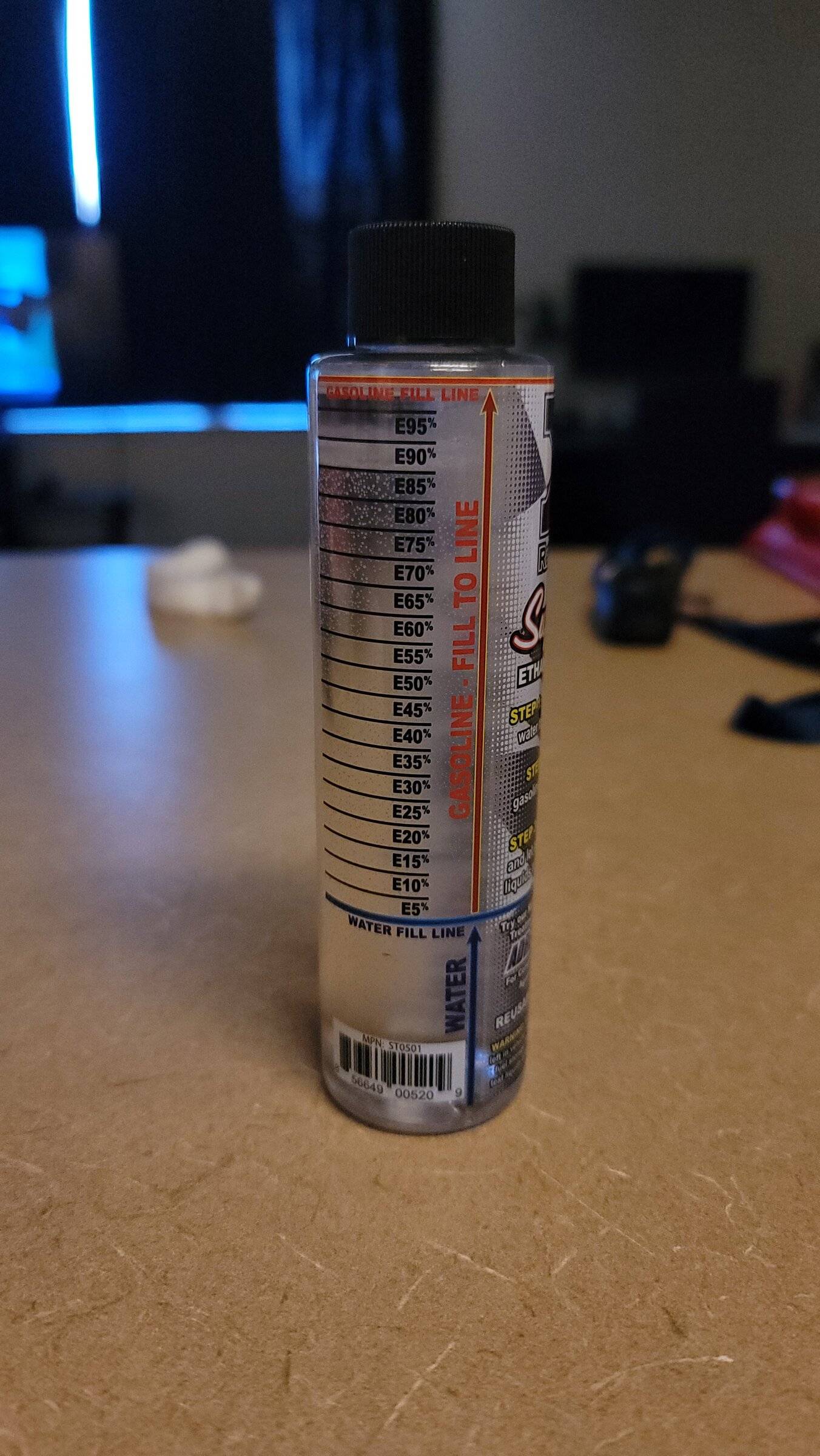

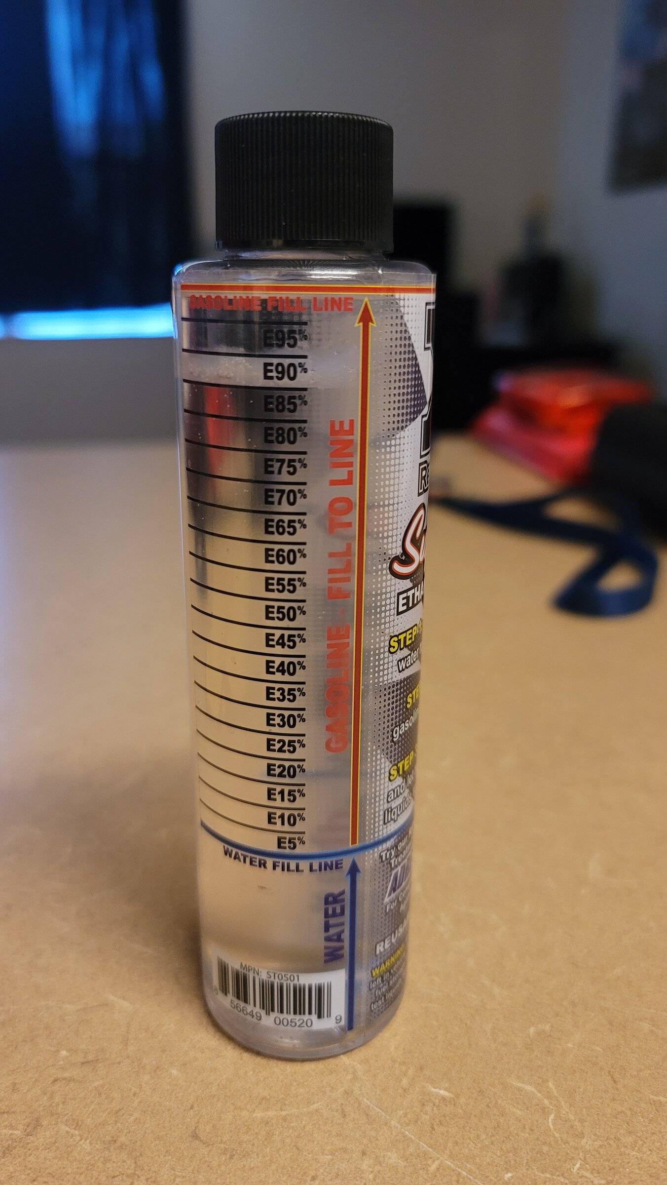

Well it took a while for the test kit to get here but it's here. I made sure to get a new fuel jug so it's straight e85 from the pump. Tested the e from the same station and the results look to be around e83-e85, tested it about 5 times making sure to dispose of the mixture and starting over with every new test. Gonna get this info to bama to see if maybe a tune revision is in order
