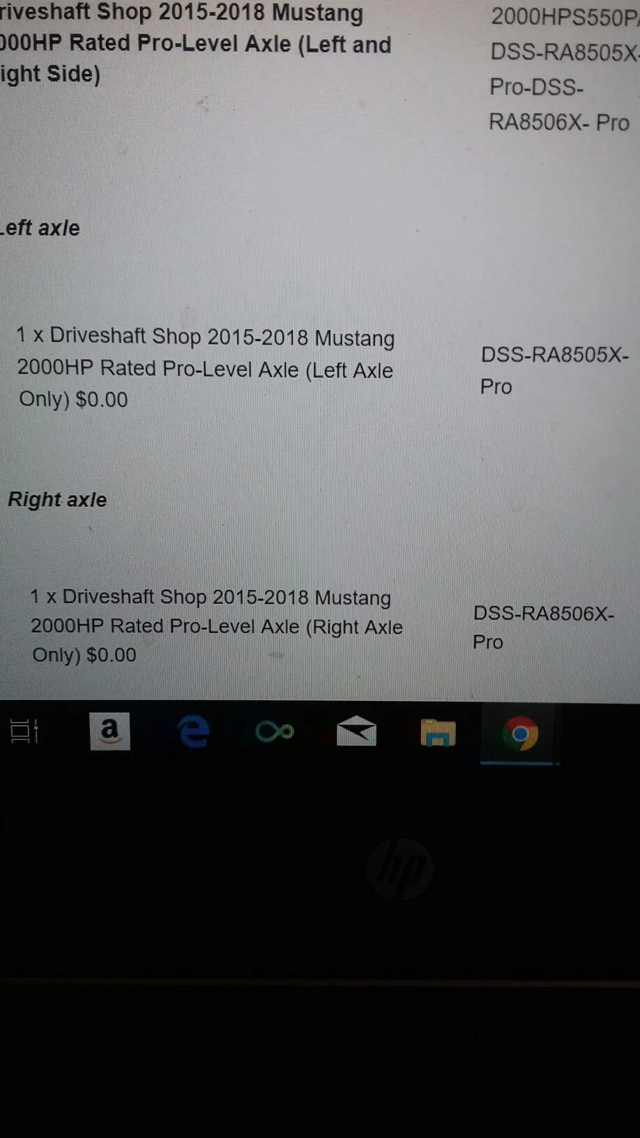

I think where i'm getting confuse is i'm trying to fit the short stub in the side that had the short stub when i think they are the opposite way round.

Im now waiting for DSS to open on Monday to check. This turned out to be a full days work and gained nothing.:headbonk:

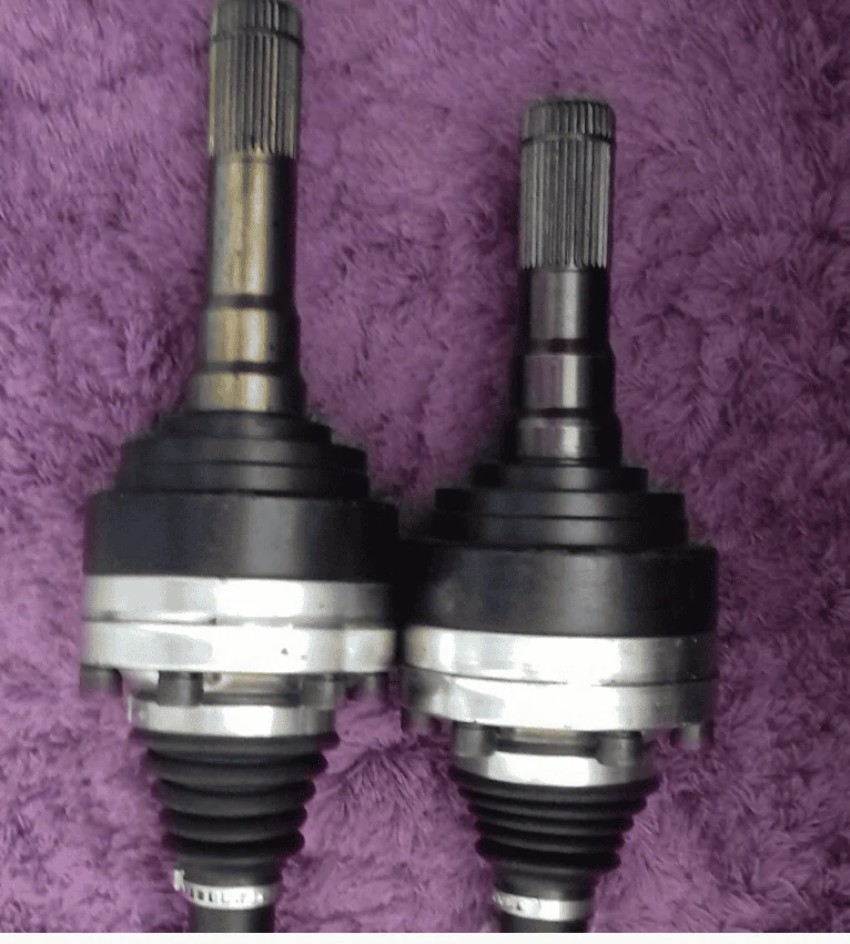

The short stub axle (right-side in your pic below) goes in the right-side of your car (looking from behind your vehicle). Long stub axle = left side. The reason for the long stub is because the ring gear is offset to the left on the differential carrier to engage the center-positioned pinion gear. You have the added thickness of the ring gear that the stub must pass through to engage the spider gears in the middle of the carrier.
Thanks bob if thats the case it won't fit then i need to speak to them.

Well I finally got to the bottom of the problem I need to swap the short and long stubs round the other way.
Torque to 57 lb and loctite them back up.
FYI the long shaft has the short stub and short shaft has the long stub.
