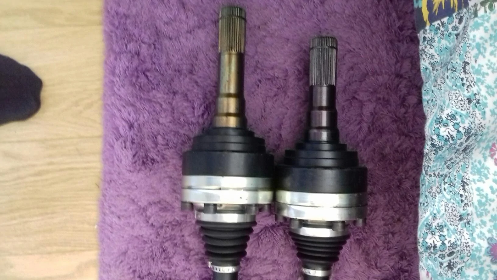

I think where i'm getting confuse is i'm trying to fit the short stub in the side that had the short stub when i think they are the opposite way round.

I am having the same issue today with the same shafts! I got them in but......seams awful tight. The longer stub on the stock axles is the drivers side. That’s how I installed the DSS 2ks. Compressed they are just a hair longer.

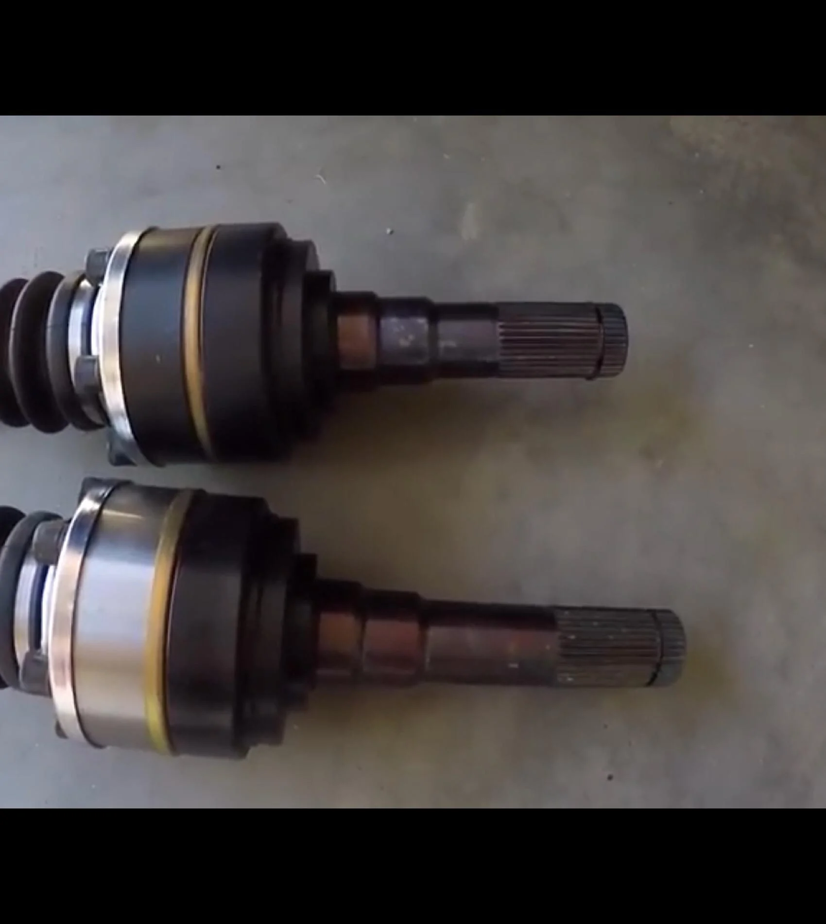

I found a vid on you tube where the guy is installing a set of 800s and the thicker shaft on the 800s go to the opposite side but you can see that the short stub is going where the long stub was.
My part numbers were marked up this way opposite to stock.
Did you try putting them in long stub to your passenger side to see if this was a better fit.
Im now waiting for DSS to open on Monday to check. This turned out to be a full days work and gained nothing.:headbonk:

The short stub axle (right-side in your pic below) goes in the right-side of your car (looking from behind your vehicle). Long stub axle = left side. The reason for the long stub is because the ring gear is offset to the left on the differential carrier to engage the center-positioned pinion gear. You have the added thickness of the ring gear that the stub must pass through to engage the spider gears in the middle of the carrier.
Thanks bob if thats the case it won't fit then i need to speak to them.

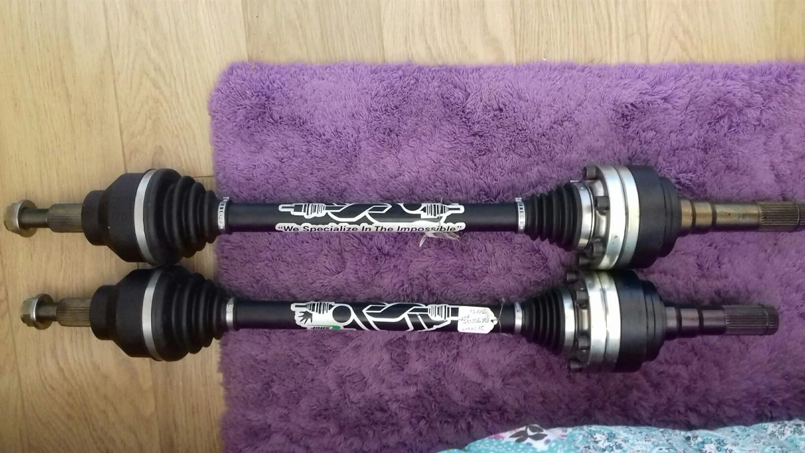

Thanks man, I need to know they are the wrong way round before i do it. Ive had a good look at them but i haven't got any to compare against. I think it would work if I did but I need to speak to them first.

not the first time I have seen this issue. 2 friends have these and they said they were too long and DSS had them take all kinds of measurements

Well I finally got to the bottom of the problem I need to swap the short and long stubs round the other way.
Torque to 57 lb and loctite them back up.
FYI the long shaft has the short stub and short shaft has the long stub.
