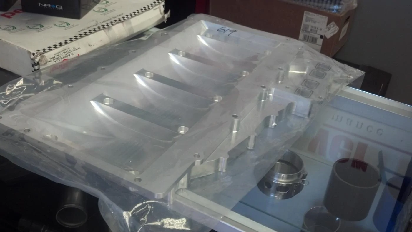

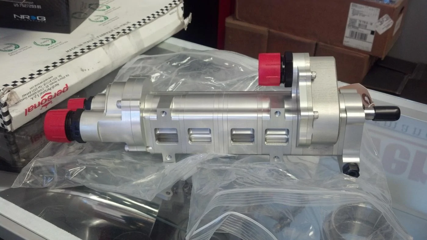

The LS7 in the Z06 and Z28 has what you would describe as a bare minimum type of dry sump oiling system. There is a single scavenge and single pressure pump. The remote oil tank does help prevent starving the pressure pump during high g turns. But most people consider a true high performance dry sump system to have at least 3 scavenge pumps because your sucking a lot of air with the oil when scavenging. Real ones aren't cheap. Here's some pics of the 5 stage system from Daily Engineering I put on my ERL 8.2 liter motor.
My concern is how Ford is going to handle any warrantee issues if you blow your FPC 5.2 while at the track. I am hoping that as long as you're not "racing" as they deem it to be defined, then they will stand behind the warrantee. "Racing" is not only wheel to wheel, but can include any "timed" events too.
