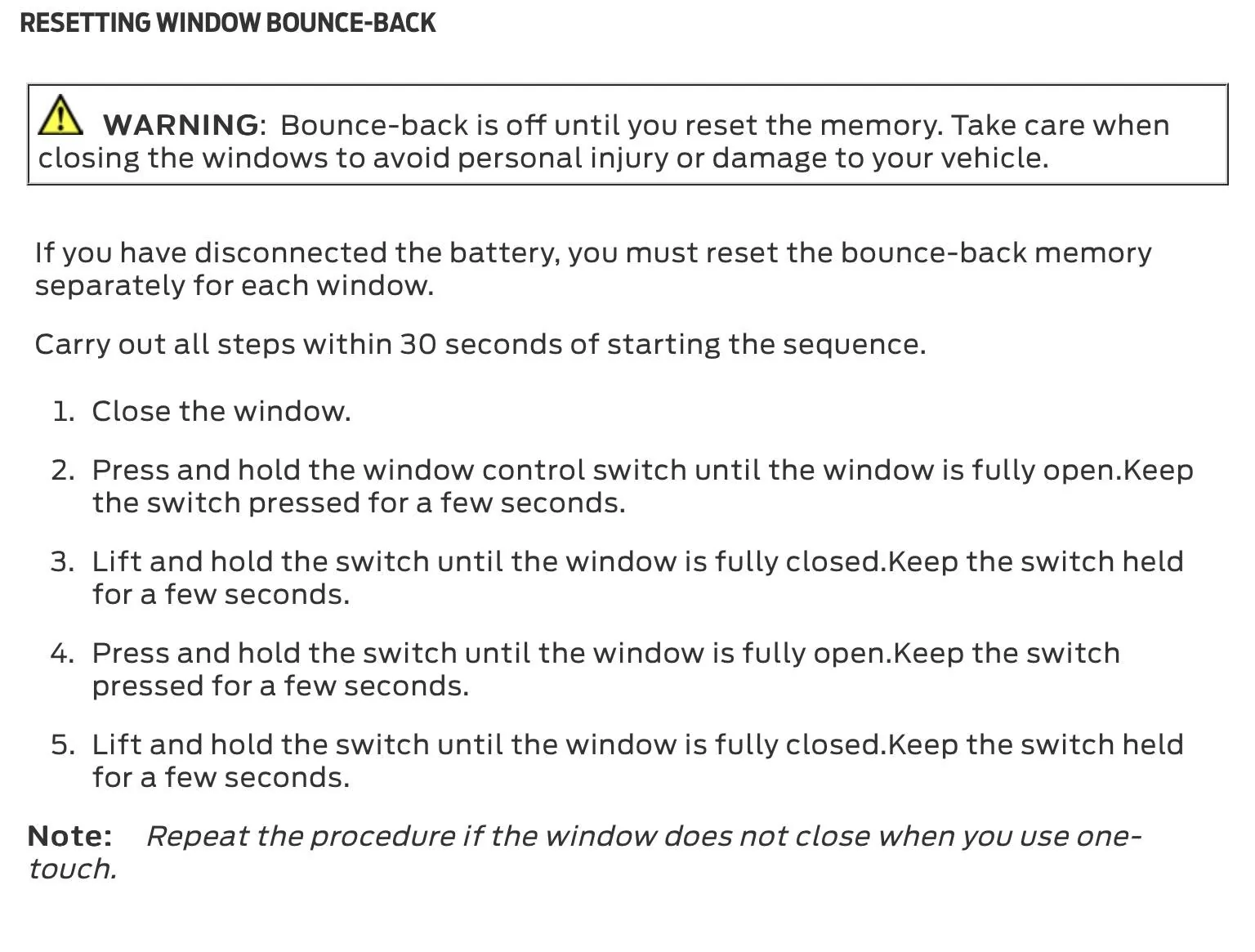

Had a similar issue in my F150….This was the fix, and avoided a trip to the dealer. (Obviously this won’t help if you have moisture in there, or an electrical connection issue, but a quick and easy procedure that may avoid removing door panels.)
