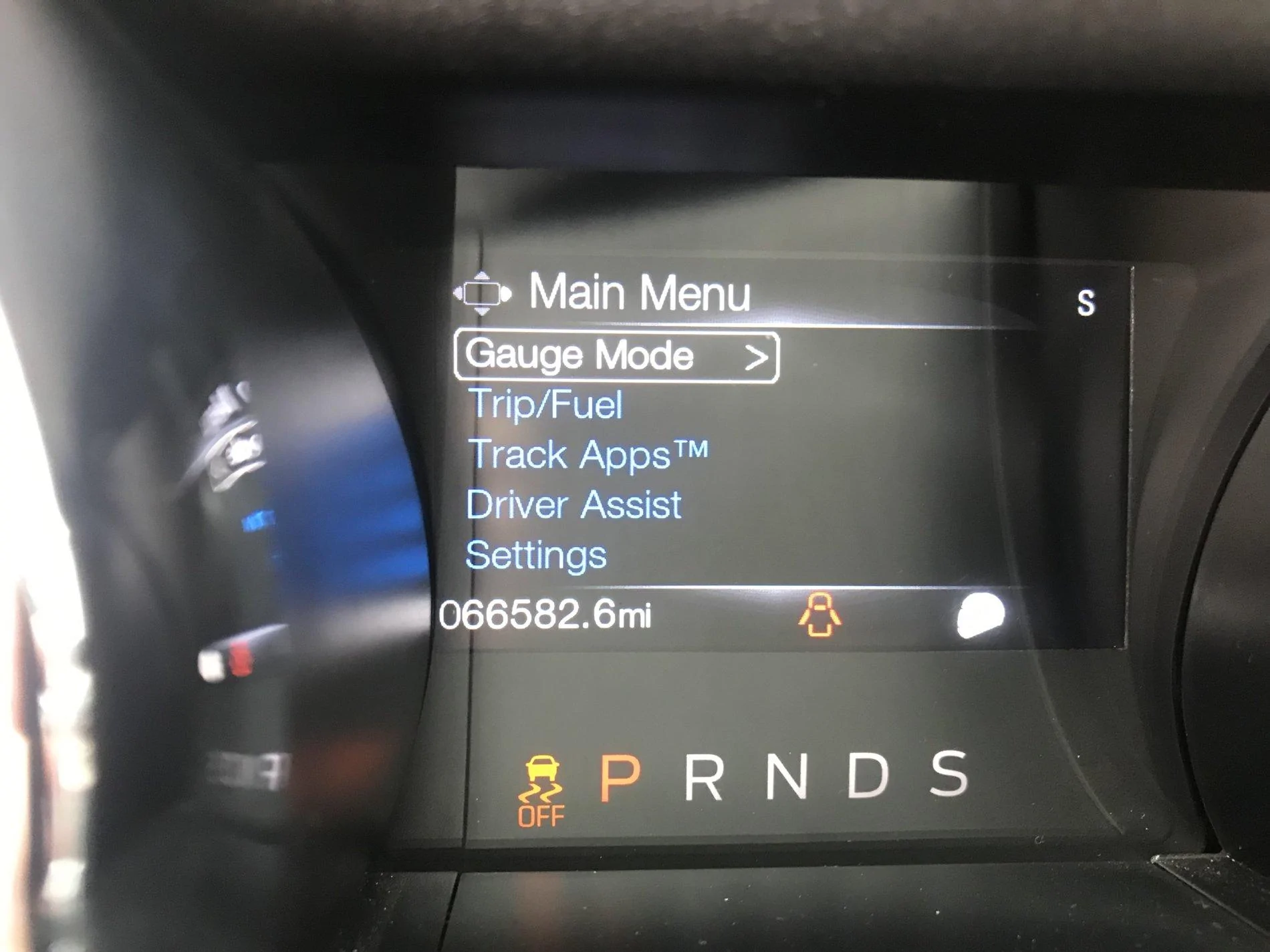

I enabled my driving modes. Everything works perfectly. Just curious, my little helmet and S+ are white while everyone else I have seen is orange. Anyone have any idea why? I’m assuming it’s a setting in the IPC.
Nagare
Feb 1, 2017
58
4,037
2,256
Ft Lauderdale
2017 Lightning Blue V6
My helmet is white as well, the traction control and gear indicators are orange.

All of my cluster symbols related to the Drive Mode, Steering, or Traction Control settings are orange/yellow. I wonder if it’s a firmware difference.
fiveliter
Jan 23, 2019
New York
Sean
2015 Mustang Ecoboost, 2003 Mustang Mach 1
Mine was orange at one point, but I’ve made several changes to the IPC. I didn’t realize the color change until today. Not sure which block changed the color. I’ve seen other people on YouTube with blue.
