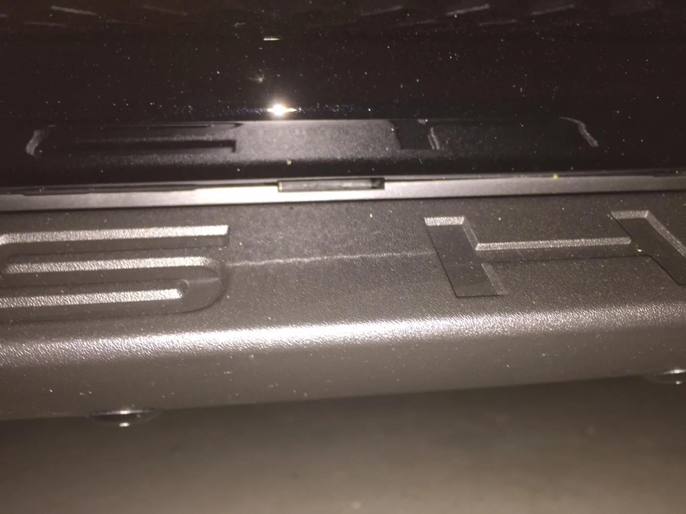

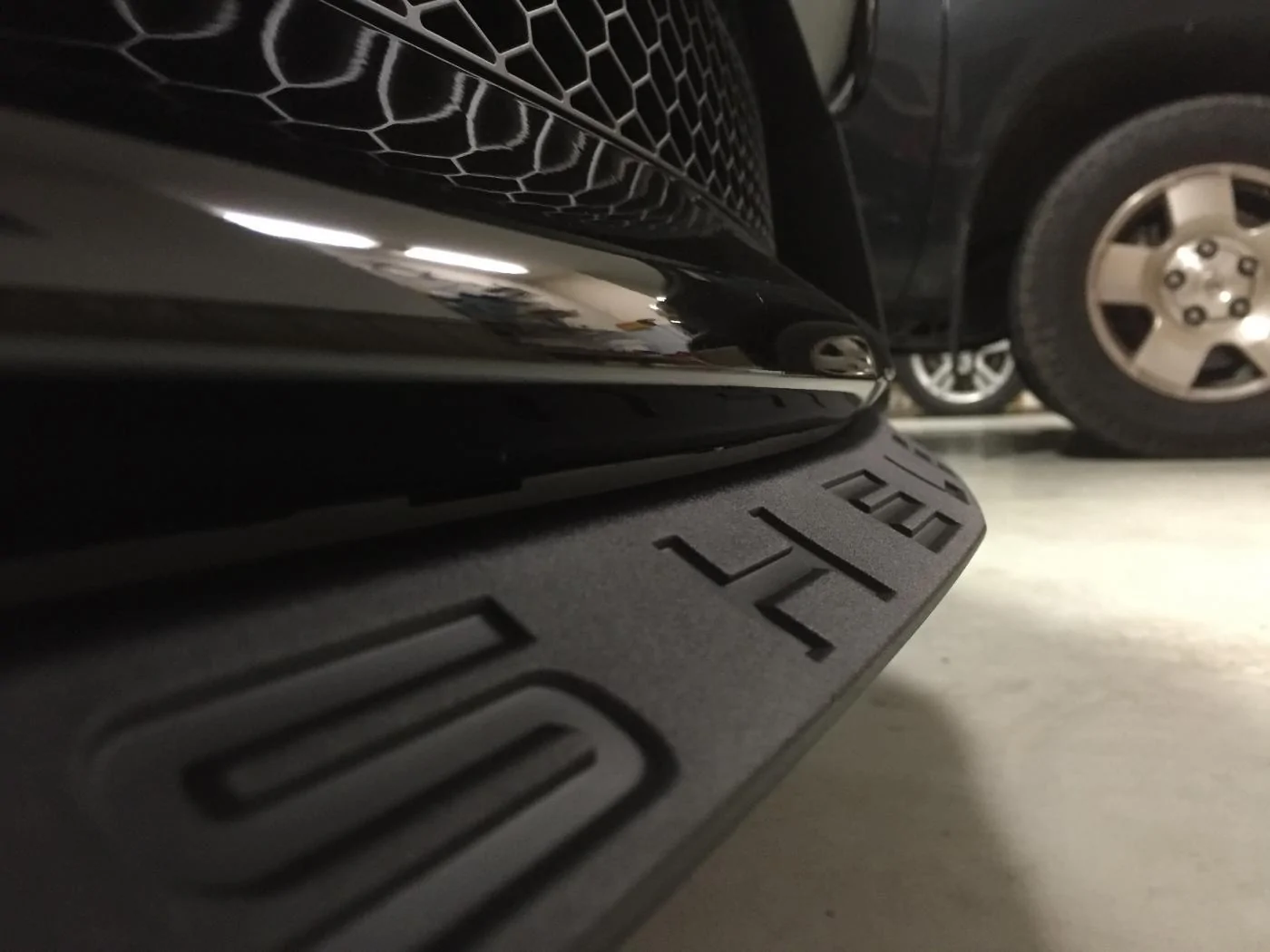

On another note, can someone take a close up picture of the top their splitter where it goes in to the tabs on the facia? I have a slight gap there and want to make sure the dealer installed it correctly. Thanks.

Congrats Steve on getting another car. Here's a close up. Nothing is loose without the splitter installed you will be fine.

Thank you! I think that is pretty much what mine looks like. About a 1/4" gap between the bottom lip of the bumper cover and the top of the splitter. If you look in the notches on the top of the splitter (e.g. the one between the "S" and "H" in your photo) can you see the screws that come up at a 45 degree angle?

I don't see those screws at all. The gap is actually pretty tight. I installed mine and those screws were tough to get aligned but would have been easier with a lift.

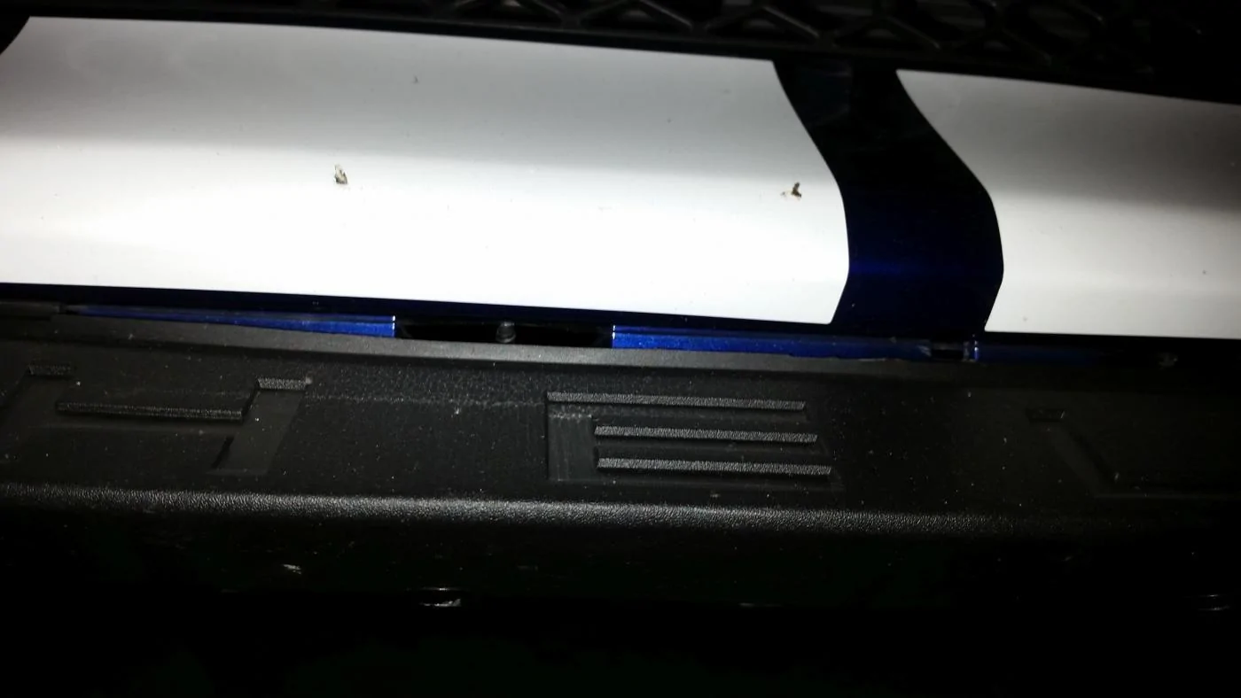

Can you snap a picture of the gap between the splitter and the facia between the 'H' and the 'E'? I think mine IS installed incorrectly or they overtightened the screws. Also, can you snap a pic of the head(s) of the screws that hold the splitter to the belly pan towards the rear of the car? I'm starting to suspect that they didn't use the screws that came with the splitter. Thanks in advance. :)

Yeah, that video shows all the fasteners as hex head screws. Mine also has the torx screws towards the belly pan. On the angled fasteners at 45 degrees, up through the access holes towards the front, they either used the wrong fasteners or over-torqed them.

They definately did not engage the center section properly. That gap should not be there.

Yeah, between the stripes you can see a quarter inch slot, and there's a tab on the splitter that should be seated in that slot and it's not. I'm going to take it by the dealer and have them look at it.
