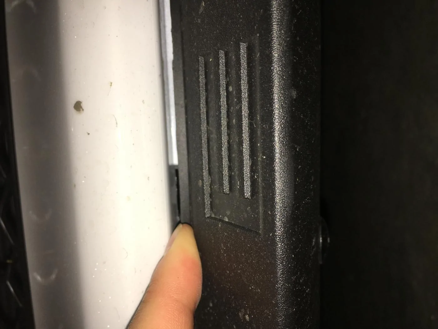

My splitter was incorrectly installed when the car was delivered to me. It was very hard to see, but thanks to this forum I saw the issue.
To be fair the splitter itself was very securely mounted, and I didn't think it would come loose and this car will never see a track or very high speeds anyway.
Fast forward 1000miles of driving - the splitter loosened itself almost 1/2"! I was very surprised and took it back for warranty. I was helped by the manager and shop foreman and they took care of me. No issues on that front.
Here's a reference picture after 1000 miles
Sorry pic is sideways. The gap was almost my whole index finger.
Mine looks the same but like you said, very secure.
